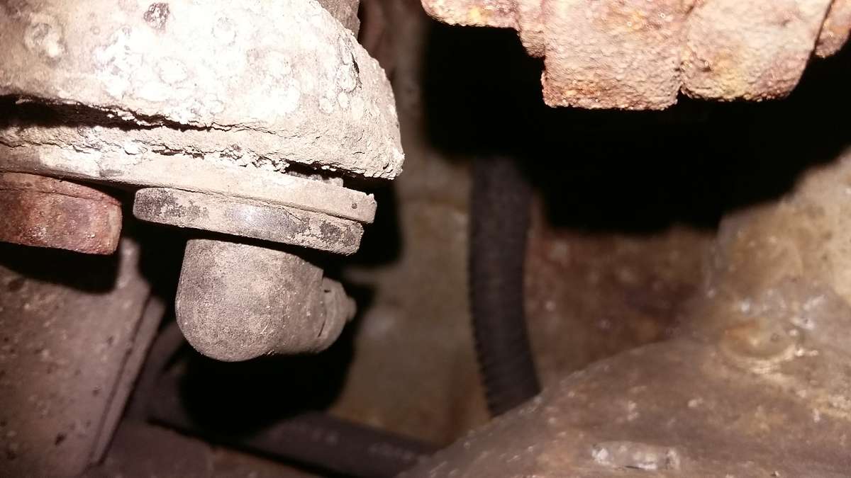

Woodzman Posted October 24, 2019 Share Posted October 24, 2019 Not sure if this will help, but I had similar issues earlier this year. ABS and TCS lights would come on, seemingly fairly randomly, but with increasing frequency. So I bought a code reader (an Ancel AD610) and low and behold two codes popped up C1109 Battery voltage and C1106 RR LH Sensor-2). So similar symptoms albeit a different problem. Turns out that corrosion in the mounting hole for the ABS sensor on the alloy diff housing had pushed the sensor away from its activation ring, presumably causing a weaker signal and ultimately a code to pop up, lighting up the dash. Photos may show this: Sensor gap before: Corrosion on other side (mounting bolt for sensor on immediate left) Gap when taken out, cleaned, copper greased and re-fitted: Not sure if this helps but might be something else to check, which is fairly easy once the back of the car is jacked up. Alternatively it might be useful for anyone else looking to track down similar issues? 1 1 Quote Link to comment Share on other sites More sharing options...
Bockaaarck Posted October 25, 2019 Author Share Posted October 25, 2019 Woodzman, that is excellent info, especially the pics. Thanks, that’s very much appreciated. Having read through loads of info, read a load of stuff, tried a load of things. It’s really useful to have more input and detail. Car is booked in to have a look at exactly those bits n bobs, on Monday. Fingers crossed they’ll find it’s one of these sensors or something to do with the ring. Probably sounds a bit weird, but it’s actually been quite good fun. Looking in to potential issues / causes, and ticking them off. Quote Link to comment Share on other sites More sharing options...
