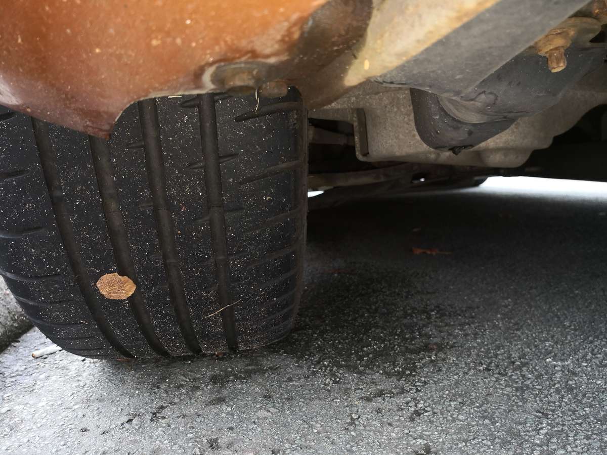

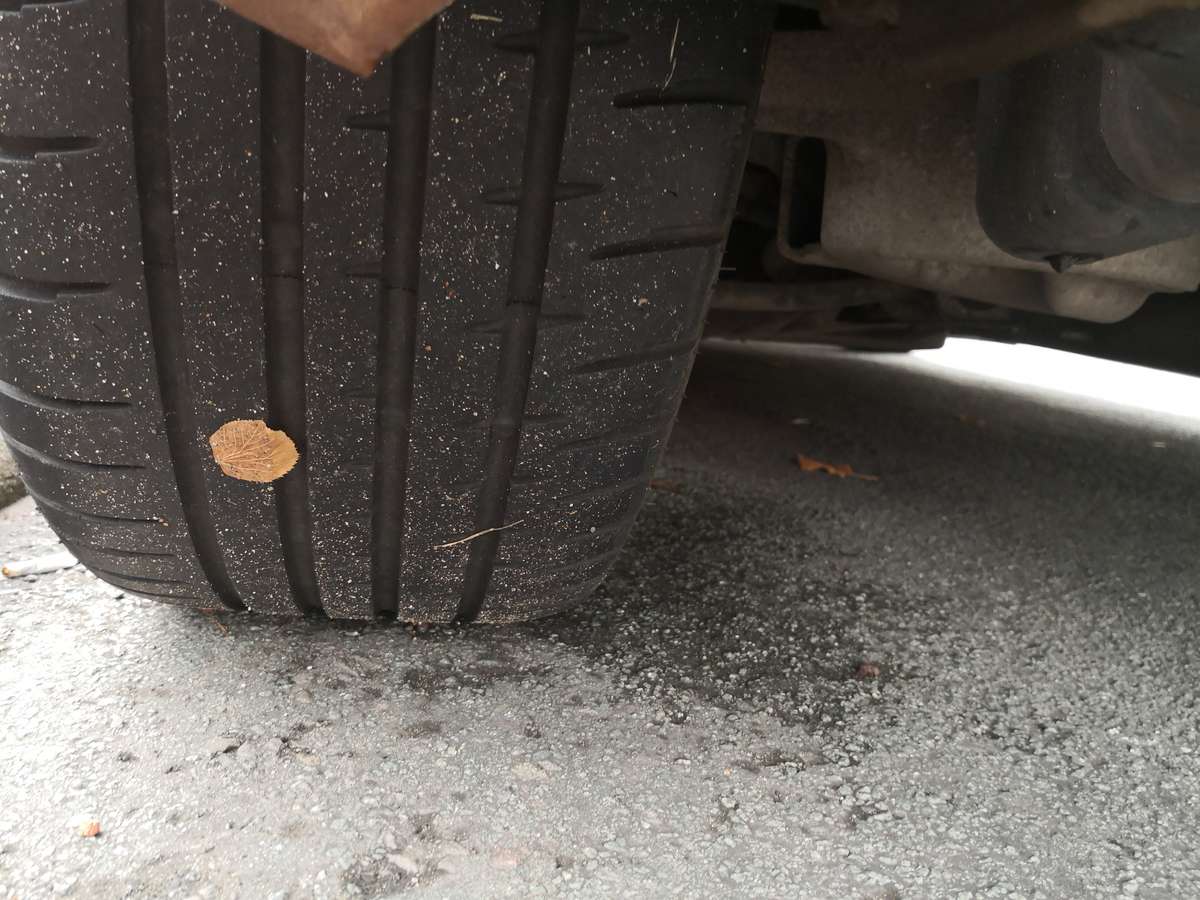

EcoFriendlyAL Posted September 22, 2019 Author Share Posted September 22, 2019 Cheers Andy. I'll try it on an empty car park some time. So traction control and ESP are different things? Here pics of my rear tyre, they don't look very good treads to me, are they track day ones? Cheers AL Quote Link to comment Share on other sites More sharing options...
Bullet Posted September 22, 2019 Share Posted September 22, 2019 It'll be those tyres, http://www.tyrereviews.co.uk/Tyre/Accelera/PHI-R.htm 1 Quote Link to comment Share on other sites More sharing options...
ZMANALEX Posted September 22, 2019 Share Posted September 22, 2019 COLD cheap tyres in wet/slippy conditions with heavy right foot = back end out. 1 Quote Link to comment Share on other sites More sharing options...
EcoFriendlyAL Posted September 22, 2019 Author Share Posted September 22, 2019 Hi Bullet and Zmanalex, I had no idea they were crap tyres, They were on when I bought the car 3 years ago. Yes they would be well cold as I'de not long started off. Time to get some Pirelli P6000 I reckon? Cheers Guys AL Quote Link to comment Share on other sites More sharing options...
