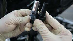

daveo132 Posted September 21, 2019 Share Posted September 21, 2019 (edited) Hi all, This code came up on the car today: P1078 Exhaust Valve Timing Control Position Sensor Bank 1 Circuit Done all the usual ECU clears etc and it keeps coming back. I've not found that much info but am i right in thinking that this is the Drivers side Cam Sensor? Edited September 21, 2019 by daveo132 Quote Link to comment Share on other sites More sharing options...

ZMANALEX Posted September 21, 2019 Share Posted September 21, 2019 Yes, Bank one is the driver's side on a RHD car. Make sure that the sensor that you fit is the upgraded cylindrical metal type and not the old style plastic type. Quote Link to comment Share on other sites More sharing options...
daveo132 Posted September 21, 2019 Author Share Posted September 21, 2019 (edited) 21 minutes ago, ZMANALEX said: Yes, Bank one is the driver's side on a RHD car. Make sure that the sensor that you fit is the upgraded cylindrical metal type and not the old style plastic type. Oh thanks! I'll keep an eye on that. I have a feeling that it might be plastic though. What price do you have them for? PM? I might cancel the order with GSF as i'm not 100% sure I'm going to get the right one, the website wasn't very clear in hindsight. If it helps, mine is an 07 plate. Edited September 21, 2019 by daveo132 Quote Link to comment Share on other sites More sharing options...

daveo132 Posted September 28, 2019 Author Share Posted September 28, 2019 Changed the sensor and now the car won't start? Get a too rich error now. Any thoughts? Quote Link to comment Share on other sites More sharing options...
daveo132 Posted September 28, 2019 Author Share Posted September 28, 2019 (edited) Nevermind! Turns out it wasn't seated correctly. Embarrassed lol but this might help someone else Edited September 28, 2019 by daveo132 Quote Link to comment Share on other sites More sharing options...
daveo132 Posted September 28, 2019 Author Share Posted September 28, 2019 Nah, tired several times now but it seems this is a DOA. Can drive the car about 100m before it just dies. After that I won't idle, just keeps dying. Quote Link to comment Share on other sites More sharing options...

daveo132 Posted September 28, 2019 Author Share Posted September 28, 2019 I've got it home, just going to get a Sensor from Zman. Seems this one from GSF is a paperweight Quote Link to comment Share on other sites More sharing options...
