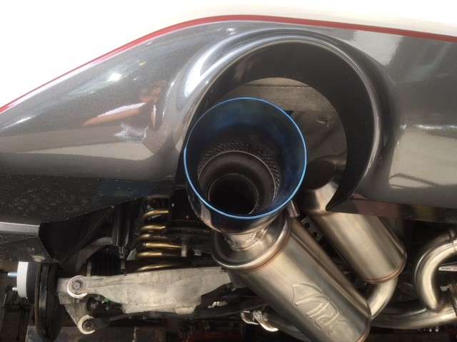

sipar69 Posted September 8, 2019 Share Posted September 8, 2019 I have an Ark Grip. It’s quieter than short tails but a very good sound. It also looks the business. However, be aware that a small proportion of owners have fitting issues with this exhaust. I had to pay a local fabricator to have mine shortened on one side because one tip was sticking out significantly more than the other. No amount of adjustment would sort the issue so it was case of remove one tip, shorten and weld back on. 1 Quote Link to comment Share on other sites More sharing options...

Payco Posted September 11, 2019 Share Posted September 11, 2019 (edited) On 08/09/2019 at 06:44, sipar69 said: I have an Ark Grip. It’s quieter than short tails but a very good sound. It also looks the business. However, be aware that a small proportion of owners have fitting issues with this exhaust. I had to pay a local fabricator to have mine shortened on one side because one tip was sticking out significantly more than the other. No amount of adjustment would sort the issue so it was case of remove one tip, shorten and weld back on. 100% agree. Was told by Tarmac that my Ark would fit my Nismo and it didn't. Had one on my 350z no issue but it doesn't fit the Nismo 370z. The pipes did not clear the rear diff so we had to cut, weld an extension to get it past the diff. We checked every way but it didn't fit. My mate has a garage and has worked on Jap cars as a specialist for years and has fitted 100's of exhausts systems and believe me it didn't fit without fabrication. That being said it's worth it. By far the best system I have heard and looks great. Edited September 11, 2019 by Payco Quote Link to comment Share on other sites More sharing options...
sipar69 Posted September 11, 2019 Share Posted September 11, 2019 7 hours ago, Payco said: 100% agree. Was told by Tarmac that my Ark would fit my Nismo and it didn't. Had one on my 350z no issue but it doesn't fit the Nismo 370z. The pipes did not clear the rear diff so we had to cut, weld an extension to get it past the diff. We checked every way but it didn't fit. My mate has a garage and has worked on Jap cars as a specialist for years and has fitted 100's of exhausts systems and believe me it didn't fit without fabrication. That being said it's worth it. By far the best system I have heard and looks great. Yep I’m happy with mine now but it was s bit disappointing to have to shell out an extra £100 quid to get it to look right. I’m too OCD to have misaligned tips 1 Quote Link to comment Share on other sites More sharing options...

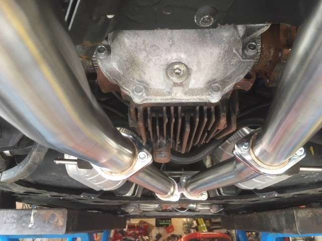

Adrian@TORQEN Posted September 11, 2019 Share Posted September 11, 2019 I still think the mid pipes were swapped, I remember Taras @ RTP having the same problem trying to fit one for our customer. Swapped the pipes correctly and all aligned perfectly fine. Ark only does one version for the 370z, see here: https://arkperformance.com/index.php?route=product/product&product_id=2&search=370z I will however email them to confirm if they do a new version with "Nismo fitment". Quote Link to comment Share on other sites More sharing options...
Adrian@TORQEN Posted September 11, 2019 Share Posted September 11, 2019 Reply from ARK Performance:Hi Adrian, Our 370z GRiP Exhaust does not fit the Convertible and Nismo Model. The GRiP exhaust interferes with some brace bars near the differential in the rear. If you check our website when you click on the specification tab we list it not fitting the Convertible and Nismo model. For the Nismo model our DT-S Exhaust will fit. This is the DTS he's referring to:https://arkperformance.com/index.php?route=product/product&product_id=3&search=370z Quote Link to comment Share on other sites More sharing options...

mattross1313 Posted September 12, 2019 Share Posted September 12, 2019 Looking at the reply from ARk, via Adrian above, I can somewhat agree with their statement about the rear brace bars. I purchased a used Ark exhaust from a chap who had it fitted to a GT model....and I was fitting it to my Nismo. When it was all fitted up correctly the rear pipes were close to some of the rear bracing bars on the Nismo, but they did not touch once the system was all tightened up. Perhaps they are just saying this to add some protection should any rubbing occur? I ran it on my car for over 1 year with no issues. The only comment I would make with fitting it to a Nismo Vs a GT is that the tail pipes do not sit flush with the bumper. They sit a little more underneath the car, which I can only assume is due to the Nismo rear bumper being bigger/deeper? But never bothered me. In terms of the tailpipes not being lined up, or interfering with the diff on the Nismo - this is due to the mid pipes being fitted on the wrong side. Keyser and I fitted the Ark grip to my Nismo and on first fitment my car looked exactly like the photos from Payco. After some head scratching we swapped the 2 pipes over, tightened up the system, and boom! Perfect fitment (with the exception of the tail pipes sitting a little under the bumper as mentioned). 1 Quote Link to comment Share on other sites More sharing options...
Adrian@TORQEN Posted September 12, 2019 Share Posted September 12, 2019 1 minute ago, mattross1313 said: In terms of the tailpipes not being lined up, or interfering with the diff on the Nismo - this is due to the mid pipes being fitted on the wrong side. Keyser and I fitted the Ark grip to my Nismo and on first fitment my car looked exactly like the photos from Payco. After some head scratching we swapped the 2 pipes over, tightened up the system, and boom! Perfect fitment (with the exception of the tail pipes sitting a little under the bumper as mentioned). Thanks for confirming Matt on the mid pipes. 1 Quote Link to comment Share on other sites More sharing options...

sipar69 Posted September 12, 2019 Share Posted September 12, 2019 Ditto mine. It was definitely fitted correctly. I always do my research and was aware the pipes can easily be fitted the wrong way around. The problem with my mine was that because the issue was not lateral misalignment no amount of adjustment made a difference. One tip pretty much lined up with the edge of the bumper and poking out about an inch and a half. Fabrication was the only option, which was disappointing for one of the more pricey systems. 1 Quote Link to comment Share on other sites More sharing options...
