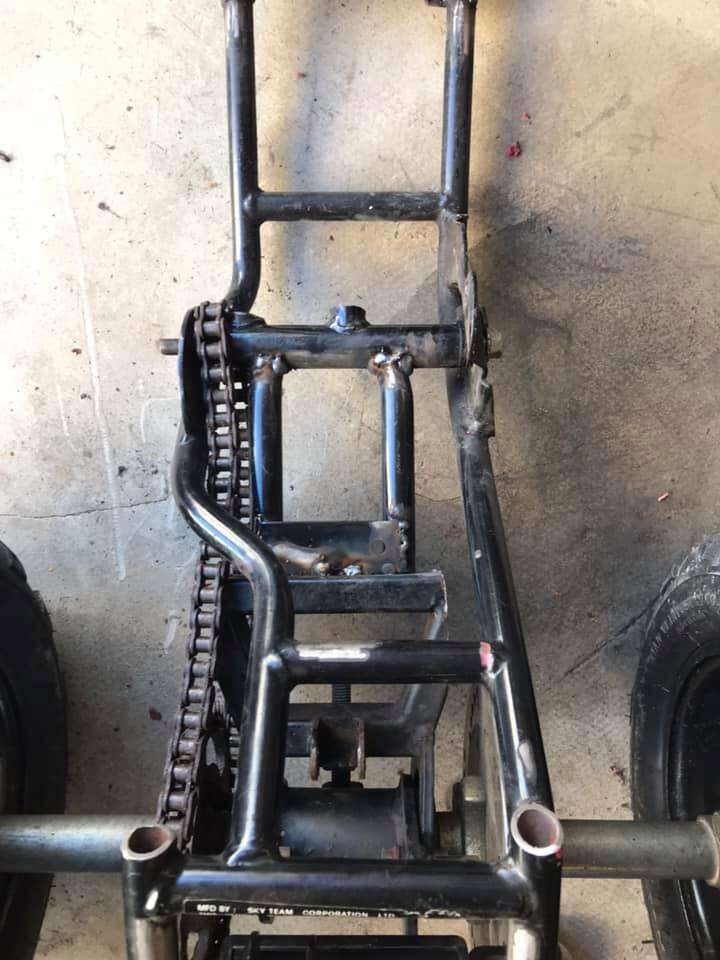

evilscorp Posted May 27, 2020 Author Share Posted May 27, 2020 extended the rear arm to try and get the chain not to hit anything and for the wheels to be in the right location of the body (most pictures are missing the final welds and only tacked in). 1 Quote Link to comment Share on other sites More sharing options...
evilscorp Posted May 27, 2020 Author Share Posted May 27, 2020 Tried a test gravity run down a hill, brake works and locks the rear but the steering is awful. Track width was too close so wanted to tip. Had to cut and mount the suspension arms further out, also lowers the car which makes it look cooler lol. (however I will need to getto chop the spring in the rear to lower it.) 1 Quote Link to comment Share on other sites More sharing options...
