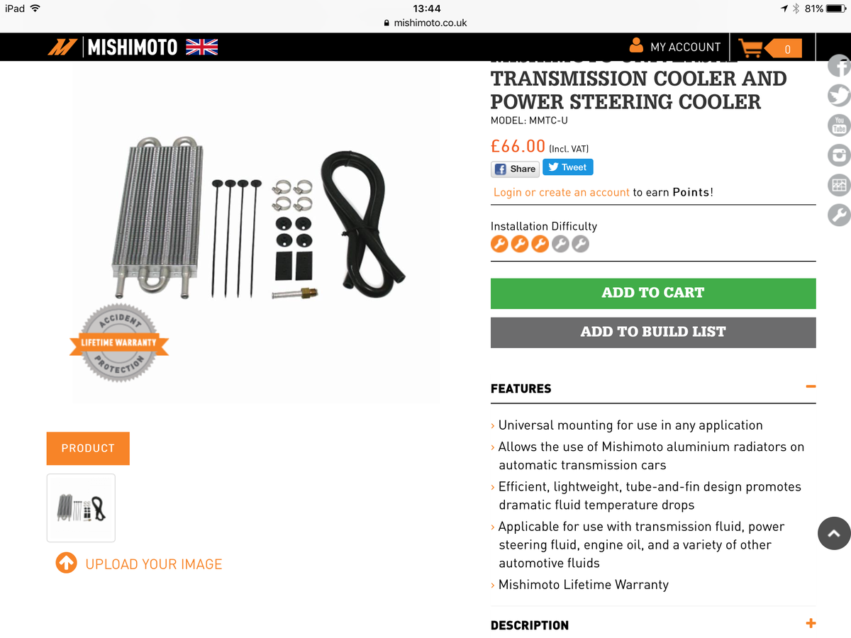

z350convert Posted July 25, 2019 Author Share Posted July 25, 2019 This might fit the bill,... Quote Link to comment Share on other sites More sharing options...
