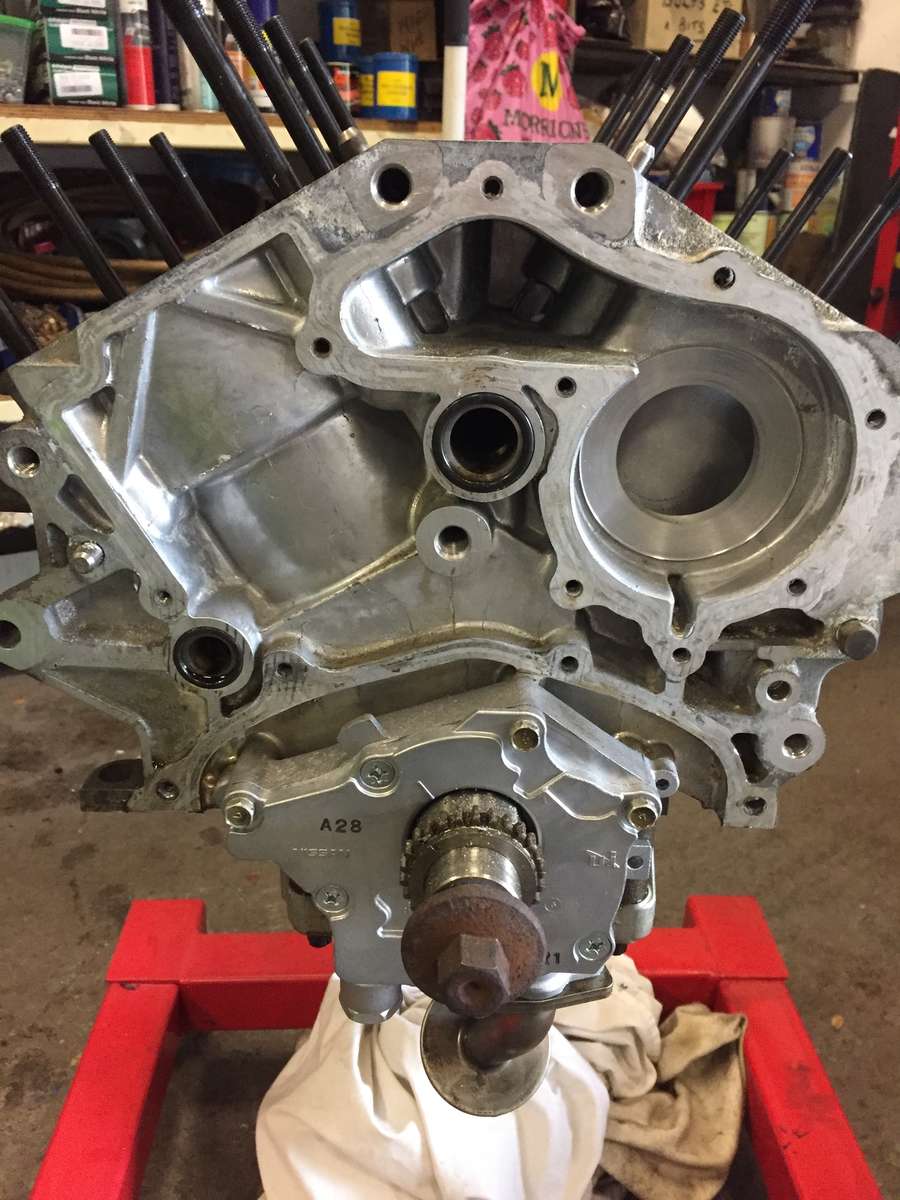

I have had the car nearly 2 years... I bought it crashed (undeclared) for peanuts.
i have had the body jigged and have replaced all the damaged parts with new, subframe, n/s/f suspension crash bar etc etc then I removed the engine to rebuild it and have finally gotten round to fitting the sump!
The reason I have rebuilt the engine is because I plan to Supercharge it so I have fitted...
JE Pistons 10:1
manley con rods h beam
king race con rod bearings
king race main bearings
arp rod bolts
arp mainbolts
arp head stud kit
genuine timing chain kit
350z Genuine Rev up oil pump
JWT oil pan spacer
cometic head gaskets
All other gaskets replaced with genuine
LUK dual mass flywheel
exedy clutch kit
just waiting to purchase exhaust manifolds then we can drop the engine back in, I plan to run it in as N/A on the standard ECU then come winter fit a supercharger kit and get a stand-alone ECU.
it also needs a full respray once it’s running...
any thoughts or suggestions are welcomed
