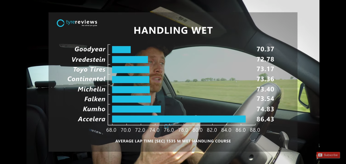

davey_83 Posted July 9, 2019 Author Share Posted July 9, 2019 (edited) Poorly presented stats or not the budget tyre performance is awful and clearly bottom both on paper and subjective feel. When the top manufacturers are all within shades of each other and a cheap tyre is stone last every time then the numbers speak for themselves. The Chinese tyres performance isn't defendable. It's not even as if it placed second to last once, not once. It's was thrown in purely to present where not to spend ones money. Great to see Goodyear smash Michelin and Continental in the wet handling mind. 265 35 R19 Edited July 10, 2019 by davey_83 Quote Link to comment Share on other sites More sharing options...
coldel Posted July 10, 2019 Share Posted July 10, 2019 Nobody is denying the budget tyre is last, chart style or not we can see that. I don't buy budget tyres and would never recommend them. The issue is that the relativates i.e. how different one tyre is to the next is grossly misrepresented and can lead people to make spurious claims because the data has been mishandled and visualised incorrectly. Here is the Dry Handling data which the chart shows the apparently massive differences between last to first for example when charted in its correct visualisation if using the bar chart approach: If we are talking marginals i.e. F1 levels of required performance improvement, then yes you need the detail, this isn't that sort of test by a long shot though. As much as AttakZ likes to look at grammar I like to look at stats, as they inform us every day on multiple issues, people believe them, yet those delivering them are not qualified. Just sayin. 2 Quote Link to comment Share on other sites More sharing options...
davey_83 Posted July 10, 2019 Author Share Posted July 10, 2019 Im looking at the numbers along with the graph and again the numbers speak for themselves, both on youtube and online tyre reviews. The graphs in the YT videos are equal to all tyres to present stats, its fair I don't have an issue with it. In F1 qually it shows lap times and +/- figure to show difference. It doesn't show the next car is 0.2sec slower but that's only 0.03% over the entire lap. No one is interested in the 100 odd seconds that happen before, its the difference that's important at the finish line to determine performance. Again only my view and your chart is pretty pointless at a glance to convey performance differences. Quote Link to comment Share on other sites More sharing options...
coldel Posted July 10, 2019 Share Posted July 10, 2019 Again, that shows how the public in general don't understand data. My chart shows that in terms of significant differences the first 3 tyres are much of a muchness in terms of everyday use. In fact if you re-ran the test a 1000 times due to the lack of significant difference you would get them in different orders. Thats why sig testing is hugely important in using test data, its the reliance on likelihood that repeat tests would be different. In terms of F1, you prove my point with your statement, the differences are required to be tiny percentage differences because you are measuring order and magnitude which bar charts are completely inappropriate for. The visualisation is wrong, it does not show order and magnitude correctly as the magnitude of difference is exacerbated by the incorrect scaling. Those charts would indicate that if the test were repeated say 100 times the difference is so large that Michelin would never beat Continental, but look at my chart, clearly the order can change. The journalistic world defaults to bar charts, and even worse pie charts, without understanding that the visualisation has a huge subconscious impact on interpretation. I am actually going to end it here as I am derailing the thread, I thought it might be useful for people to always take a second look at charts they see and conclusions lazy journo's come to - it's always a good thing to try understand the data yourself. 2 Quote Link to comment Share on other sites More sharing options...
coldel Posted July 10, 2019 Share Posted July 10, 2019 The funny thing is, if you put the data into Excel and click 'chart' it comes out automatically with the same scale used by the journalist above. So clearly someone there has just charted it and copy pasted it, without any thought as to what they are trying to display. https://en.wikipedia.org/wiki/Misleading_graph#Truncated_graph 1 Quote Link to comment Share on other sites More sharing options...
