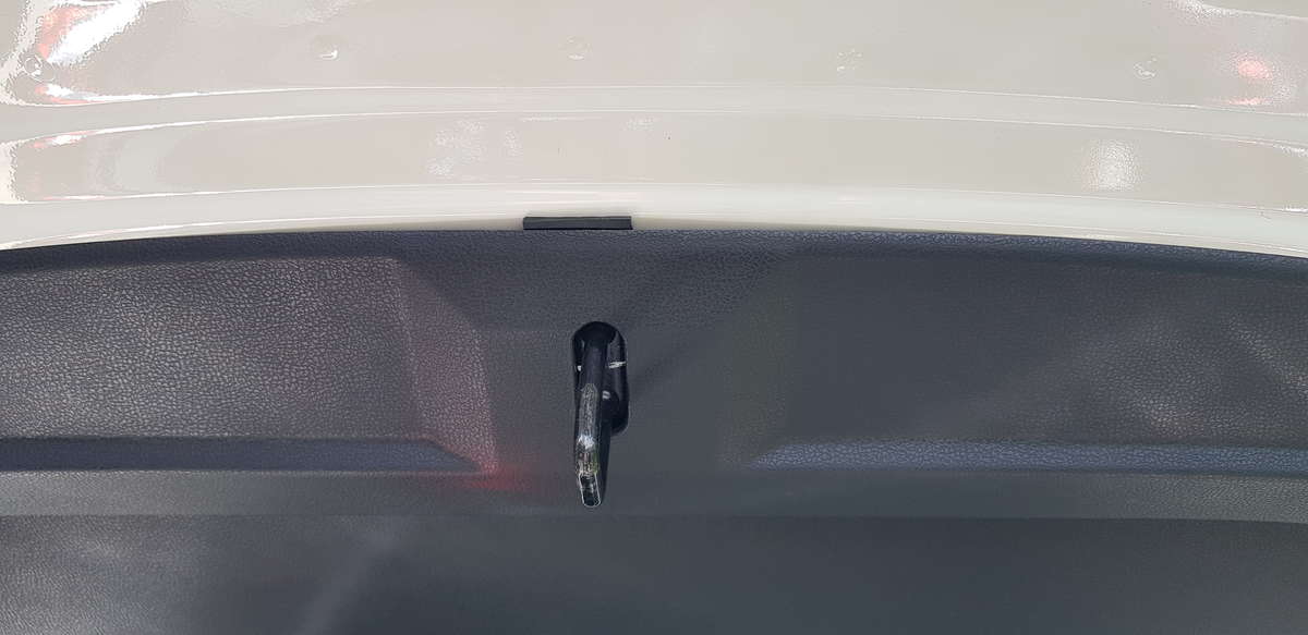

Wheels 370z Posted June 3, 2019 Share Posted June 3, 2019 I have exact same car Rich - vibration as same rev levels seeming to be coming from mid/rear cabin. After lining boot well with sound deadening mattingt and placing temporary packers in any suspicious plastic joints etc I have finally nailed it. Between the plastic trim on the underside of the boot. As you can see i've dropped a small rubber packer to prevent it vibrating. All this said I note your issue is more front end! Quote Link to comment Share on other sites More sharing options...
RichCox350Z Posted June 3, 2019 Author Share Posted June 3, 2019 On 03/06/2019 at 14:07, Wheels 370z said: I have exact same car Rich - vibration as same rev levels seeming to be coming from mid/rear cabin. After lining boot well with sound deadening mattingt and placing temporary packers in any suspicious plastic joints etc I have finally nailed it. Between the plastic trim on the underside of the boot. As you can see i've dropped a small rubber packer to prevent it vibrating. All this said I note your issue is more front end! Expand Hi Wheels, Thanks for the info, I’m not suffering any noise from the boot/mid area. I see it’s a common complaint from the google search results on a lot of US forums. But mine is definitely front end/dash area. Quote Link to comment Share on other sites More sharing options...
