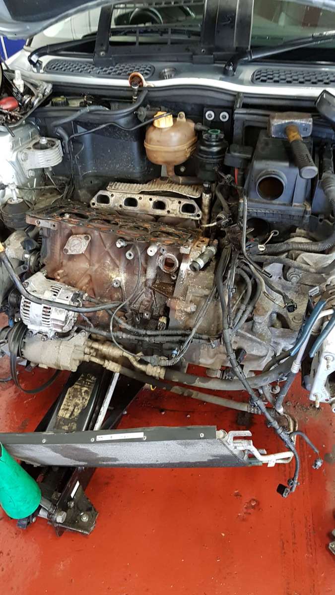

davey_83 Posted September 10, 2019 Share Posted September 10, 2019 Yep lesson learnt, progress and car looking good. Good mate the weekend complete a head gasket replacement on his Cooper S. Then got couple hoses mixed up for the supercharger and had the unit off again eek. Quote Link to comment Share on other sites More sharing options...
rabbitstew Posted September 12, 2019 Author Share Posted September 12, 2019 On 10/09/2019 at 17:13, davey_83 said: Expand Looks familiar seeing a Mini with the front end off! And good to see the essential tool there too - the lump hammer on top of the air box. 1 Quote Link to comment Share on other sites More sharing options...
