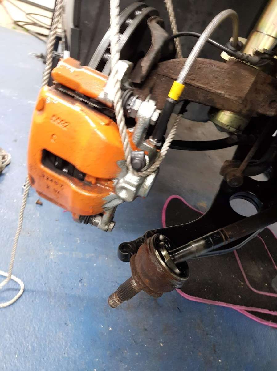

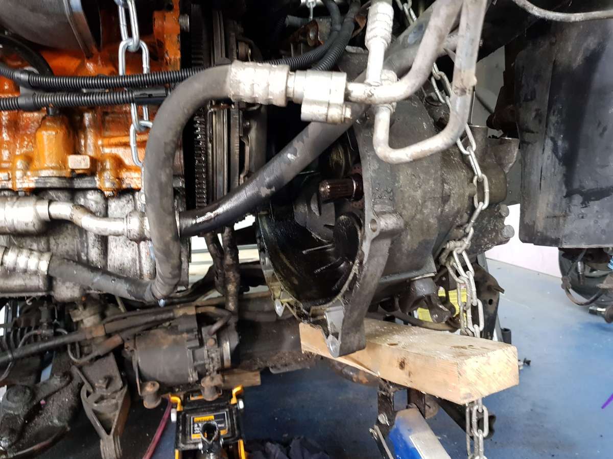

rabbitstew Posted May 31, 2019 Author Share Posted May 31, 2019 So the clutch. First of all if anyone else is seriously thinking of doing this job on a Mini, DON'T!!!!!!! My local Mini specialist wanted £300 labour to do this... please, just hand them the money. But, hey ho, this is all about "on the cheap" and so I have saved myself £300. But, the stress... So, the engine brace arrived, got it setup to support the engine and gearbox nicely, then dropped the front subframe. Had 4 mega seized bolts which took some messing about with the blow torch, but they came out in the end.. Subframe dropped, means we can now get the gearbox off.. Straight away... look how oily it is inside.... That cant be good and probably why the clutch is slipping. The actual clutch plate didn't look too bad tbh, but its probably contaminated. So the culprit for this oil is usually the crankshaft main oil seal, so I get the old one out... And install a new one. The trick with the new one is to use a screwdriver and get the inner lip in first, rotate it by hand until that inner lip is in, then you can push/hammer (gently) it in. I found an off cut off a black soil waste pipe from my house build was ideal to hammer the new seal home... So seal replaced, now I can bolt on the flywheel. I went for a stock dual mass one in the end. The other option is a lightweight flywheel which makes the engine rev quicker but is a bit more jumpy. I also read some bad reviews on the single mass, so went with original. Flywheel all bolted up using new bolts.... At this point I realised I needed a clutch alignment tool to fit the clutch plate & basket. So that stopped play.... well... nearly, so whilst waiting I removed the old wishbones from the front subframe. So much easier off the car. Pressed the old inner bush out... And poly bushed them.... Again, if your on a budget then don't bother, but these had been an MOT advisory for the last 4 years so needed doing, and whilst the subframe is off the car for the clutch, then its a no brainer. I fitted new inner & outer ball joints at the same time. Again, not really needed, but at something like £10 each it really makes sense to do these whilst you can... And I fitted the new poly bushed wishbone back on the subframe... So all in all, a pretty productive day. But in true tradition of things not going smoothly, I tried the same on the other side and the old wishbone bush will not press out. This is the side which must have been left in a ditch or something, as everything on the passenger side has been a nightmare so far. I've done loads of wheel bearings before just pressing them out in a vice, but this passenger side bush is not shifting, even with lots of heat, scaffolding pole and abuse. So will have a think and attack it in the morning. 3 Quote Link to comment Share on other sites More sharing options...

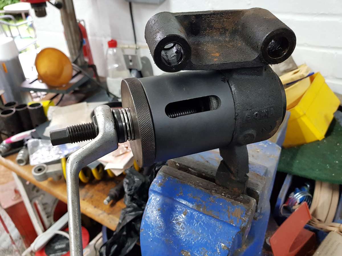

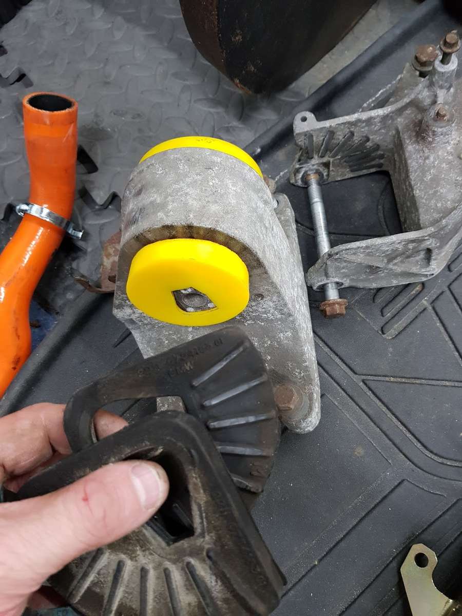

rabbitstew Posted June 7, 2019 Author Share Posted June 7, 2019 So now the wife & kids are back this last week has been a bit different and virtually zero progress on the Mini as I just haven't had any spare time. I did however manage to polybush the lower engine mount before fitting that back on... That was surprisingly easy. I was expecting the old bushing to be hard to get out, but a bit of heat and it pressed straight out using a large socket in a vice. New ones just push in by hand. The bushing comes with 2 big yellow inserts, and an optional black insert to make things even stiffer. I have no idea if that optional extra insert will be too much for the road or not, but hey ho, I have used it anyway. Besides that, I re-attached the passengers side drive shaft, and dropped the passengers side suspension strut out as I hadn't done that one yet. Now if you remember, its this passenger side I thought had been in a shunt before. Besides the strut tower being obviously mushroomed & bent... You can see on the old shock how bowed the top mount is... That's definitely has some sort of heavy bang. And finally, tell tale evidence that this shock has been replaced at some point with one from a breakers.. Now that says R50 which is the basic Mini One. I am not sure if there is any difference between the struts & springs on a Mini One & a Mini Cooper S, but that could be another factor as to why this car never handled well. Old strut stripped (again, thank god for the impact gun in getting that top nut undone :thumbs:), spring top plate transferred to the new coil over and we should be in a position to refit once I smash that bent strut tower flat again using a lump hammer. That just leaves... fit quickshifter refit exhaust, refit starter heat shield refit manifold heat shield refit coil pack change drivers side inner CV joint boot refit drivers side drive shaft refill gearbox with oil refit power steering motor fan reconnect outer ball joints reconnect steering tie rods reconnect steering column to rack reconnect drop links all around check everything torqued up refit radiator, flush coolant system out, refill, fit a/c condenser, front slam panel, connect lights, bumper, set suspension geo best I can, refit wheels... and that's just the stuff I can remember lol! I have also bought a new clutch slave cylinder as they are only £25. It will give me peace of mind as I think the seals in the other one might be knackered and is easy to fit whilst I have got the car in bits. Sounds a lot, but its only about a days work I expect. If only I could get a whole day in the garage that is! 2 Quote Link to comment Share on other sites More sharing options...

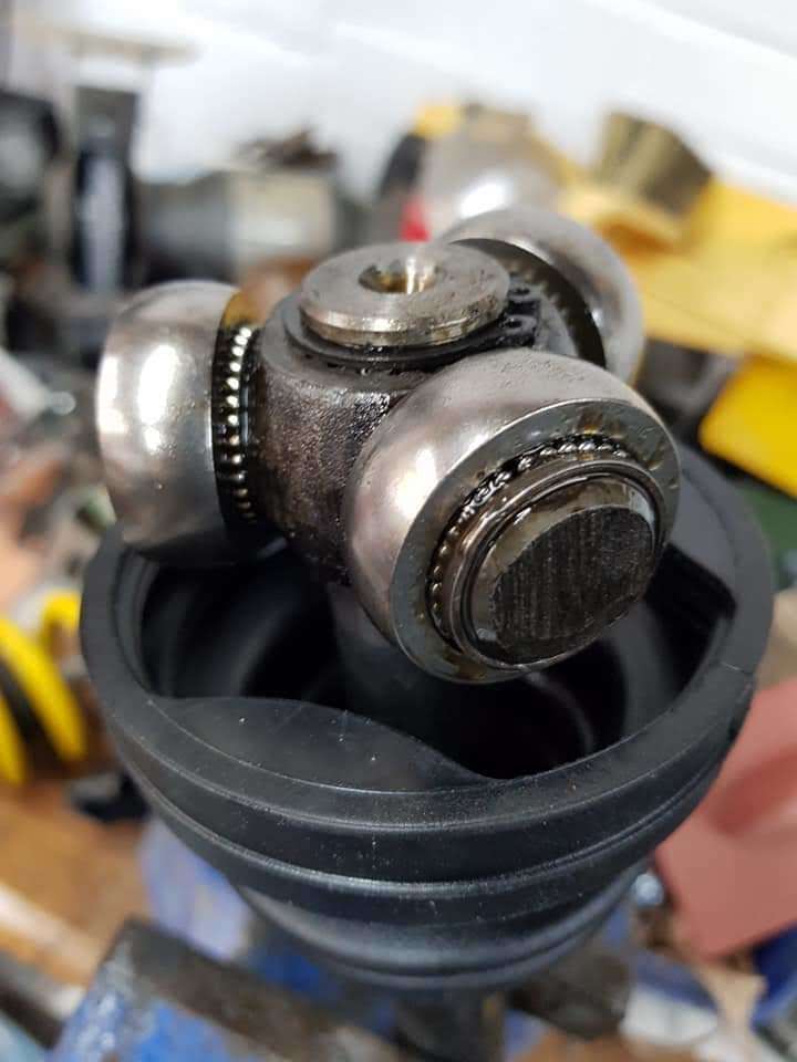

rabbitstew Posted June 11, 2019 Author Share Posted June 11, 2019 Got a couple of hours in the garage over the weekend. Firstly I swapped the inner drive shaft gaiter for a new one as the old one was split. Its a right messy job when this happens as the gaiter is packed with grease, which proceeds to be flung out all over the underside of your car/engine. Pretty easy job to to. You just remove this circlip, knock the end bearing thing off (carefully so not to damage them), then the old gaiter can slide off, and new one slides straight on. You then repack it with grease and clamp up the metal retaining clips. All done ready to put back on the car... Looking back, really I should have replaced all of them whilst I had the driveshafts off the car, but its not a hard job to do if any of the others go in the future and the others seem in good condition from what I can see. I then re-attached the steering column to the steering rack. This was very easy to do as I had good access from above being as the exhaust manifold is off. I refitted the drive shafts, connected hubs to lower arms, connected the steering arms to the hub, and re-attached power steering fan. Basically all the running gear is now back on. I then decided to change the drivers seat.. from this... to this.... with the help of a couple of little helpers... It was actually a pretty easy job. You basically remove the original seat - 4 bolts, then remove the original seat slider from the original seat. Then chop bits out of the new seat mounts so they then bolt straight to the original sliders... like so... I am keeping stock seat belts, so I reused the original seat belt buckle. These have those explosive auto tension things in case of accident which is the blue plug. The yellow one is for the seat airbag, which the new seat doesn't have, so i used a 3.9ohm resister I soldered across the wires - which apparently should stop the air bag warning light coming on. (fingers crossed!) I was actually quite surprised at how heavy the stock seats are, this is quite a weight saving. Okay, so StormWhite will have a stroke at me throwing money on things not strictly needed, and I did debate whether to get it or not as it will push me over budget. But the original seats offer little cornering support and the new bucket seat was only £200 incl. mounts so pretty cheap. Not only that I can always reuse this new seat in future cars if I want and besides... it looks loads better! As the car will be used to ferry kids to school etc, I have to retain the rear seats for the children's seats, and therefore need to keep the original passenger seat so I can tilt it forward so they can climb into the back etc. Otherwise I would probably strip the back seats all out and replace the passenger seat also to save some weight. So, not bad for a couple of hours work. Next on the list will be to fit this new clutch slave cylinder, power bleed the system and hopefully regain a normal clutch pedal... 3 Quote Link to comment Share on other sites More sharing options...
