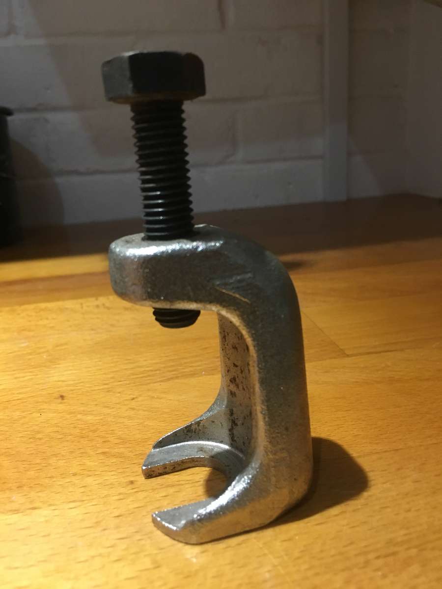

Ebized Posted April 22, 2019 Share Posted April 22, 2019 Would this do the job for you? Quote Link to comment Share on other sites More sharing options...

Ebized Posted April 22, 2019 Share Posted April 22, 2019 All I know is that it worked fine on a VW Beetle ball joint umpteen decades ago and has sat in a toolbox ever since! You are welcome to give it a go. If it helps, I will be up in Brockham on Sunday - if you pm me your number I will give you a call to meet up? Quote Link to comment Share on other sites More sharing options...
Kryptek49 Posted April 22, 2019 Share Posted April 22, 2019 I've not had much luck with the tool Ebized has - if the ball joint is quite large then you won't be able to line up the bolt with the ball joint, meaning it just slips off. I've bought a couple of different tools, and found this type to be the best so far: https://www.amazon.co.uk/NEILSEN-TOOLS-CT1578-JOINT-SEPARATOR/dp/B0044ZRTWE/ref=sr_1_4?keywords=BALL+JOINT+SEPARATOR&qid=1555969692&s=diy&sr=1-4 I haven't yet had to use it on the Zed though, but it seems to be the most universal solution. 1 Quote Link to comment Share on other sites More sharing options...
