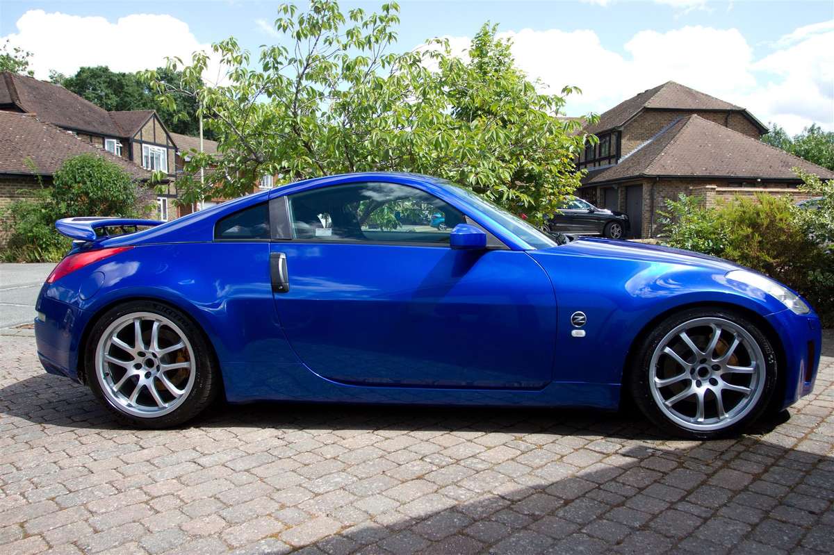

Car in its original form...

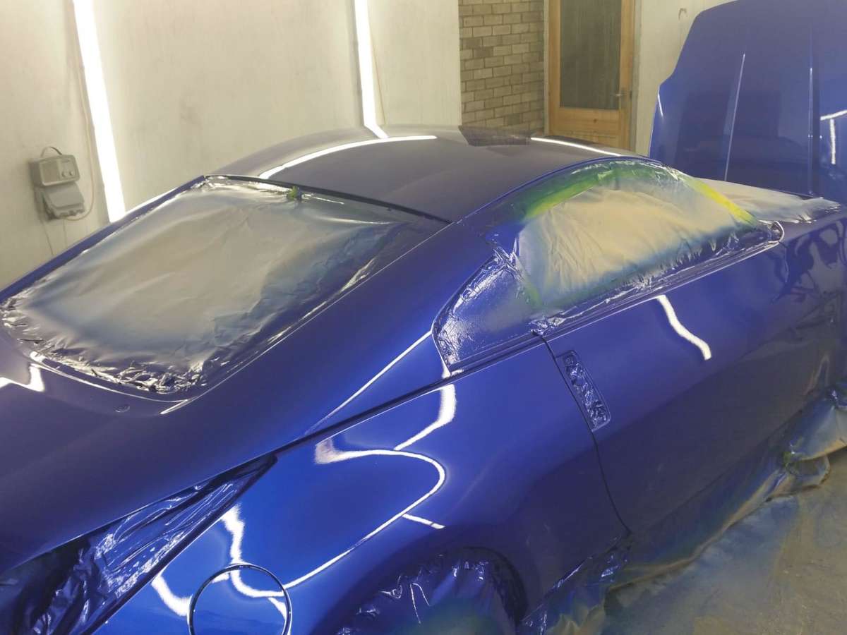

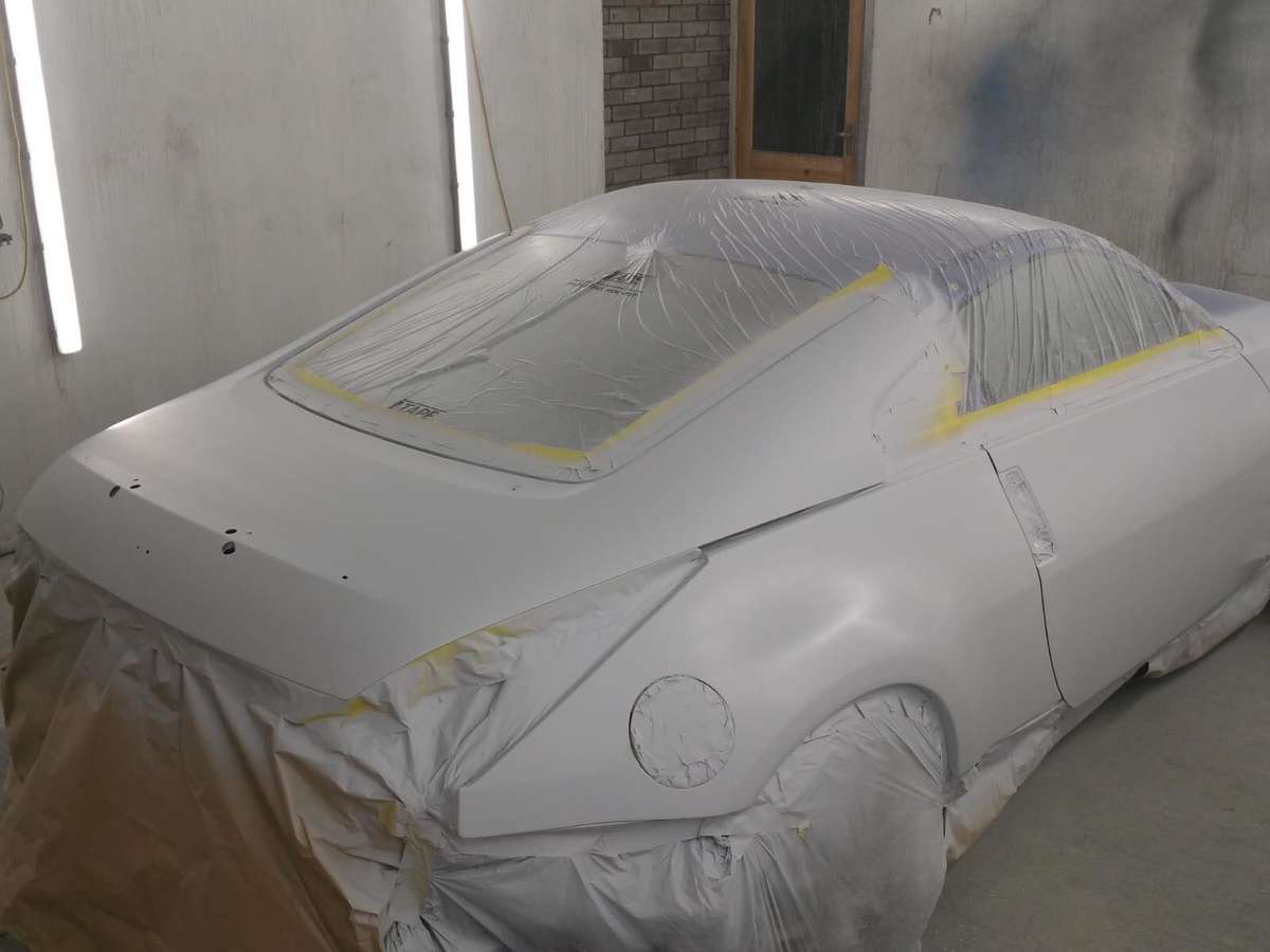

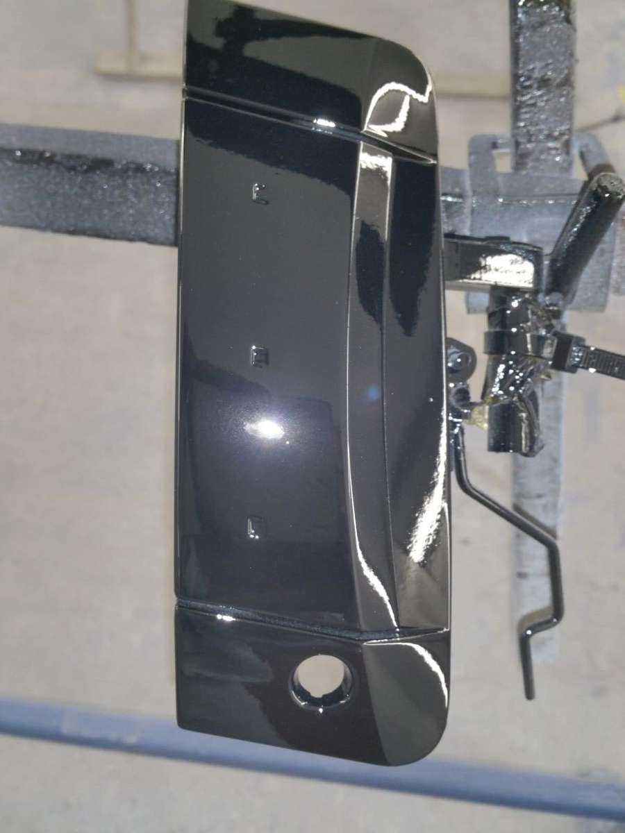

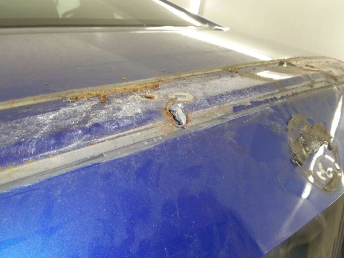

Some pictures MAC Motorsport took for me while they worked on it.
Wheel arches... (she's an old lady) :)

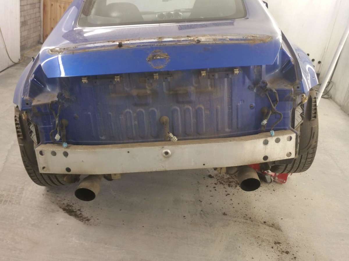

The wing removed...
55713721_303098013690741_50093255840235520_n.jpg.89ae6a1187252b6f308235b22205c337.jpg
55837867_305493143477558_6584204299495014400_n.jpg.79ea6751c1b224e20c36402245bd7c19.jpg

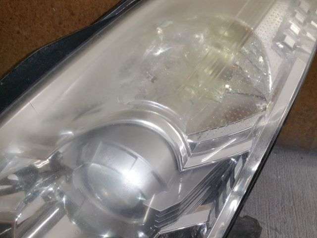

Headlights in need of restoration...

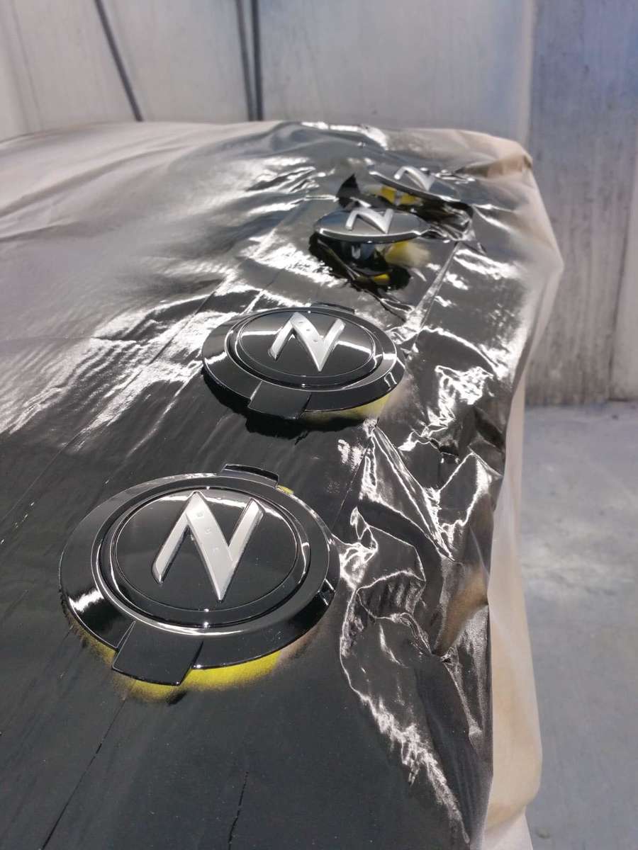

Z badges look amazing in black/silver...
56553667_645968935835709_603195021050511360_n.jpg.8745c3b2ea8fdb8d1ebee8056c9b5f68.jpg
I loved the end result, although pictures don't do it justice. See the next post. :)

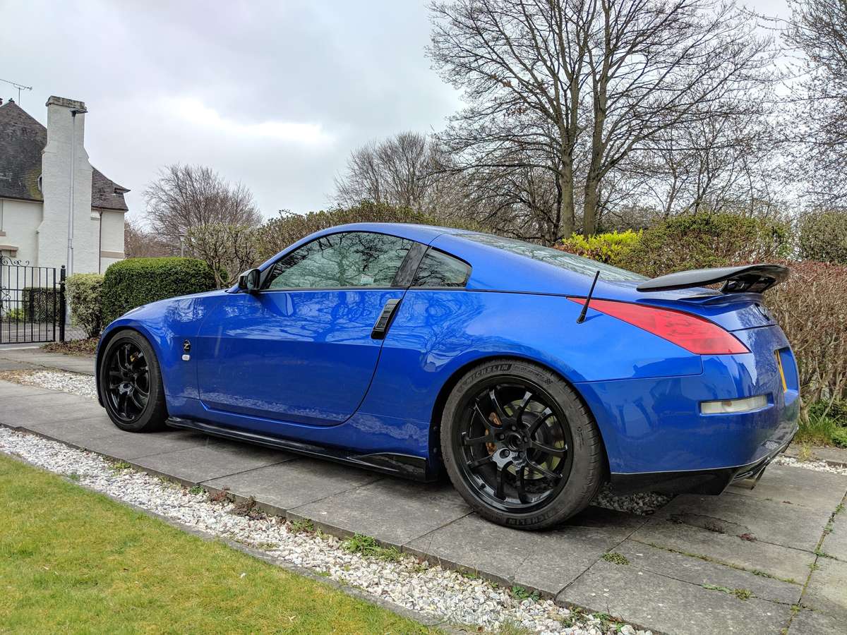

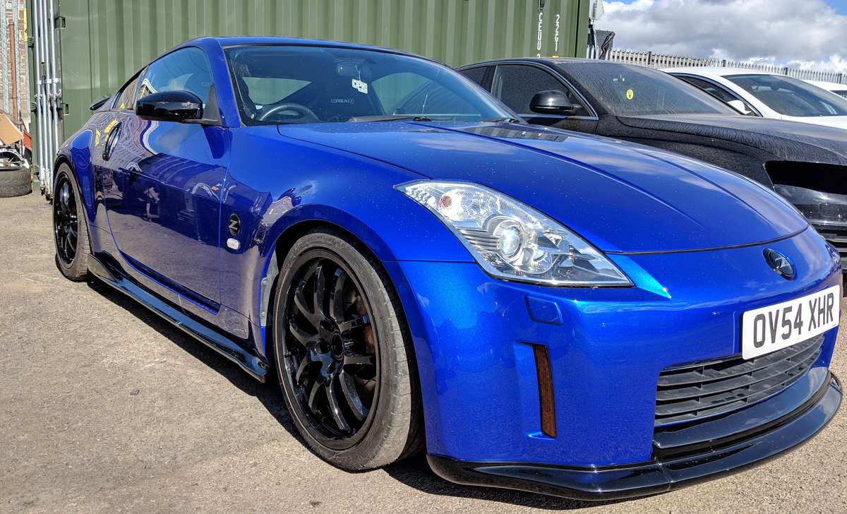

End result.... :teeth:
Love at first sight (At MAC Motorsport), although it has some dust sitting outside. :) ....
And back at home...
Still needs a proper wash, but I was i was advised to wait a week or so.

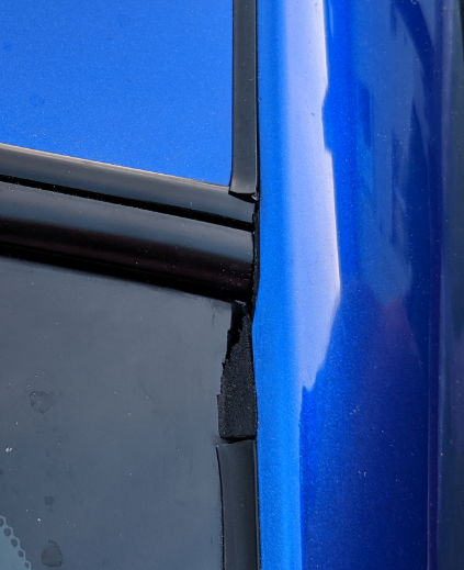

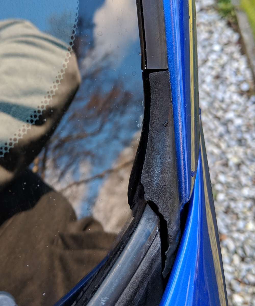

MAC Motorsports tried to fix the weatherstrip, but I suppose the pressure is too much, and it snapped up again.
The A-Pillars.... well, they are damn expensive if I need to get the entire thing. :(
Just for reference, this is state of mine.

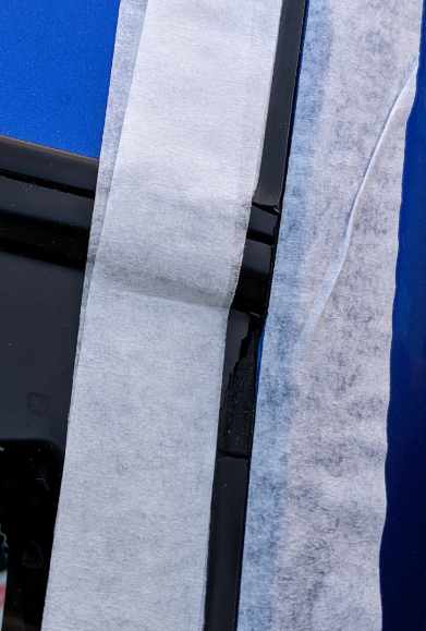

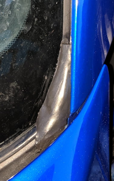

Some more DIY...
ZMANALEX was out of weatherstrips and A-Pillars, so I opted for repairing it instead.
NeeZ suggested Sugru ( https://en.wikipedia.org/wiki/Sugru ), and I'm rather pleased with the result.
This was at the end of the day once my kid was in bed, and there wasn't enough light to see the bits I missed. The next few days I'll touch it up.
So, the state as I've shown before...
Some preparation...
Result of all of them. Needs some touching up...
Didn't had enough light for the A-Pillars, so the finish is not as good. That will be fixed.
Lets see how it looks like tomorrow once cured. :D
If any of you could could post an up-close picture A-Pillars in good shape, it would be much appreciated, so I can know how to shape it when touching up.
It was so deteriorated, that I don't know the exact shape. :(
Edited by RuiFig

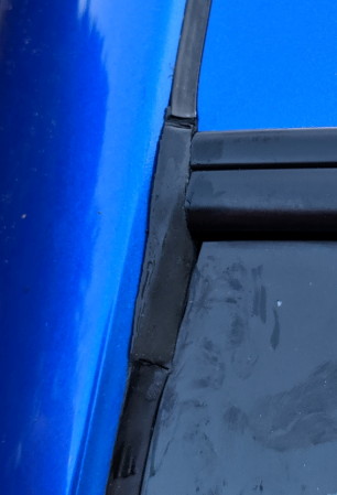

Taking her to The Scottish Performance Show on the 9th, the front seal came off completely. :/
After looking at other 350z in the show, I now see that the seal they've been trying to use doesn't really work with the 350z.
This is what happened to mine TWICE while driving to the show...image.png.8bbab69558af6b8df02fd7787f2ec8b4.png
What it seems is that on the 350z, the gap between the windshield and root is rather wide, and so it needs some kind of stripe in the middle.
The seal then is actually composed of two pieces.
As you can see in the picture. they are trying to use some kind of 1 piece seal that clearly doesn't work for the 350z.
It has nothing to hold it in place (other than the bit of glue on the roof, so once it gets some wind underneath it on the motorway, it will just peel off.
While at the show, I took a picture from another 350z that had a bit missing (so I could see how it looks like inside)... :)
 So, it seems its composed of two seals. One in the roof, another in windshield.
The one in the windshield has no glue whatsoever, and is hold in place by clicking into that plastic stripe running along the gap ?
