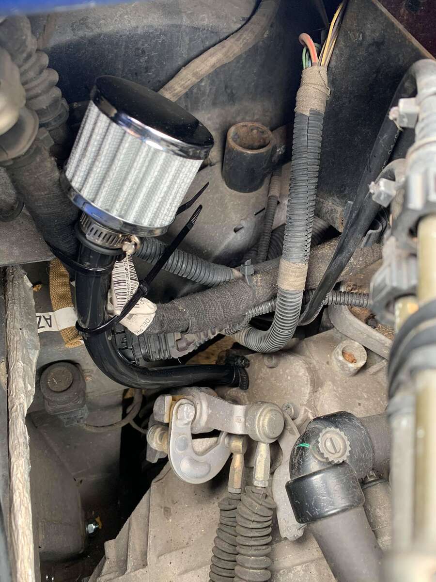

coldel Posted June 6, 2020 Author Share Posted June 6, 2020 Gearbox breather mod done - the F23 is a very capable gearbox but the breather nipple [insert childish snigger here] is situated literally 12 inches from the nearside rear tyre, somewhere you definitely dont want oil being expunged onto...common mod on these is to get some tubing, clips, small air filter, and run about 20cms of tubing up from the nipple [insert further childish sniggering here] to the filter and cable tie it all in place. Oil then goes up the pipe and back down again, instead of being sprayed over your gearbox and tyre 2 Quote Link to comment Share on other sites More sharing options...
Stutopia Posted June 7, 2020 Share Posted June 7, 2020 Untrimmed cable ties. It’s like I don’t even know you any more. 2 Quote Link to comment Share on other sites More sharing options...
coldel Posted June 7, 2020 Author Share Posted June 7, 2020 Ha! They are trimmed, I took the photo before I did it, wanted to make sure it was all in the right place 1 Quote Link to comment Share on other sites More sharing options...

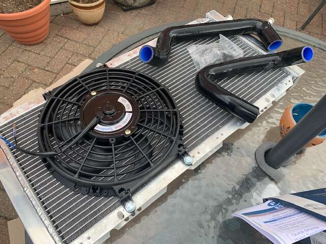

coldel Posted June 9, 2020 Author Share Posted June 9, 2020 (edited) This arrived today, looks a very nice bit of kit and half the price of Pro Alloy ones. Company is called Coolexperts and have a great range of options. Could potentially take the fan off the old one and add it to this to have a dual fan option. Lets see what the old fan looks like when it all comes off. Also ordered some other parts today. Mishimoto magnetic sump plug for the oil change - its very pretty Type116Motorsport front towing post and eye - the old ones are exposed and prone to rust/loss of strength Rear towing eye which attaches direct to the undertray on the subframe bolt Once all this is on, service done, will have one very nice car with all the main jobs done Edited June 9, 2020 by coldel Quote Link to comment Share on other sites More sharing options...

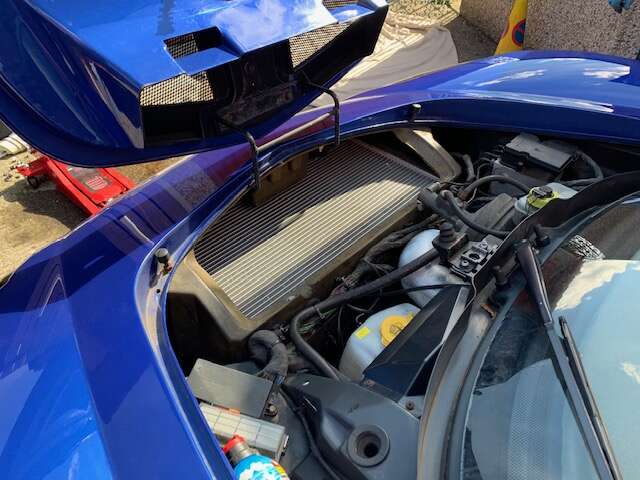

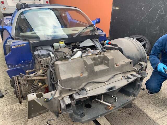

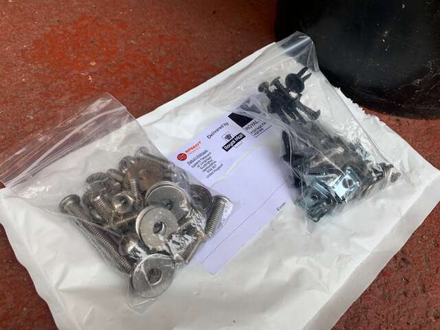

coldel Posted June 20, 2020 Author Share Posted June 20, 2020 Jeeezusss Chryyyyst. If the bolts just came off, we could have had that front clam off in about 30 minutes. but no, TWO AND A HALF HOURS. Why did Lotus think using screws and allen bolts directly into fibreglass is a good way to build a car I will never know. Anyway. Some good jobs done today. Radiator changed and new fan installed. I also bought a new set of rad hoses which went on. Also a full set of new bolts and washers etc for the clam and rad surround. I also installed a new tow post at the front with much thicker walls etc. and also a tow eye bolted to the rear subframe at the back. We didn't have enough time to change out the oil or change the air filter. That can be done in the next week or so. Clam off, two bloody bolts, just two little bolts...causing so much pain. A few quids worth of stuff New rad and hoses Rear tow eye and fastners Tow post in, and rad installed 1 1 Quote Link to comment Share on other sites More sharing options...
ShortPaul Posted June 20, 2020 Share Posted June 20, 2020 10 minutes ago, coldel said: Jeeezusss Chryyyyst. If the bolts just came off, we could have had that front clam off in about 30 minutes. but no, TWO AND A HALF HOURS. Why did Lotus think using screws and allen bolts directly into fibreglass is a good way to build a car I will never know. Anyway. Some good jobs done today. Radiator changed and new fan installed. I also bought a new set of rad hoses which went on. Also a full set of new bolts and washers etc for the clam and rad surround. I also installed a new tow post at the front with much thicker walls etc. and also a tow eye bolted to the rear subframe at the back. We didn't have enough time to change out the oil or change the air filter. That can be done in the next week or so. Clam off, two bloody bolts, just two little bolts...causing so much pain. A few quids worth of stuff New rad and hoses Rear tow eye and fastners Tow post in, and rad installed Nice work sounds like a pig of a job Quote Link to comment Share on other sites More sharing options...
andy james Posted June 20, 2020 Share Posted June 20, 2020 Nice work Colin. Don't be too hard on the old girl. If it was an Audi R8 V8 you would have to take the motor out to sort the air con! 1 Quote Link to comment Share on other sites More sharing options...
coldel Posted June 20, 2020 Author Share Posted June 20, 2020 My brother and dad were very calm, I was absolutely raging. Hence why they are both mechanics and I work on a laptop 1 Quote Link to comment Share on other sites More sharing options...
