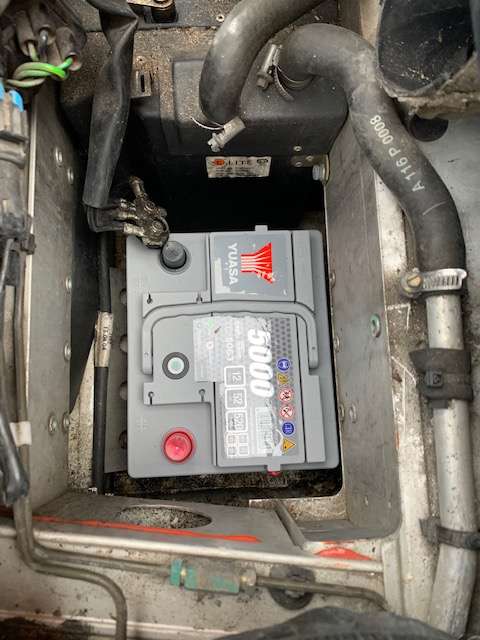

coldel Posted February 18, 2020 Author Share Posted February 18, 2020 Will be interesting to see what comes out, in the VX you can only see the top of the battery as it sits in a recess! Quote Link to comment Share on other sites More sharing options...
Stutopia Posted February 18, 2020 Share Posted February 18, 2020 Same issue on the Toybaru, OEM dies if you switch it off for 20 mins. Loads of folk have gone back under warranty, got a new (same) battery and then are astonished when it happens again. They go back under warranty, get a new (same) battery - lather rinse repeat.... For the £70 it cost me to get an upgrade, I feel it was a good spend - saves trips to the dealer and I'd sooner be driving and £70 lighter, than stuck somewhere with £70 in my pocket - several times over Quote Link to comment Share on other sites More sharing options...
coldel Posted February 22, 2020 Author Share Posted February 22, 2020 New battery in, 52A Yuasa - car spins over much quicker now and with a lot more purpose! Proper pain though you have to remove the washer water bottle, remove wires, vaccum line etc. Definitely needed two pairs of hands, and the handle is a godsend! And she passed her MoT today 2 Quote Link to comment Share on other sites More sharing options...

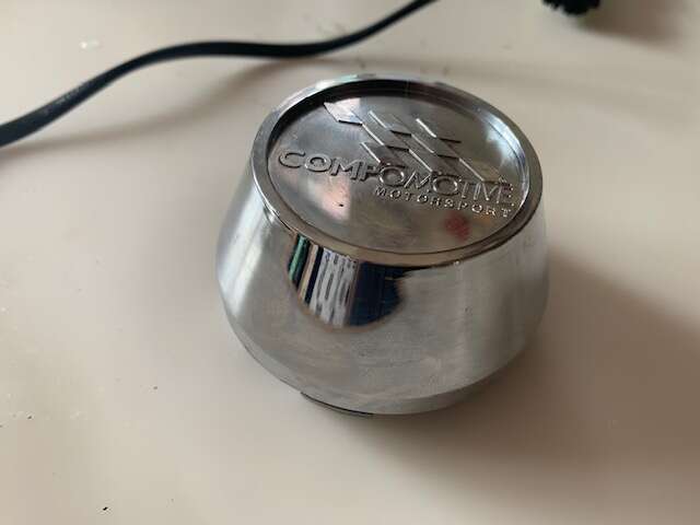

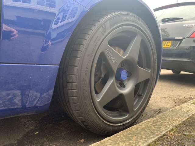

coldel Posted May 3, 2020 Author Share Posted May 3, 2020 More tinkering today - the wheel centre caps, one especially, are looking a little tired. They are plastidipped a matt black colour. So got the worst offender off and cleaned it up went from this to this I do happen to have some metallic black plastidip so could easily respray them. question is should I? I have the option of chrome coloured centre caps vs black The other out there idea is spraying them a matching blue, as I do also have dark metallic blue plastidip too... Quote Link to comment Share on other sites More sharing options...
ilogikal1 Posted May 3, 2020 Share Posted May 3, 2020 Centre caps should always match the wheels for me. Quote Link to comment Share on other sites More sharing options...
coldel Posted May 3, 2020 Author Share Posted May 3, 2020 Well I have just started dipping one of the caps in blue...can always just peel it off...but will see what that looks like in about 20 mins! Quote Link to comment Share on other sites More sharing options...
coldel Posted May 3, 2020 Author Share Posted May 3, 2020 (edited) Hmmm maybe not! Edited May 3, 2020 by coldel Quote Link to comment Share on other sites More sharing options...
Ekona Posted May 3, 2020 Share Posted May 3, 2020 Oh god no, paint it black! 1 Quote Link to comment Share on other sites More sharing options...
ATTAK Z Posted May 3, 2020 Share Posted May 3, 2020 As the Stones said “leave it chrome” Quote Link to comment Share on other sites More sharing options...
coldel Posted May 3, 2020 Author Share Posted May 3, 2020 1 hour ago, Ekona said: Oh god no, paint it black! You will be glad to know, I went with black 3 Quote Link to comment Share on other sites More sharing options...

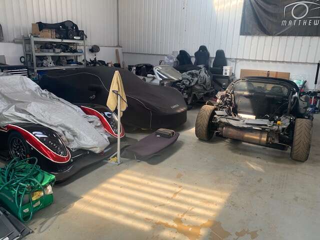

coldel Posted May 26, 2020 Author Share Posted May 26, 2020 (edited) Did the little job of reseating the gear surround today and screwing it to the surround. Shows off the carbon gear shaft in the car much better. Also got this very important lot through ready to be fitted by Matthew Bentley Motorsports tomorrow uprated toe links and strengthened hub carrier bolts Edited May 26, 2020 by coldel 1 Quote Link to comment Share on other sites More sharing options...
coldel Posted May 27, 2020 Author Share Posted May 27, 2020 (edited) All done, phew! Toe links are a known weak point on these cars (also Elises) and should be treated as perishables. Not a cheap bit of kit by any means but the outcome from a failed toe link is something like this ... note not my car, just to show how catastrophic fails are! Basically the rear wheel collapses and points any direction it wants So here is the VX up in the air getting the work done - undertrays off, wheels off, then removing the old ones and putting in the reinforced kit. This involves drilling a new mounting in the subframe so is not easily done without the car lift and easy access. Also whilst the car was up in the air replaced the hub carrier bolts, another know failure point, with high strength replacements. There was also some tasty looking kit tucked away under wraps I was having a nose around... Edited May 27, 2020 by coldel 1 Quote Link to comment Share on other sites More sharing options...
