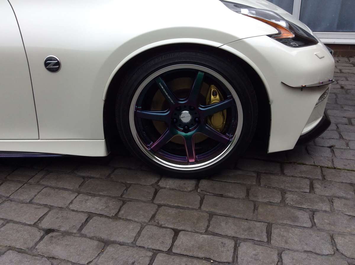

Eddie f Posted March 15, 2019 Share Posted March 15, 2019 Car is far to low at front after fitting lowering springs..bumper catching on uneven roads and I dare not go near speed bumps .and am sure when I hit pot holes it hits the bump stops .. I like the back , but the front is very low .. scared to drive the car fast .. so my question is, will Coilovers lift it up a bit or should I fit the original springs.thanks Quote Link to comment Share on other sites More sharing options...
StormWhite Posted March 15, 2019 Share Posted March 15, 2019 (edited) My first question would be how low did you choose to go? AFAIK lowering springs are offered in different sizes resulting in differing amounts of "Lowering". I learnt my lesson in my previous car, had to traverse speed humps in a certain way but despite that on occasions joining roads with aggressive camber would catch me out ie. leaving a nearby petrol station springs to mind. Decent coilovers seems to me an expensive fix, could you get less aggresssive lowering springs? Edited March 15, 2019 by StormWhite Quote Link to comment Share on other sites More sharing options...
Eddie f Posted March 15, 2019 Author Share Posted March 15, 2019 It said 25mm front and back .. Vogtland springs .. but the ride is rock hard ..just wanted to close the wheel and arch gap a little so it looked better.. with 20 mm spacers .. but the front wheel is right under the arch . Quote Link to comment Share on other sites More sharing options...

Eddie f Posted March 15, 2019 Author Share Posted March 15, 2019 Quote Link to comment Share on other sites More sharing options...

Eddie f Posted March 15, 2019 Author Share Posted March 15, 2019 That still looks to low for driving about were I stay.. only wanted to take away a bit of the wheel gap .. now my car if far to low and can’t drive it fast Incase I hit a pot hole or uneven surface, it’s my weekend car so I’ll just take it easy till I change it back. Quote Link to comment Share on other sites More sharing options...
