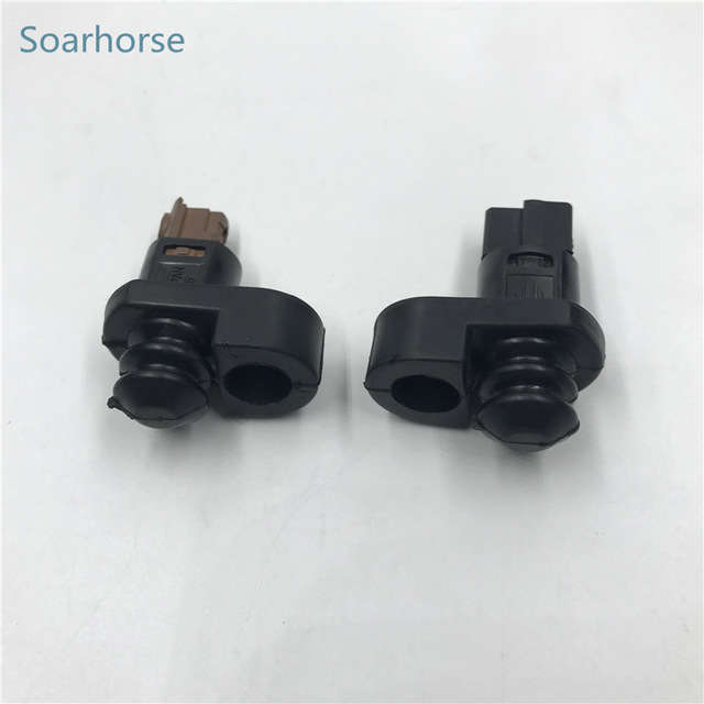

davey_83 Posted January 20, 2019 Share Posted January 20, 2019 (edited) Tried the door switches on the b post?.... Edited January 20, 2019 by davey_83 Quote Link to comment Share on other sites More sharing options...

davey_83 Posted January 21, 2019 Share Posted January 21, 2019 It's these door switches that tell the windows to drop upon opening. These could have a dirty contact, mispositioning or folded over themselves as one of mine did. Quote Link to comment Share on other sites More sharing options...
