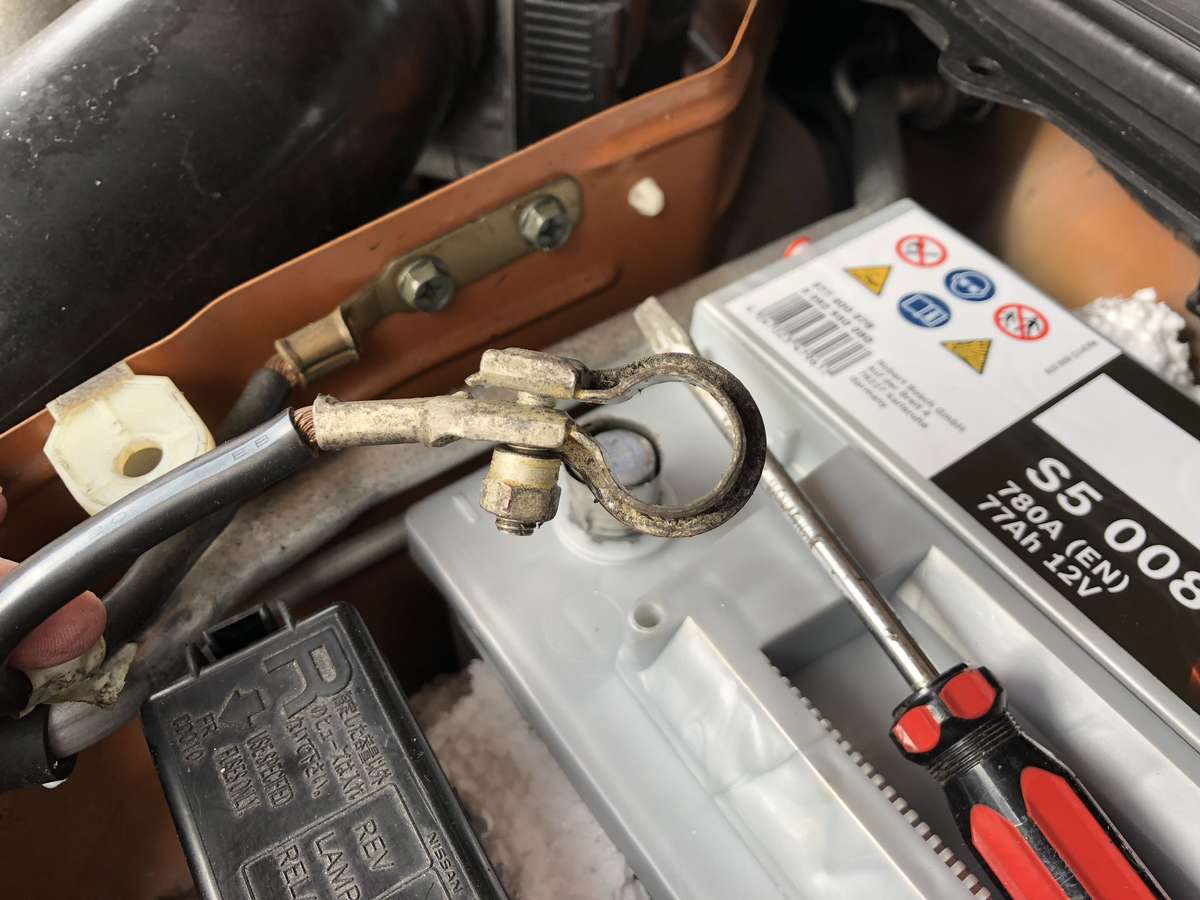

Cassy Posted January 14, 2019 Share Posted January 14, 2019 Hi everyone, I’m new to this site but not the 350Z. I have recently bought my second a few months ago and am open to working on the car as much as possible but im a little stumped. I’ve recently had to buy a new battery because the old one the old owner had simply wasn’t enough so I now have the Bosch S5. However, whether it was the old or the new battery, the terminal clamp/connector doesn’t fit around the negative terminal on the battery and works itself off as if it’s slightly too big for th terminal. I've been looking for a replacement so I can get it sorted before the new battery is ruined but I can’t find what I need online. Does anyone have any ideas as to why it’s slightly bigger than the terminal (almost as if it’s a positive connector) if so, do you know what I need to do to fix the issue or where I can buy the correct connector please? i look forward to any and all help - thank you all in advance! Caroline Quote Link to comment Share on other sites More sharing options...
SHEZZA Posted January 14, 2019 Share Posted January 14, 2019 I had the same issue with mine when fitting a new battery. What I did was to pinch the eyelet together a bit where the bend is in the eyelet and that seemed enough to make it tight enough. Quote Link to comment Share on other sites More sharing options...
Cassy Posted January 14, 2019 Author Share Posted January 14, 2019 Thank you, I’ll try this out. I’ve put a screw in the clamp to try and fill it out but unfortunately I’m not sure if I’m strong enough to push it together even more! I’ll give it a go though and see how I get on! Thank you! Quote Link to comment Share on other sites More sharing options...
