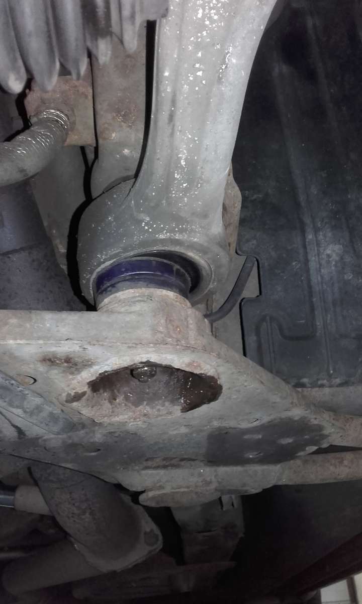

ricochet Posted November 26, 2018 Share Posted November 26, 2018 When the nsf wheel bearing/hub was being replaced this was noted , is it significant ? I believe its what is known as the banana arm . it is the same both sides. 2004 Coupe 113k miles , just passed MOT. All helpful comments welcomed, Quote Link to comment Share on other sites More sharing options...
RobPhoboS Posted November 26, 2018 Share Posted November 26, 2018 (edited) No. It's a superpro poly bushing (with caster adjustment) Edited November 26, 2018 by RobPhoboS Quote Link to comment Share on other sites More sharing options...
ricochet Posted December 3, 2018 Author Share Posted December 3, 2018 Thanks Rob, I was asking particularly because there is a low speed clonking coming from the front (I think) of course there is no movement anywhere even with a big pry bar so I wondered if these bushes were moving under stress. A hairy brawny mechanic said he did manage to find a smidgen of movement in a drop link but I think DLs have a higher pitched sound. Does 'caster adjustment' mean I should have some adjustable suspension arm(s)? Quote Link to comment Share on other sites More sharing options...
RobPhoboS Posted December 4, 2018 Share Posted December 4, 2018 (edited) So that's likely to be the other end of the arm/rod. Unfortunately the other end is a sealed ball joint type of bolt. Search for 'banana arm rattle' or 'compression arm rattle', and you'll see plenty of threads, it's common but quite hard to diagnose. It's more than likely to be this, so buy new ones and have the old super pro bushings pressed out, and pressed into the new arms. If you leave the stock rubber bushings in the new arms you're likely to notice slower steering responses typically. Check out the sponsored sellers, I know Torqen has a range of them not just the Nissan made one's. Any problems, just ask as I've done my ones a few times over the years. Out of curiosity, is your car lowered? Re: caster It's up to you, and depending on your cars caster if it needs more or less. If it's within spec just make sure it's pressed in the same orientation. SuperPro have a pdf iirc on their website. Edited December 4, 2018 by RobPhoboS Quote Link to comment Share on other sites More sharing options...
ricochet Posted December 20, 2018 Author Share Posted December 20, 2018 apologies Rob for not replying earlier. Z is not lowered but has 10mm wheel spacers. Do the Super Pro bushes not wear out then? Will try and find original purchase/fitting details . Quote Link to comment Share on other sites More sharing options...
RobPhoboS Posted December 20, 2018 Share Posted December 20, 2018 35 minutes ago, ricochet said: apologies Rob for not replying earlier. Z is not lowered but has 10mm wheel spacers. Do the Super Pro bushes not wear out then? Will try and find original purchase/fitting details . No worries. You'll be fine, and no they shouldn't wear out at all ! It's only the opposite end of the bar that eventually starts rattling, so yep it's worth pressing out and putting into the new ones (if that's exactly what is knackered). Quote Link to comment Share on other sites More sharing options...
