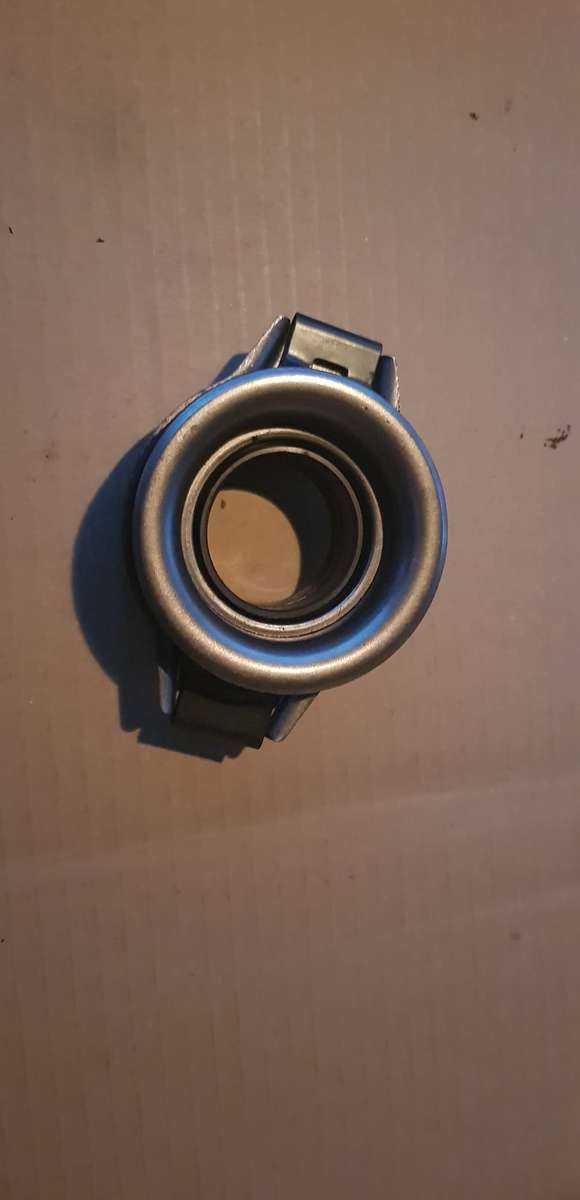

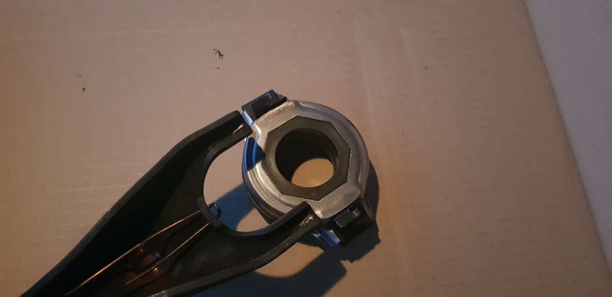

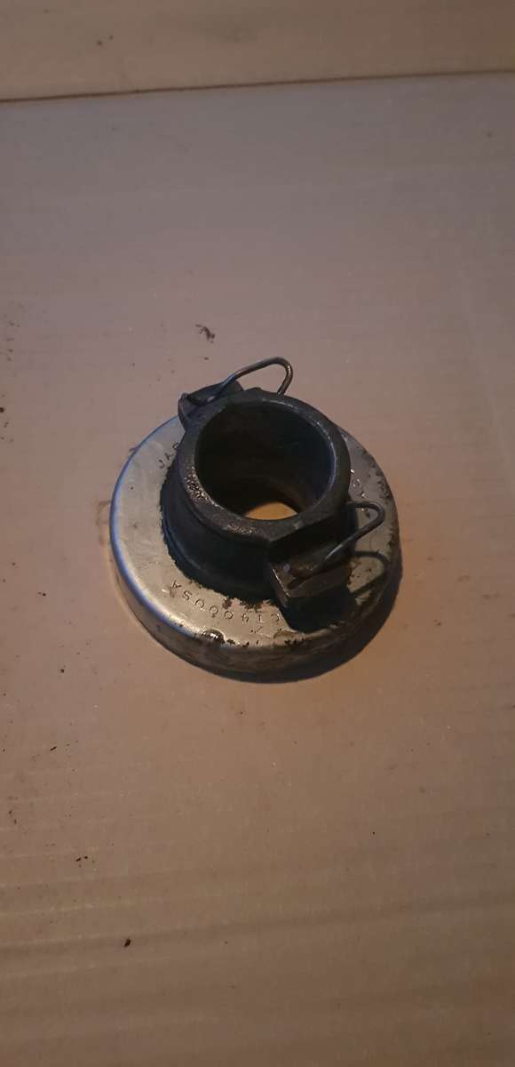

JimmyWhite1 Posted November 5, 2018 Share Posted November 5, 2018 (edited) Hi all, My mechanic currently has my car on the ramps trying to fit the new Exedy 3 piece clutch + Flywheel. Unfortunately, we have stumbled across rather annoying issue which has baffled quite a few of us. The bearing that has been removed is different to the bearing that is with the new kit, and as far as I can find, the new bearing is the correct one. My mechanic is saying that the fork won't fit the new bearing but the fork I have is OEM Nissan and the same that you can buy from Torqen & Nissan. Has anyone else had this problem, or are we being completely stupid and missing the point? Any help would be greatly appreciated. Thanks in advance New bearing Current old bearing Edited November 5, 2018 by JimmyWhite1 Quote Link to comment Share on other sites More sharing options...

ZMANALEX Posted November 5, 2018 Share Posted November 5, 2018 The fork connects to the bearing carrier and not the bearing. Use a new Koyo bearing similar to your old one. RCT4000SA You will have to press the old bearing off the carrier and then press a new Koyo bearing on to the old carrier. I am not aware of Exedy supplying that type of new bearing/carrier that came in your clutch kit. I think I know what the issue is. Who did you buy the clutch kit from? Quote Link to comment Share on other sites More sharing options...

JimmyWhite1 Posted November 5, 2018 Author Share Posted November 5, 2018 4 minutes ago, ZMANALEX said: This is what you want: Part number is in last post. Thanks again. That bearing doesn't look like my old one, I'm guessing it's for display purposes only? I'll do some more thorough research tomorrow and buy from a more reputable company. Really appreciate the help. Many thanks. Quote Link to comment Share on other sites More sharing options...
ZMANALEX Posted November 5, 2018 Share Posted November 5, 2018 That is the same bearing that is in your first post, trust me. Your picture shows the bearing fitted to the bearing carrier. As I have already explained you have to press the bearing off the old carrier and then press the new bearing onto the old carrier. 1 Quote Link to comment Share on other sites More sharing options...
