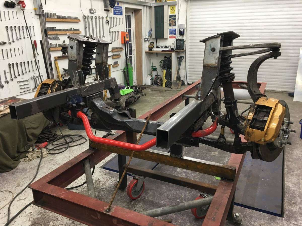

Keyser Posted January 4, 2019 Author Share Posted January 4, 2019 OK Then as you have all put on weight just by looking at the pictures above sit back and digest the small amount of progress made - I finished off the front suspension arms and removed the frame - Then a test fit Added the ARB carriers and the ARB Then I took it all apart and checked the symmetry (big word for me ) Well happy with that just need to trim the top plate That done I went onto the rear frame that I hadn't finished. After measuring up wrong (I'm only human) the rear spring hangers had to be moved leaving a bit of a hole Made a fill in piece weld and clean up (you'd never know I cocked up More Soon Keyser Maximum Effort (to burn of all the calories) 6 Quote Link to comment Share on other sites More sharing options...

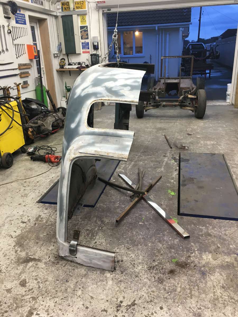

Keyser Posted January 16, 2019 Author Share Posted January 16, 2019 OK then, Stand by to cringe Now it was pointed out to me by someone that shall remain anonymous @andybp that I was basically building a 350z chassis from the ground up, this is all well and good but will it fit into the pop shell? Well the simple answer is no - not a hope in hell, did I let that slow me down? No So now I have front and rear suspension mounts made I got the shell off the old chassis and into the Zed Shed - a few measurements show that the bracing on it was not sufficient or stresses since they were fitted have caused it to bend out of alignment so add straightening it up again to the list of problems Anyway a few more measurements and the afore mentioned busy body and my suspicions proved correct - it aint gonna fit the body is to narrow for the new running gear! So I came up with a solution (some may say it's OTT) Bloody wide enough now isn't it So the theory is lay it over the suspension and fill in the gap in the middle Stay tuned to see how that goes Keyser Maximum Effort 6 1 Quote Link to comment Share on other sites More sharing options...

DoogyRev Posted January 16, 2019 Share Posted January 16, 2019 now that's a cut n shut 1 Quote Link to comment Share on other sites More sharing options...
mattross1313 Posted January 16, 2019 Share Posted January 16, 2019 59 minutes ago, Keyser said: Bloody wide enough now isn't it I'd say so!! A buddy of mine did this to a MK1 MR2 many years ago. He had a shell laying around (as you do), and had an old Jag (?) V12. So he sliced the MR2 down the middle and wang'ed the V12 in the back. It was unreal!! 1 Quote Link to comment Share on other sites More sharing options...
rabbitstew Posted January 16, 2019 Share Posted January 16, 2019 I thought you`d have measured up before you started making the chasis, as those Ford Pops are mega narrow cars! doh! How much wider does it need to be? Still, a lot of people would have just chopped the top off 350z and welded the pop shell on top. 1 Quote Link to comment Share on other sites More sharing options...
