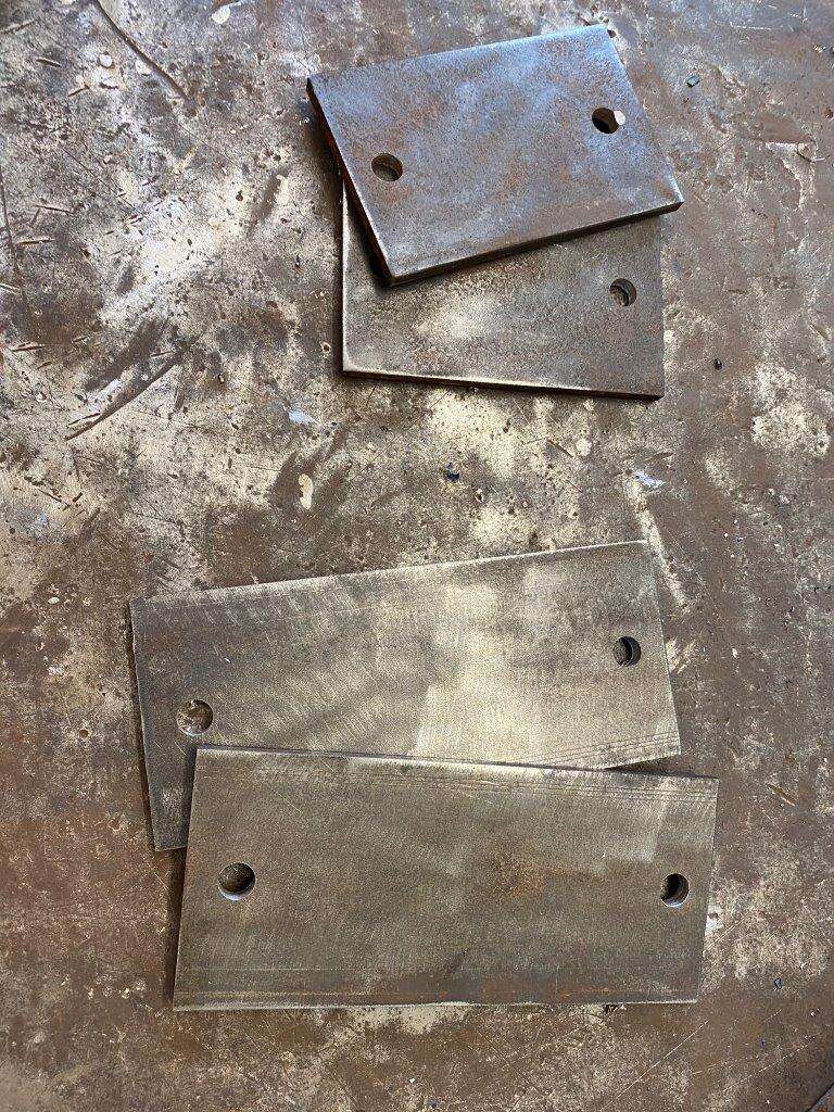

Then some plates
Lined up and tac welded on

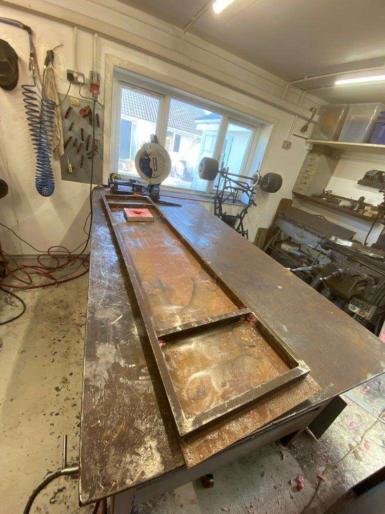

Some more box
And some half inch bar
All joined together to make a shelf
That rolls out :thumbs:
Here are the rollers, I need to add a stop so it can’t fall out :scare:

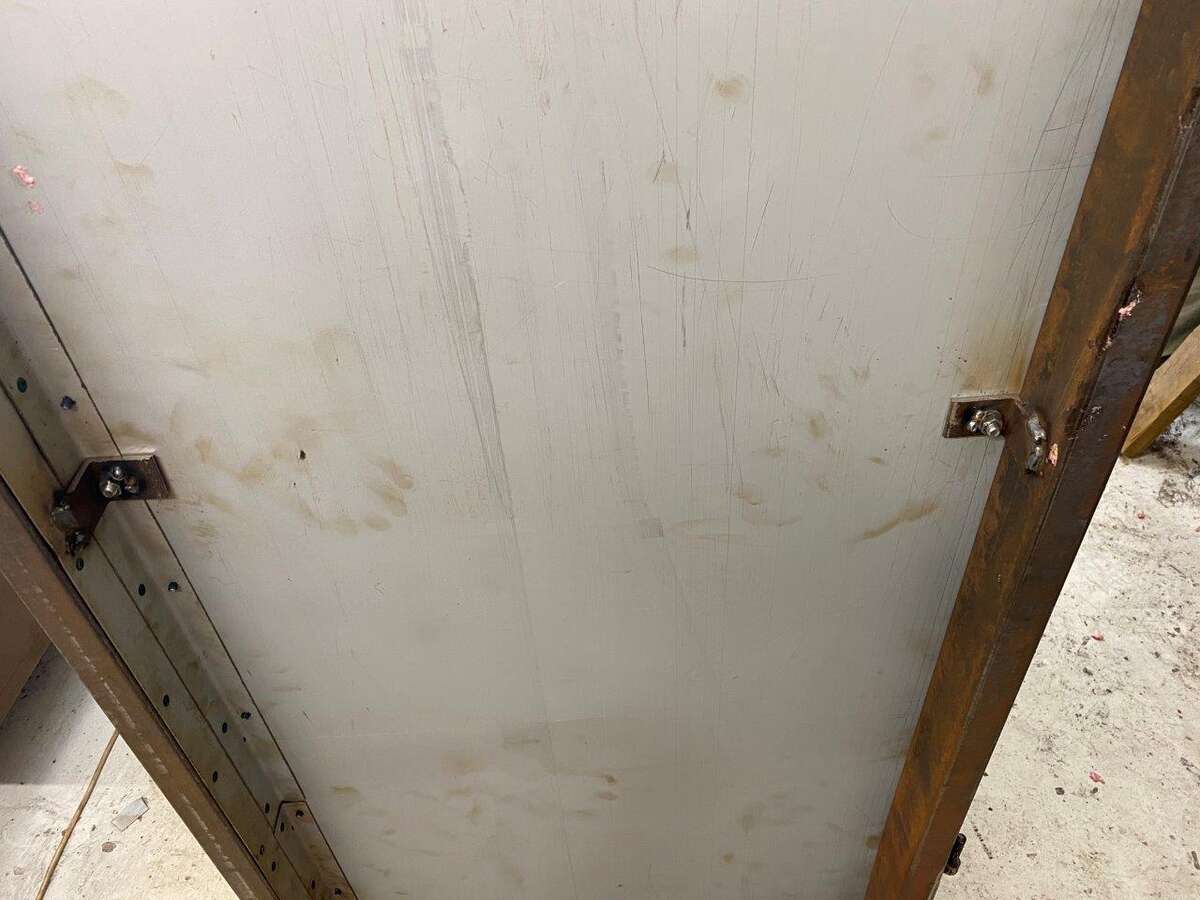

I added a second set of plates and they bolt through the inner skin
I will weld these outer plates to the frame and weld the nuts on so they become captive so the shelf can be removed and it is not just held up by the inner skin :)

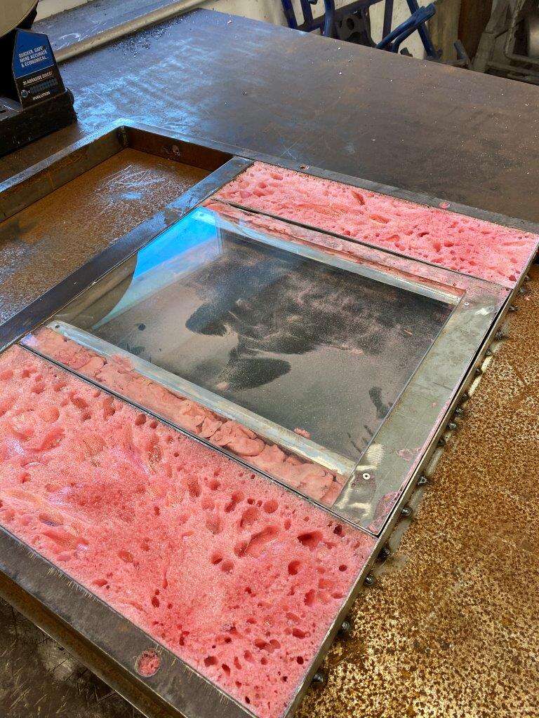

So I trimmed that down and test fitted the window frame,
On the small door
The foam had a big hole in it right where it is most needed, not sure why, maybe it’s because the foam is out of date :lol:
I’ll stick some more in when I do the last lot on the back.

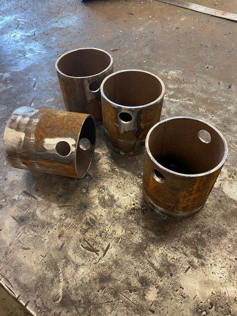

Then an old bit of pipe was cut into lengths
Some holes drilled
A bit of tube cut to length
Holes drilled in the oven
Then weld it all together
These are the light fittings and the tube is for the wiring

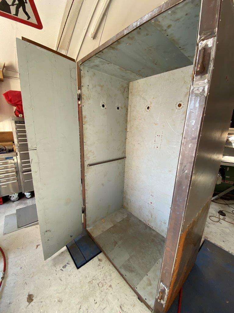

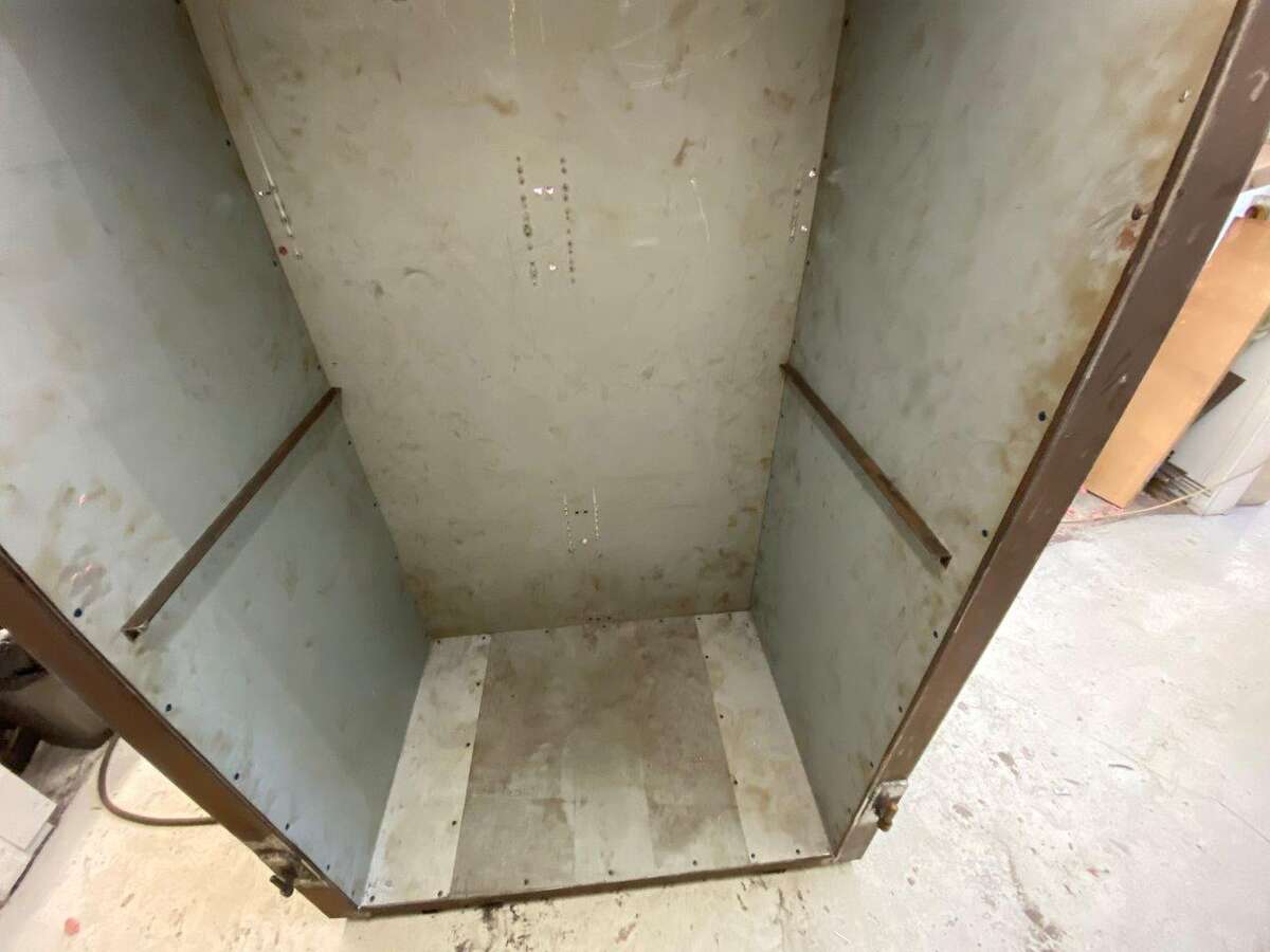

I welded some support tags onto the inside to give the top shelf extra strength
Cleaned these bits of previously used angle iron
And put them in the oven for a middle shelf
Again, supported to the frame

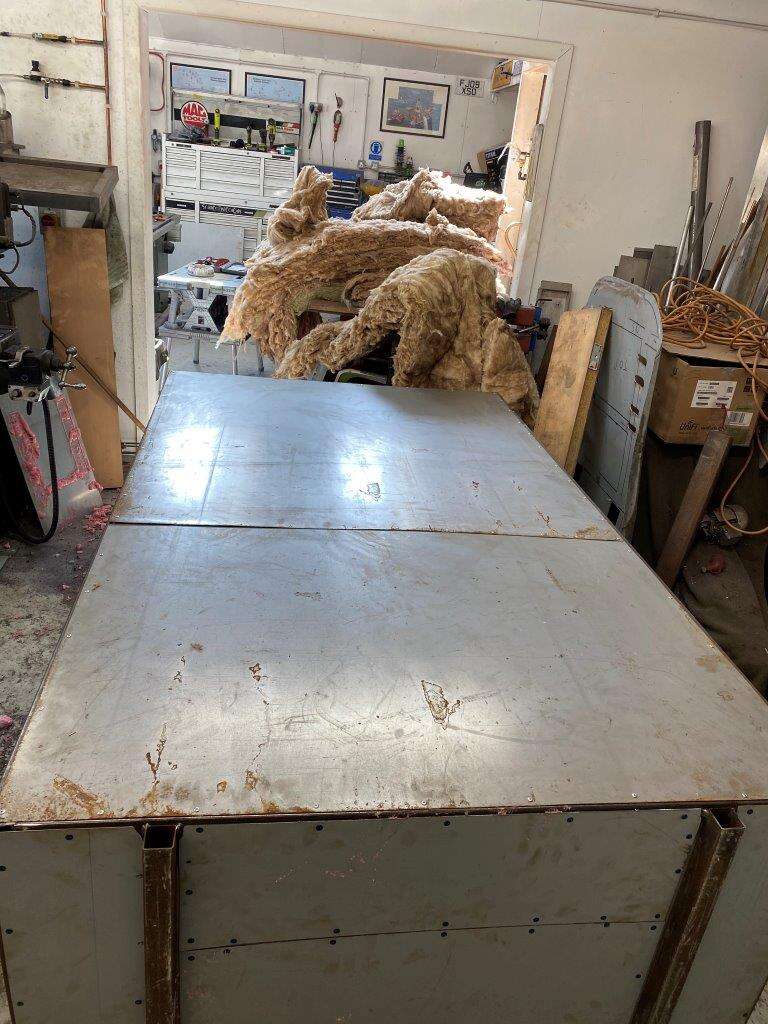

Top insulated and cover on
One side
Other side
And we are here
Small door
Window was fitted in theis handy hole :lol:
I made a cover plate but it is held in with self-tappers rather than rivets so the window can be easily removed if required

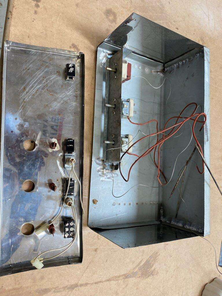

There was a draw in the Smeg and it was shiny so that seemed like a good reason to repurpose it :thumbs: cut a section out and bent it into a box of sorts
MMM Shiny! :lol:
Made a back from an off cut
Then some carefully spaced hole drilling

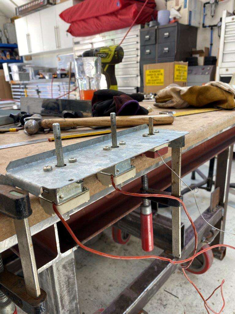

Then I had to sort out a discrepancy in thermostat controls, they come from two different ovens, so of course they are not the same length
Nothing an angle grinder can’t solve :lol:
Next I made these trendy tags up
They let me reuse the lights from the Smeg on my new switches
Then I mounted the thermostat switchs in the back part of the housing
- I said they were complicated - well for a switch they are :lol:
Had to add notches for the lights etc
Tac welded some end plates in
Made a top
To give us the final control box
Even has space for expansion in case I need more elements at a later date and it's shiny :lol:

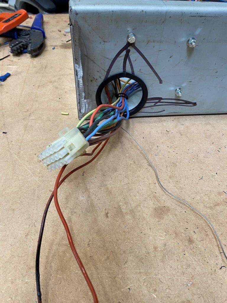

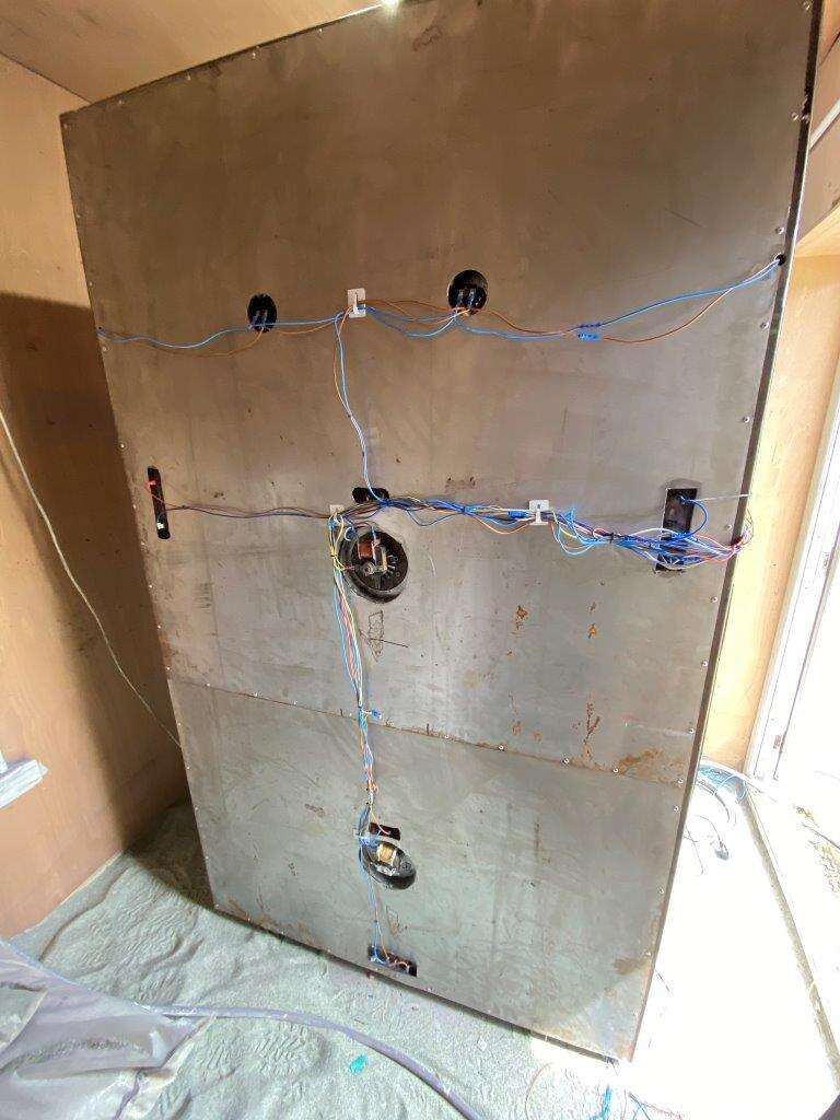

Onto the wiring then
Started with a hole for the cables
Started laying in wires
Took a while but got all the switches wired up in the end
I used a plug from the Smeg so the control box can be removed if required
Mounted it onto the oven
Put the elements in and ran the wiring round
The back looks like this now

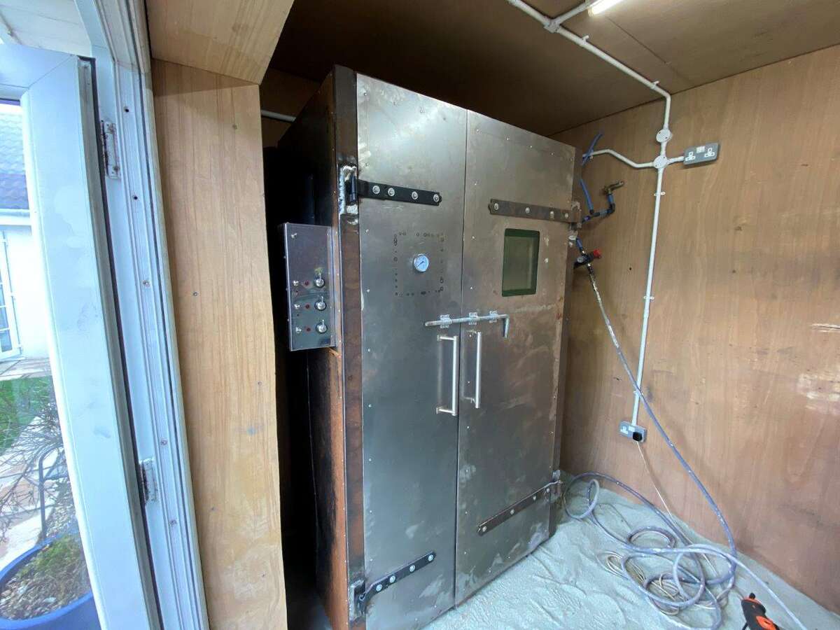

Morning all,
Back to normal with work 5 days a week and only weekends to do all the normal stuff around the house associated with being an adult (I don’t do the adult thing very well :lol: )
Did manage to get the powder coat oven finished this weekend :thumbs:
I put the top bar in and added stops, so it won’t fall out
Then a nice big bolt to keep the doors shut
Needed handles but the SMEG ones are different lengths
So I cut them down pushed the end fitment out and put it back in the now shortened tube so I have matching handles
Installed the thermometer
Here she is all in place wired up and ready for a test before I decide if I need to anything else
I do want to make some accessories like a middle shelf and some more hangers but nothing that stops me using it.

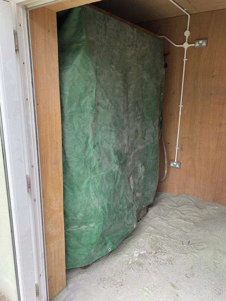

For now, I added a cover
That’s so I can sand blast the shelf from the lathe and get it powder coated, that will let me finish another project :thumbs:
