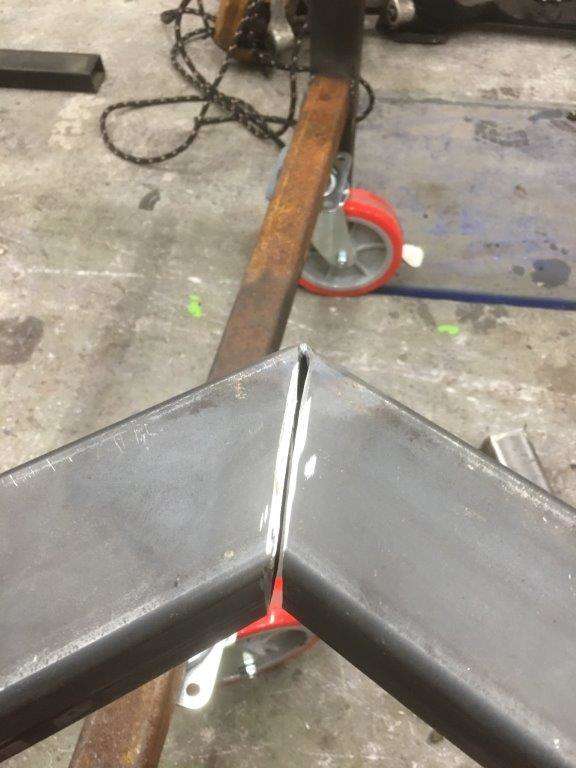

Length of 50 x 75 x 3mm wall box section with a pie cut
Clamped
Angle check
Prepared
welded
and repeat to give 2

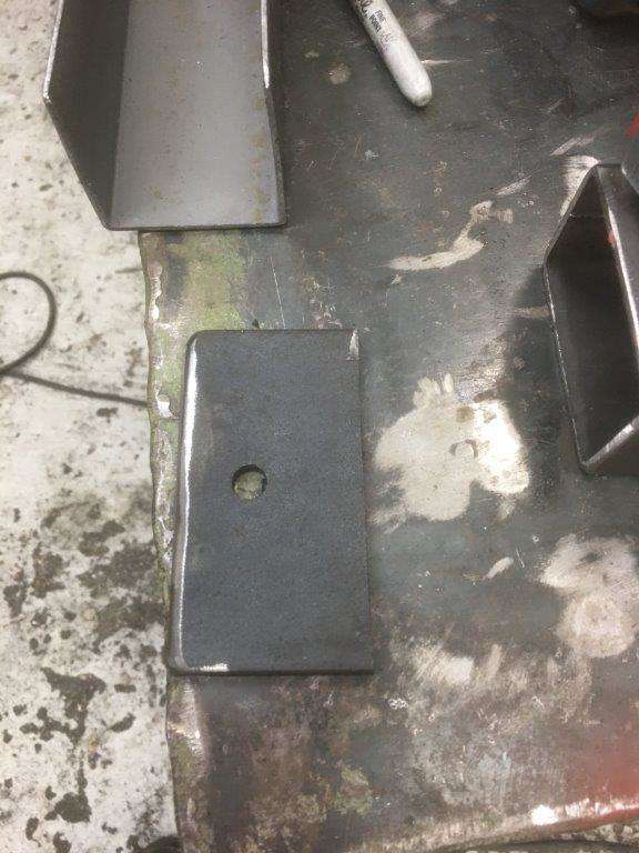

2 bits of 60x60x2mm box
First cut
angle cut
A 6mm spacer plate as 60mm - side walls 2x2mm = 56mm and I need 50mm
holes for spot welds
Clamps
welds
Gives us -

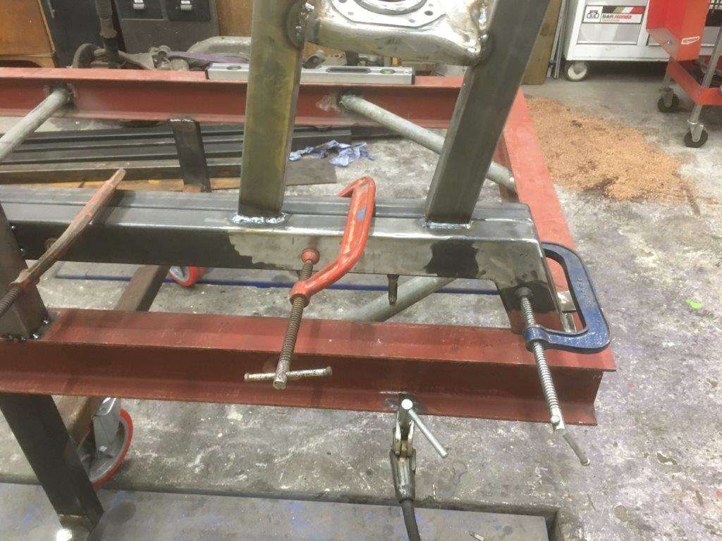

So first job for the Jig is to help me get the second front chassis rail identical to the one I made yesterday,
It's great :)
Then 2 hours to get these bits
Out of this
Clamp the two sides together
Mark it up and weld in the first pin
Add the next two pins and see if the match
O yes :thumbs:
Angles and hieght are good too :)
Only problem is I didn't clamp the rail while I welded in the last 2 pins!
I paid the price - it heat warped
Not a major drama I'll either heat it with the oxy or just put a relief cut in straighten it and weld it back up again. It happened behind the cross-member mounts so it's just a bit more faffing to get it right.
