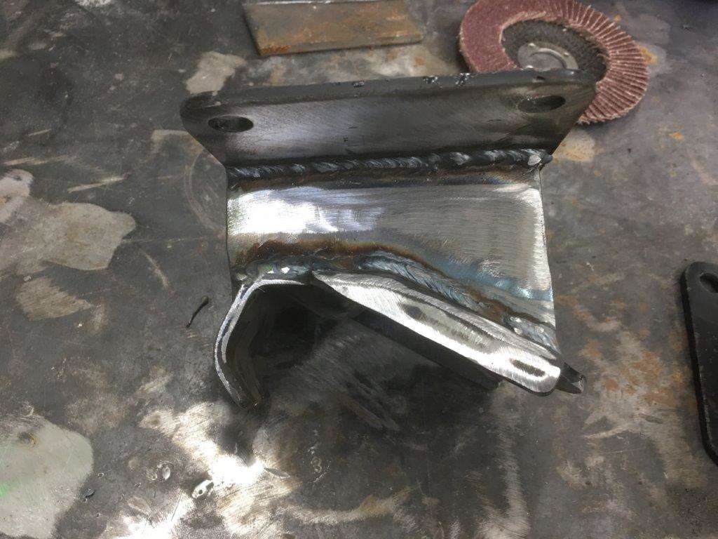

Keyser Posted October 7, 2018 Author Share Posted October 7, 2018 I'm going to attempt to do as much of this conversion as possible without buying any of the conversion kits, I will still need some specialist parts made such as the propshaft, I'll probably go for the ready made clutch upgrade but will see how much I can save if I DIY that as well, the rest we will just make up as we go So if anyone spots and obvious mistakes or has any constructive criticism to offer please don't be shy post it up Banter is obligatory on this thread so if you aren't up to it don't follow I had to start somewhere so I put the engine on the hoist and tried it - Not even close Needs to be further back and lower, but with the sump on it can't do either which was to be expected as all the kits come with a new sump and modified oil pickup. I removed the sump put the gearbox on and tried again. I got everything as close to needed as possible, bear in mind there has to be a few compromises, then started on the engine mounts. Original 350z Mount - used because A. I have them and B. I can always use the upgraded version later if needed and it should be a 1 for 1 swap. I also got this with the engine - They came with the engine which was going to be put into a BMW, I cleaned it up as I want the plate that fits on the engine (this could easily be made but why waste what I have) For the other side I had similar but as the distance is more I kept some of the metalwork. clean up the 350 engine mount top plates Make a template weld the up - Drivers side Passenger Side The all important fitted Happy with that, I now have to make a gearbox mount to replace the trolley jack More Soon. Keyser Maximum Effort 6 Quote Link to comment Share on other sites More sharing options...
