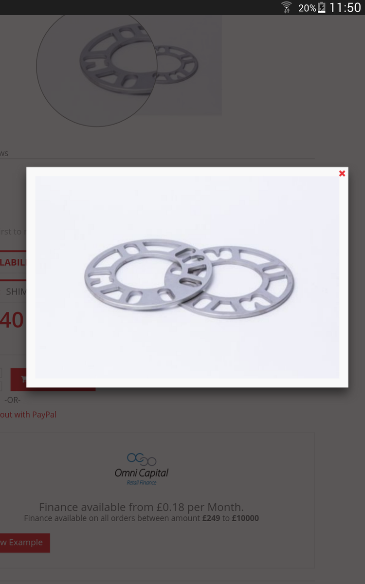

Lex300 Posted June 20, 2018 Share Posted June 20, 2018 Hi guys will these spacers be fine on standard length studs. And will the wheel still have a hub centre lip to sit on or will it be holding on just by the studs . I might need 5mm for the front wheels to clear the caliper . Just want to make sure it will be safe .thanks Quote Link to comment Share on other sites More sharing options...
valy Posted June 20, 2018 Share Posted June 20, 2018 I got them on mine to clear the front brembo's and are fine but make sure you have good thread on the wheel nuts Quote Link to comment Share on other sites More sharing options...
Lex300 Posted June 20, 2018 Author Share Posted June 20, 2018 5 hours ago, valy said: I got them on mine to clear the front brembo's and are fine but make sure you have good thread on the wheel nuts Thanks valy im getting new wheels nuts 1 Quote Link to comment Share on other sites More sharing options...
