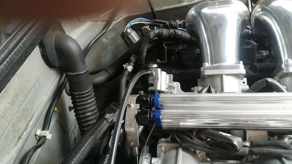

andybp Posted May 5, 2018 Author Share Posted May 5, 2018 On 05/05/2018 at 18:29, davey_83 said: Looks mega!! Do you remove the gauge after set up or leave it for show as I use too? After a while of being fitted it'll soon go out of calibration as they are meant to be fitted, used for set up then removed. Expand I'm gonna leave it in for now at least Quote Link to comment Share on other sites More sharing options...
davey_83 Posted May 5, 2018 Share Posted May 5, 2018 What fuel pressure you looking to tune it too? Quote Link to comment Share on other sites More sharing options...
andybp Posted May 5, 2018 Author Share Posted May 5, 2018 On 05/05/2018 at 18:40, davey_83 said: What fuel pressure you looking to tune it too? Expand about 50 psi Quote Link to comment Share on other sites More sharing options...

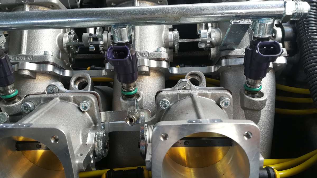

andybp Posted May 11, 2018 Author Share Posted May 11, 2018 I have been progressing with this project sadly I'm currently waiting for parts, a spring specifically you'd think I could just pop up the road and get one but no. well I have got quite specific requirements anyway while waiting there was an issue with the end throttle bodies where the throttle position sensor would go the problem being my sensors are in the throttle servo so I needed to cap and seal this shaft i think the Jenvey items come with plastic caps and mine obviously come with nothing so this is my solution I have also tweaked the vacuum lines from the throttle bodies as I was getting too much pulsing so I now have four lines coming from the bodies to the manifold the signal is much more stable now, the Evaporative emisions line is also connected and I have tapped one of the velocity stacks so it will be drawn in between the air filter and the butterfly I've run it in a clear petrol line for now as it's the only hose I had in that size but will change it later. I've also sorted out the PCV system the rockers are now vented to a catch can and again goes to a port tapped into another velocity stack sadly again in clear plastic for now as I've run out of black Ok enough for now as I need to go and order some plastic pipe cause that clear stuff looks like crap 1 Quote Link to comment Share on other sites More sharing options...

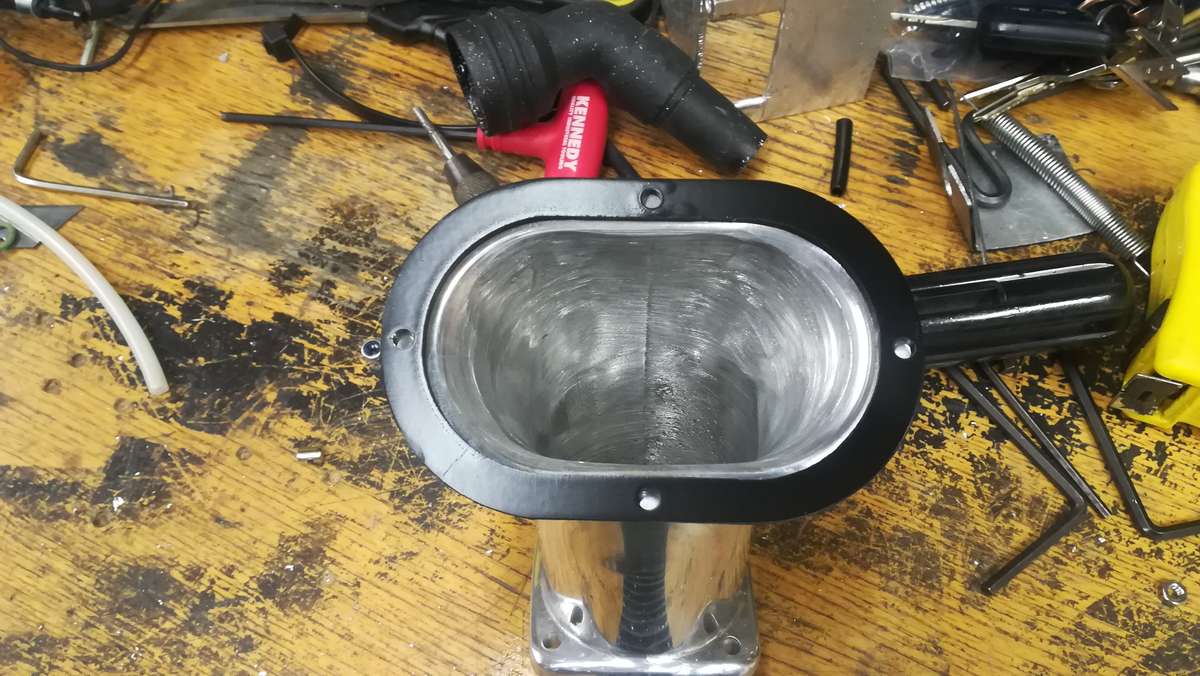

andybp Posted May 12, 2018 Author Share Posted May 12, 2018 people seem to run throttle bodies either without filters or with sock type filters which look like crap I think this looks better and no before someone asks they aren't the screws I'll be using 1 Quote Link to comment Share on other sites More sharing options...
Bakkums Posted May 13, 2018 Share Posted May 13, 2018 Looking good. Isn't it an idea to make a kind of intake box so hot air won't be entering the itb's? Saw this somewhere and thought this would really help the heatsoke problem. Just an idea Quote Link to comment Share on other sites More sharing options...
andybp Posted May 13, 2018 Author Share Posted May 13, 2018 On 13/05/2018 at 06:58, Bakkums said: Looking good. Isn't it an idea to make a kind of intake box so hot air won't be entering the itb's? Saw this somewhere and thought this would really help the heatsoke problem. Just an idea Expand yea I have a few things in mind for that but it will wait until I get it running properly Quote Link to comment Share on other sites More sharing options...
andybp Posted May 13, 2018 Author Share Posted May 13, 2018 Got the air filters sorted today I like it also took it for a quick spin up the road and back need to do lots of tuning 2 Quote Link to comment Share on other sites More sharing options...
