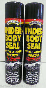

ZMANALEX Posted April 22, 2018 Share Posted April 22, 2018 This stuff is ideal for small items similar to what you are proposing to rust proof. It takes 24 hours to cure, but works a treat. Quote Link to comment Share on other sites More sharing options...
Guest Posted April 22, 2018 Share Posted April 22, 2018 Thanks Alex! Is that a permanent coating? I thought waxoyl was a temporary thing? Quote Link to comment Share on other sites More sharing options...
ZMANALEX Posted April 22, 2018 Share Posted April 22, 2018 Parmanent, as the Waxoyl is only an additive. We have found that once cured, it remains flexible and will not crack or peel. Quote Link to comment Share on other sites More sharing options...
Guest Posted April 22, 2018 Share Posted April 22, 2018 Great, thank you! I'll go pick some up =) Will it go over the top of smooth glossy surfaces or do I need to sand it a bit? Quote Link to comment Share on other sites More sharing options...
ZMANALEX Posted April 22, 2018 Share Posted April 22, 2018 Just follow the instructions on the tin. Quote Link to comment Share on other sites More sharing options...
