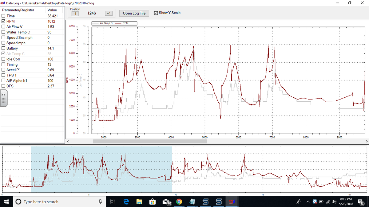

wizard Posted May 31, 2018 Share Posted May 31, 2018 (edited) Your drops are fantastic - I'm seeing similar numbers to what you were prior to your TS upgrade. What I realised was the faster and higher sustained RPM = higher AIT's. This is with the stock Vortech IC. See attached graph was taken on a 25c+ day recently. Edited May 31, 2018 by wizard 1 Quote Link to comment Share on other sites More sharing options...
jumping350 Posted June 3, 2018 Author Share Posted June 3, 2018 Great info above guys really interesting stuff, its crazy how ambient temp can make such a difference to the running and efficiency really hot days is a killer at the moment as I live in London and struggle to get enough air through the system at the best of times. but mild day and temps stay constant and in an area im happy with..will be an interesting summer 1 Quote Link to comment Share on other sites More sharing options...
