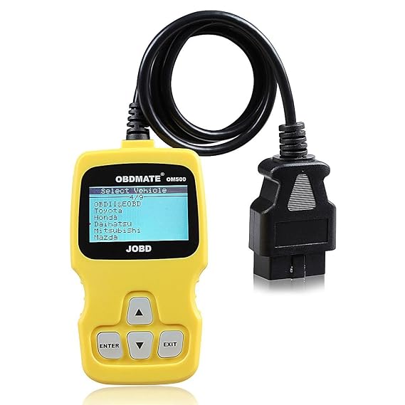

GrahameJ Posted April 11, 2018 Share Posted April 11, 2018 I bought one of these from Amazon, which is simple to use to read and clear codes using JOBD on JDM FairladyZ 350Z's: https://www.amazon.co.uk/Autool-Diagnostic-Scanner-Japanese-Vehicles/dp/B01M0I66MY/ref=pd_day0_107_4?_encoding=UTF8&psc=1&refRID=JG2FXEPW8GTC2AS7734R Autool OM500 JOBD/OBDII/EOBD Code Reader Auto Diagnostic Tool Engine Fault Scanner for Japanese Vehicles Price: £33.50 FREE UK delivery. RELATED VIDEOS 360° VIEW Quote Link to comment Share on other sites More sharing options...
nippeli17 Posted April 12, 2018 Author Share Posted April 12, 2018 yeap there is no problem reading fault codes by my own with autel maxidiag but mot needs to meet eu obd2 standards Quote Link to comment Share on other sites More sharing options...
