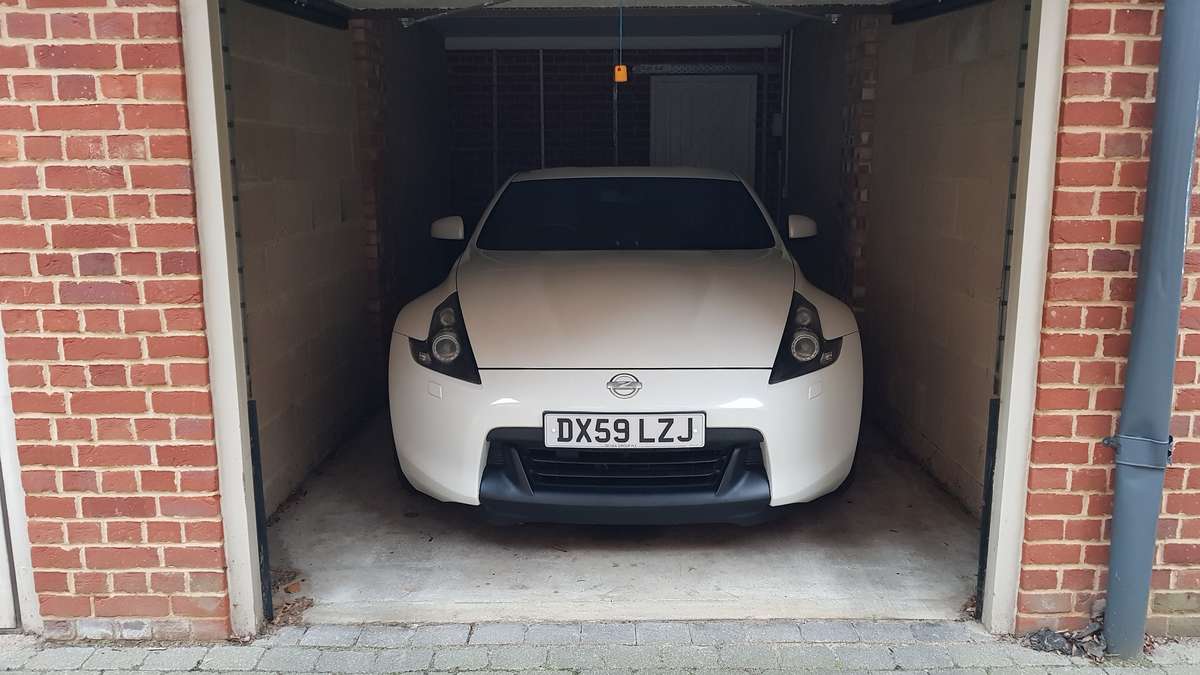

davidv10 Posted April 29, 2019 Share Posted April 29, 2019 Haha. No worries at all, ask away... I scraped out/off the old silicone and then basically went nuts with loads of replacement silicone sealant. The sealant i got was made for a glue gun holder, which made it very easy to apply into the crevices where the sealant goes. Just make sure you apply loads and almost go over the top with it and you will be fine. Then just reheat the edges and push the lights back together. Here is the finished product. I was very happy with the results. 3 Quote Link to comment Share on other sites More sharing options...

Silverthorn Posted April 29, 2019 Share Posted April 29, 2019 As @davidv10 has already said. Very easy to do if you fancy a bit of DIY. Start to finish it took me about a day to complete, although most of that was drying time. 2 Quote Link to comment Share on other sites More sharing options...

nissanman312 Posted April 29, 2019 Share Posted April 29, 2019 6 hours ago, Silverthorn said: As @davidv10 has already said. Very easy to do if you fancy a bit of DIY. Start to finish it took me about a day to complete, although most of that was drying time. They look good mate 1 Quote Link to comment Share on other sites More sharing options...
