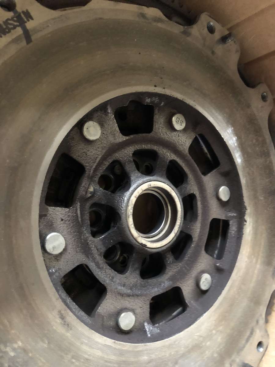

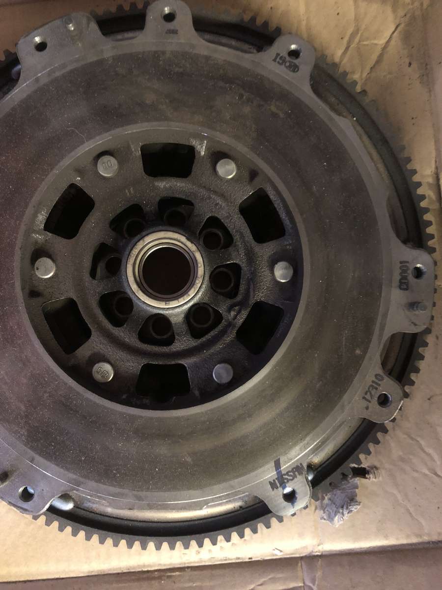

stirkac Posted April 4, 2018 Author Share Posted April 4, 2018 Yes it is factory installed kit. My mechanic confirmed that transmission has never been removed before. I've added a photo of all PNs, you can also see small LUK logo. By the looks, both clutch and transmission had low wear and no discoloration. That's as expected from previous owner usage, him having car since new and being over 50 years old. For what the price is for DMF (me being no professional) I think the quality is shoddy. "Burned" welds, casting marks everywhere and even a copper balancing weight on one side. For something worth £500, meant to be spinning at 7k RPM? Mine could have been just out of balance too, because I couldn't hear any noises related to DMF failure... Quote Link to comment Share on other sites More sharing options...
