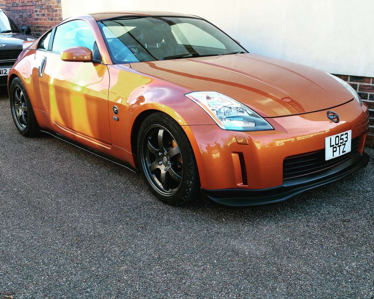

Hey guys just joined I own a sunset orange 350z , just bought some 720 wheels for the front they are 18×9.5j with et15 and 18×10.5 j et 15 for the rear but having trouble with clearing the brembo calipers and I don't know if when I do lower the car what is the best way to go do I need to roll the arches ? Thank you in advance also this is my zed

Whats the question here? If your wheels don't clear your calipers and you want to stick with em, your only option is to space them out until they clear. Then you'll have to deal with whatever that does to the wheel poke when you get to it.
How much extra do you need to clear, 9.5 et15 on the front is pretty much the limit anyway, if you roll the fronts, you wont really be able to use your arch liners if i remember right and by the look of those Rays i reckon they are running spacers anyway.
