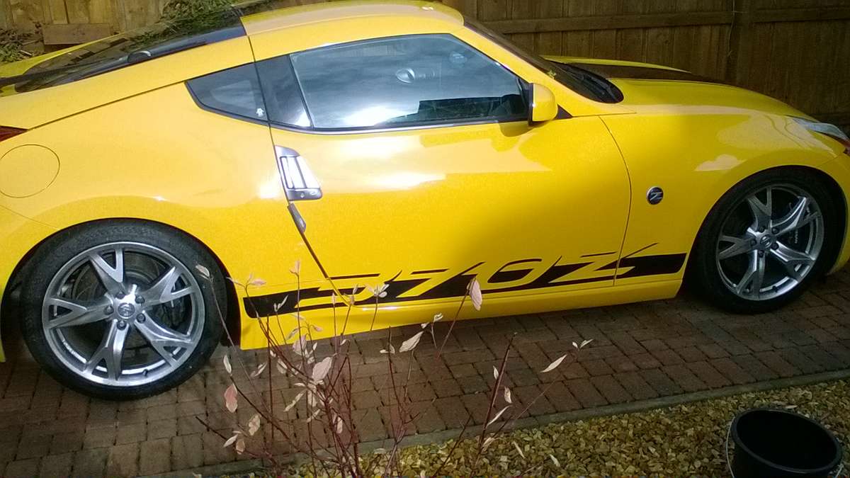

nissanjuke Posted February 19, 2018 Share Posted February 19, 2018 I have dropped my gt by 25mm with the Eibach kit, can you use wheel spacers with this kit? Quote Link to comment Share on other sites More sharing options...
nissanjuke Posted February 19, 2018 Share Posted February 19, 2018 below is a picture with new springs Eibach Quote Link to comment Share on other sites More sharing options...
mattross1313 Posted February 19, 2018 Share Posted February 19, 2018 36 minutes ago, nissanjuke said: I have dropped my gt by 25mm with the Eibach kit, can you use wheel spacers with this kit? Yes bud. Stock GT body and wheels are fine. I ran eibach lowering springs and 25mm spacersx4 without issues. Sits really nice. Issues arise however with the Nismo Quote Link to comment Share on other sites More sharing options...
nissanjuke Posted February 19, 2018 Share Posted February 19, 2018 cheers Quote Link to comment Share on other sites More sharing options...
nissanjuke Posted February 19, 2018 Share Posted February 19, 2018 whos the best for spacers?? Quote Link to comment Share on other sites More sharing options...
