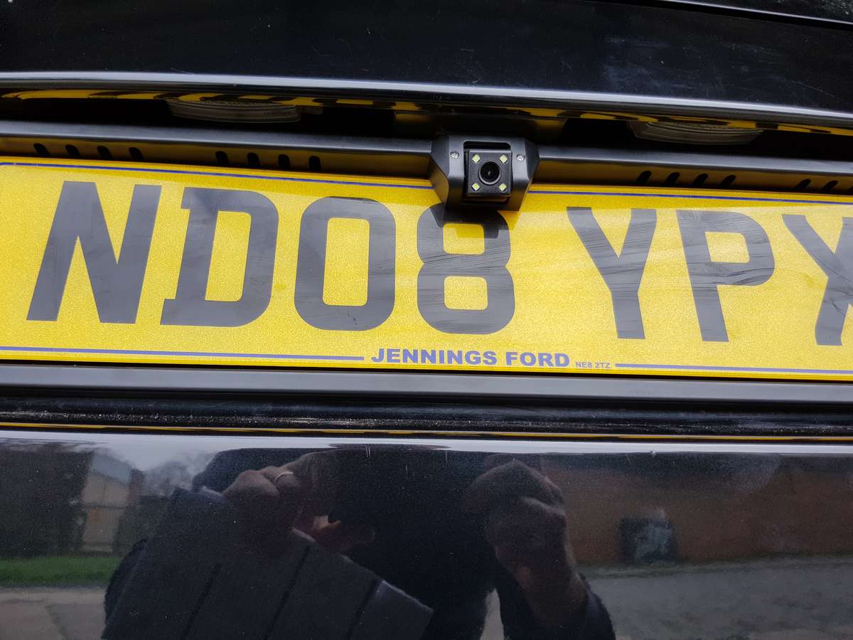

ouro Posted April 14, 2018 Share Posted April 14, 2018 Got mine in and working great but I have dropped a clanger with my reversing camera. The picture etc. is smashing, but the camera sits directly below (and completely covers) the boot release. I can open it by sliding a screwdriver in, but that isn't really a solution.. I have seen that some Z owners have a fob with a boot release button, but I only have the key with lock/unlock. Can anyone suggest a workaround? I really don't want to pull it apart again. Quote Link to comment Share on other sites More sharing options...
