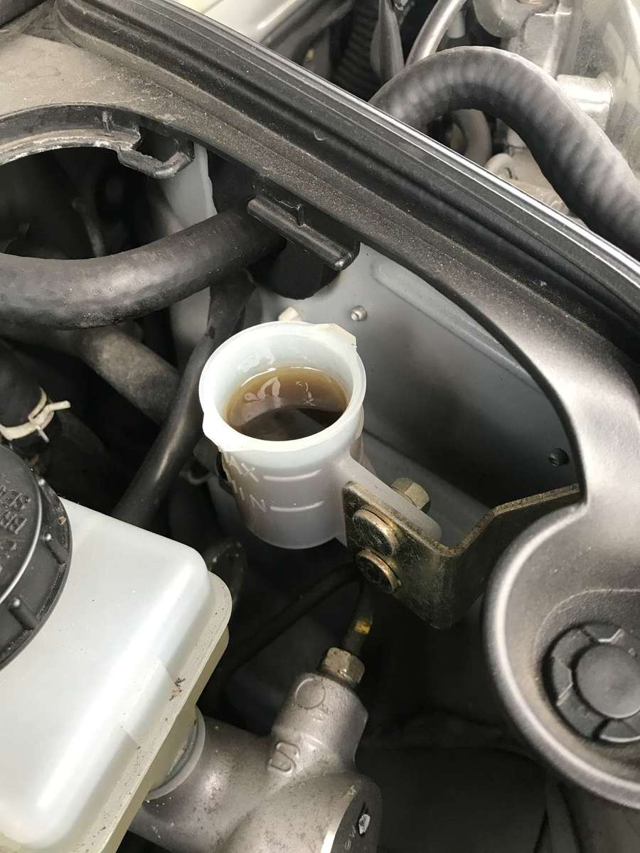

Lifesabeach26 Posted January 17, 2018 Author Share Posted January 17, 2018 Thanks for the advise - you’re right I’m definitely not a DIY when it comes to cars. However, got a mechanic mate coming over Saturday to take a look at it. Fingers crossed it’s a small pay out Quote Link to comment Share on other sites More sharing options...

Rob332 Posted January 19, 2018 Share Posted January 19, 2018 22 hours ago, zedz said: Alas, gearbox oil does tend to get overlooked, perhaps because it is not in your face when you open the bonnet like the engine oil dipstick is. so the problem could be an easy fix. I wouldn't suggest it would be an easy fix if lack of oil has caused the fault. You would be looking at an overhaul or new gearbox based on the symptoms described by the op. Quote Link to comment Share on other sites More sharing options...
