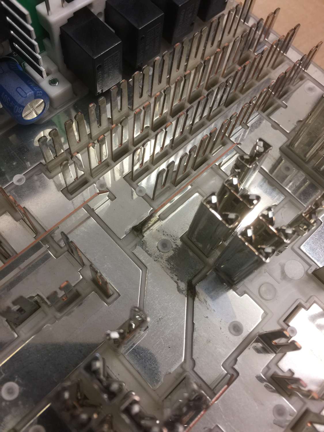

Somadoc Posted December 20, 2017 Author Share Posted December 20, 2017 Hi Junkyardbear. Here’s where we are so far! Auto electrician removed the aftermarket immobiliser to start with but this didn’t sort out the weird electrics so he took the ipdm apart to discover it had been historically water damaged and shorted out at the ecu and fan relays, so I’m trying to source a replacement ipdm. Next he’s taking the body control unit out and checking that. Hopefully it’ll be ok and the ecu as my bills are mounting already and I’ve only driven the car for 30 minutes!! So old damage that incredibly manifest heavily within a day of my ownership and as a result of the battery flattening overnight??? Looks like the central locking module had some moisture issues too. I’ll update again when I know more. And thanks for the ‘heads up’ Payco, I look forward to attending something in the SE. Quote Link to comment Share on other sites More sharing options...

Somadoc Posted December 21, 2017 Author Share Posted December 21, 2017 Thank you Payco. I sourced one off of EBay yesterday and will see if this works. I hope a BCM and ECU are not needed and will communicate with Zmanalex for future bits. 1 Quote Link to comment Share on other sites More sharing options...
