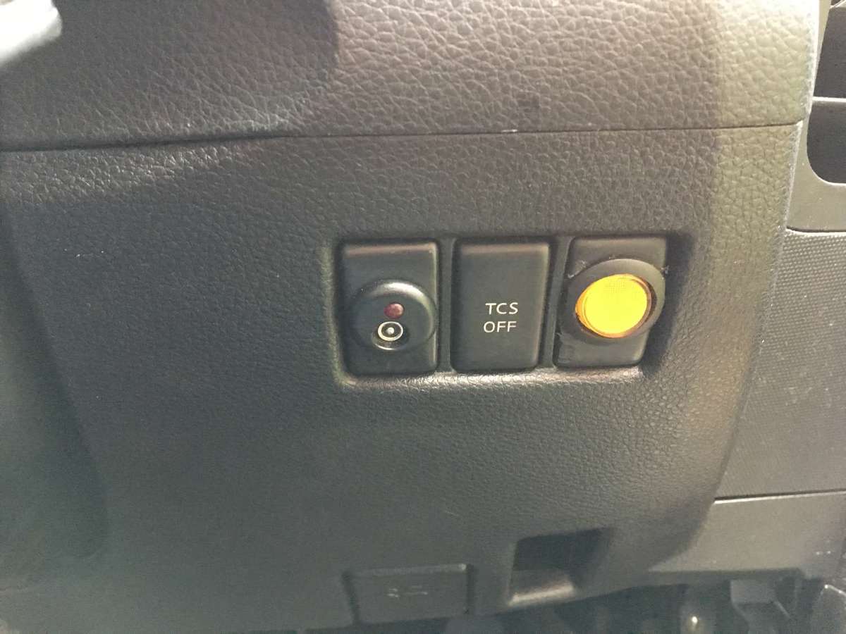

nharrison2012 Posted December 9, 2017 Share Posted December 9, 2017 Hi, just wondering if any of you guys could help me with an issue i have, the tcs off light and the slip light are permanently on and pressing the tcs off button doesnt seem to do anything, its a new car i got recently, the previous owner was considering drifting it but changed his mind, maybe he’s disabled the traction control?? Any ideas? Also i spotted this loose cable behind the panel, anyone know where its meant to plug into? Thanks Nick Quote Link to comment Share on other sites More sharing options...
Kieran O'Quick Posted December 9, 2017 Share Posted December 9, 2017 You could check the three connection blocks near the brake fluid reservoir to make sure they're all plugged in. Don't know what the picture is of. Quote Link to comment Share on other sites More sharing options...
nissanjuke Posted December 9, 2017 Share Posted December 9, 2017 is your car a 350z Quote Link to comment Share on other sites More sharing options...
ZMANALEX Posted December 9, 2017 Share Posted December 9, 2017 It is a JDM 350Z and the car is running without the VDC fuse Quote Link to comment Share on other sites More sharing options...
