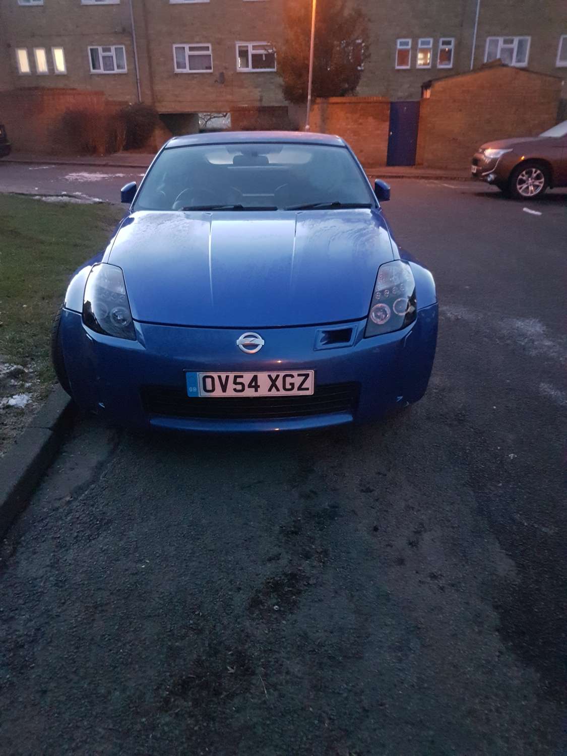

Yenyaw Posted December 28, 2017 Author Share Posted December 28, 2017 So i have an 8 pin, damn, need to find a way to do this now Quote Link to comment Share on other sites More sharing options...
Yenyaw Posted December 28, 2017 Author Share Posted December 28, 2017 Quote Link to comment Share on other sites More sharing options...
Erni902 Posted December 29, 2017 Share Posted December 29, 2017 If you dont want the indicator on with the side lights there is a wire you snip. Not got the exact same lights but I had this when I fitted aftermarket lights to mine. There is a wire that goes from the sidelights to the indicator bulb, snip this and you should be golden. Plenty of youtube videos that show this aswell. Looking good though man, look good on your colour car Quote Link to comment Share on other sites More sharing options...
Yenyaw Posted December 29, 2017 Author Share Posted December 29, 2017 Top man, im guessing its the white wire then as that leads from indicator to the LEDs and Halos Quote Link to comment Share on other sites More sharing options...
