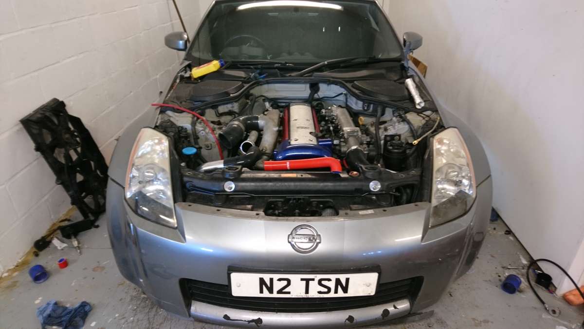

Ross k Posted June 4, 2018 Author Share Posted June 4, 2018 Update been cracking on fuel lines are done wiring is done and earth's done. Been working on the vacuum pipes so far replaced all the inlet pipes also connected the coolant pipes up to the Heater matrix. After that I started mocking up the intercooler and made a start on the intercooler piping looks like I'm going to have to get a new washer bottle and I worked out the brackets I need to make to hold the rad and intercooler anyway heres a few pics Quote Link to comment Share on other sites More sharing options...

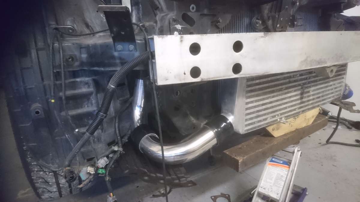

Ross k Posted June 10, 2018 Author Share Posted June 10, 2018 Well a fairly successful weekend on the zed got the intercooler mocked up in the correct position finished making up the intercooler pipes. After that I made up some brackets to hold the intercooler and some brackets to hold the top of the rad Quote Link to comment Share on other sites More sharing options...

Ross k Posted June 26, 2018 Author Share Posted June 26, 2018 Cheers 350z butcher been keeping an eye on your thread aswell all those track days look great fun. Anyway another weekend more progress painted the intercooler brackets and rad brackets, after this is put the front end back together for the final tim and did the intercooler piping, so far so good.Next I tackled the throttle cable which is done and went fairly well using an s13 pedal. Roll on the next day and it just didn't go well spent about two hours trying to bleed the clutch before giving up it just wasnt happening so I'm going to try fitting a new slave cylinder and line. Hopefully this will sort my problem anyway heres a few pictures. The list of jobs Is getting smaller I have to put the new fuel pump in and modify the basket, buy some new slim remotec fans so I can run a pull system and fit some turbo gasket then it should be test fire time 1 Quote Link to comment Share on other sites More sharing options...

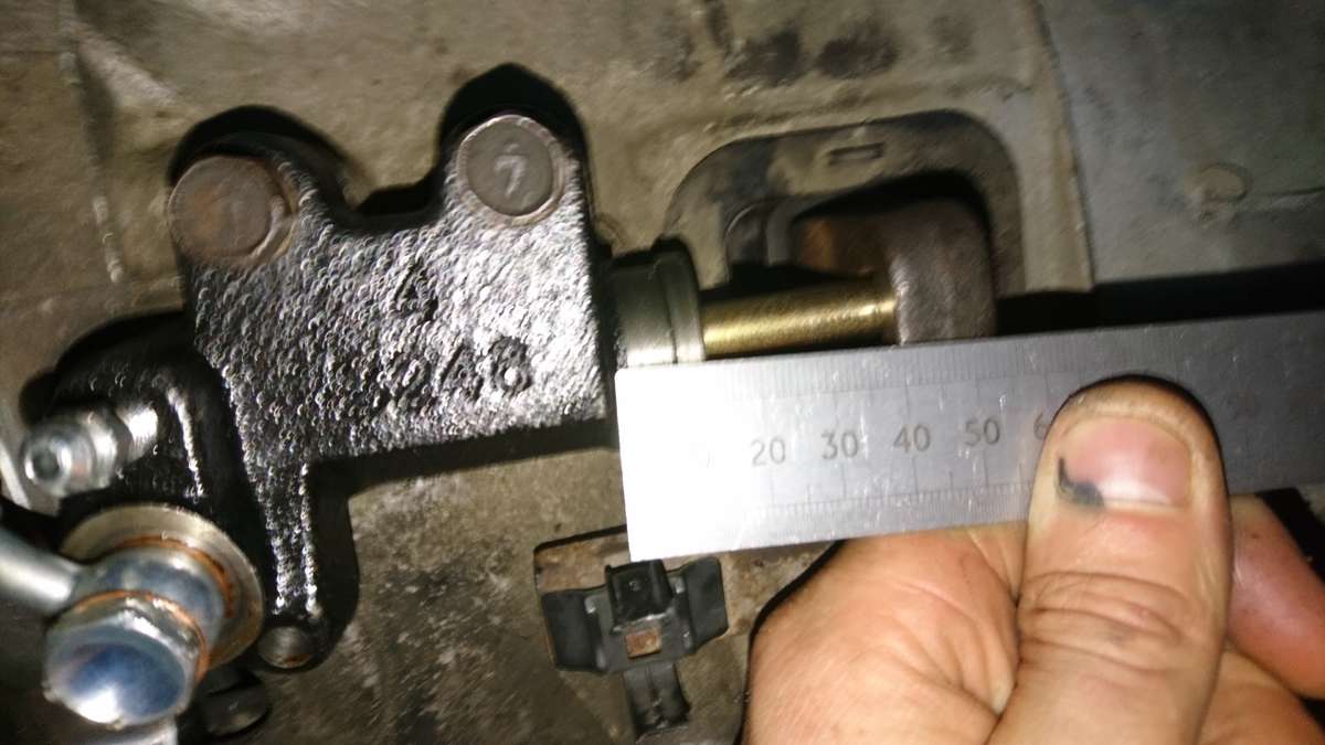

Ross k Posted August 1, 2018 Author Share Posted August 1, 2018 Few more updates fitted a new master cylinder I now have half the pedal back but it still won't return after half way we also tried making a slave cylinder extension but that also failed I'm a little lost now as to what this could be and about 2 days of bleeding in total getting fed up with lieing under the car Quote Link to comment Share on other sites More sharing options...
350Butcher Posted August 1, 2018 Share Posted August 1, 2018 Its not that the bell housing adapter plate is too thick and so you're not getting full disengagement of the clutch and therefore not full return on the pedal? Quote Link to comment Share on other sites More sharing options...
Ross k Posted August 1, 2018 Author Share Posted August 1, 2018 I spent quite a while working out the throw and it should work OK I had to space the pivot ball in the gear box out with an extra washer to get 5mm extra forward throw but with the custom flywheel their wasn't a massive difference I think I'm still having bleeding issues thanks for the help Quote Link to comment Share on other sites More sharing options...
Daisyduke Posted August 1, 2018 Share Posted August 1, 2018 Is there a massive difference in master cylinder size between the 350 and supra/chaser or whatever the donor was? Quote Link to comment Share on other sites More sharing options...
Ross k Posted August 1, 2018 Author Share Posted August 1, 2018 The car is running a 350z gearbox with a 350z clutch so the clutch system is only using 350z parts thanks for the thoughts though Quote Link to comment Share on other sites More sharing options...

Ross k Posted August 5, 2018 Author Share Posted August 5, 2018 Only around stock to start with about 300 but it will have the same torque at 2500 revs as a de at 6000 so it should be noticeable and around 450 one day :). Anyway more clutch bleeding and it still won't work correctly I've come to the conclusion my calculations must have been of when working out the throwout bearing reach. I needed 6mm extra reach and added one extra washer under the pivot ball to allow more throw. I could really do with a favour if someone could nip under their car and measure the distance from a point on the slave to the clutch fork with the pedal up that would be amazing as this gives me a stock measurement to compare mine to I have shown a picture of mine Quote Link to comment Share on other sites More sharing options...
