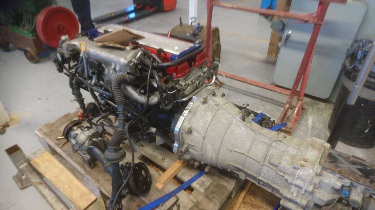

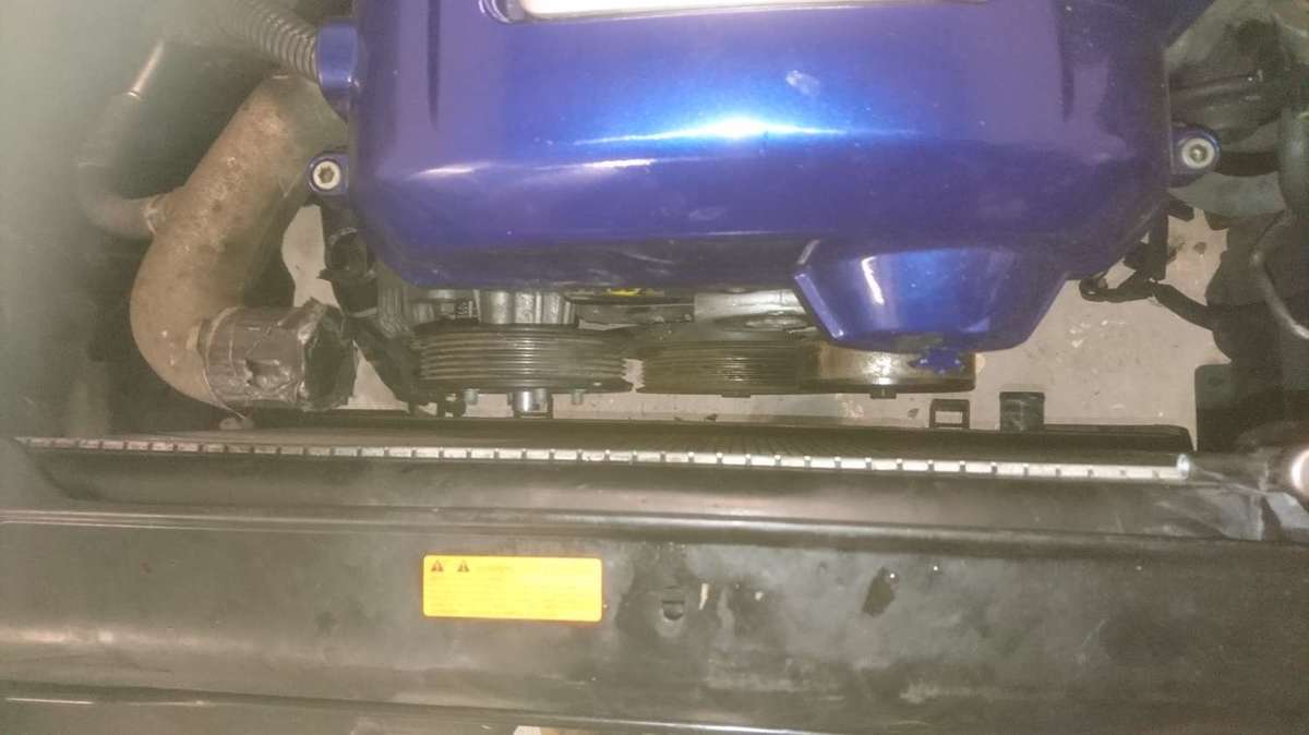

Ross k Posted February 4, 2018 Author Share Posted February 4, 2018 Update been a busy weekend firstly set about getting the engine out which went fairly well except I squashed the power steering pipe doh!!. Next was to remove the gearbox which all went well turned out the car had a nearly new exedy stage 1 organic clutch fitted. After that I got the gearbox bolted to the jz excuse the array of different bolts I am only using these to test fit the engine. After that I tried it in on standard mounts which were to narrow I enlarged the slots on the crossmember a little. This meant it sat in the car and the engine fits fine and the gearbox fits in the tunnel!. It sits fairly close to the rad but I'm going to make some plates up to move the engine back another inch or so as I dont really want to cut into the crossmember underneath Quote Link to comment Share on other sites More sharing options...

350Butcher Posted February 4, 2018 Share Posted February 4, 2018 (edited) Great build you're starting here! Will be following your progress so keep the updates coming Regarding radiators, Mishimoto is a real no no! I'd stick with stock unit over it, they're very poor quality and not up to the job, will give you problems down the road for sure. Koyo Rad would be my recommendation, great quality and performance. Had one on my 420hp Evo 5 for years so fitted one to my 350z I have now when the time came. Think they offer 2 core sizes for the DE too so might be worth going with the thicker (36mm from memory) given your future plans for power levels. On a point you mention about making up some plates to move the engine back a little further, I think you'll be reaping the rewards of making efforts to get it as far back in the engine bay as possible given the amount of cast iron / weight out front that's got to effect the handling when finished. The Supra engine is a great choice though, easy power and an awesome sound track!! Edited February 4, 2018 by 350Butcher Quote Link to comment Share on other sites More sharing options...

Ross k Posted February 4, 2018 Author Share Posted February 4, 2018 Cheers for the advice guys I've already ordered the wiring loom from wiring specialists and they are making it as we speak Mark so hopefully should be plug and play :). I will be moving the engine back as far as I can 350 butcher but I don't think I'll get it more than 1 inch further back due to the sump hitting the cross member and the gearbox fouling the transmission tunnel most people who do the swap in this country use a BMW box as its smaller but I was keen to retain the 350z box I think the gearbox will end up around 4 inches further back than normal thanks Ross Quote Link to comment Share on other sites More sharing options...
Ross k Posted February 10, 2018 Author Share Posted February 10, 2018 (edited) One Step forward two back pulled the engine back out today in an attempt to move the engine further back. lookslike I will only get it around 25mm further back max if I make a set of custom mounts I'm debating wether in the real world it would be worth all the extra effort for 20-25mm the gearbox already sits 150mm further back in the tunnel than original. On the plus side the wiring loom has arrived from America and looks great.Can anyone shed some light on what the parts in the attached picture are I'm guessing the fuel pressure regulater and? Any help would be appreciated sorry about the bad pics both are under the inlet manifold and fuel related pics of the loom to follow thanks Ross Edited February 10, 2018 by Ross k Quote Link to comment Share on other sites More sharing options...
