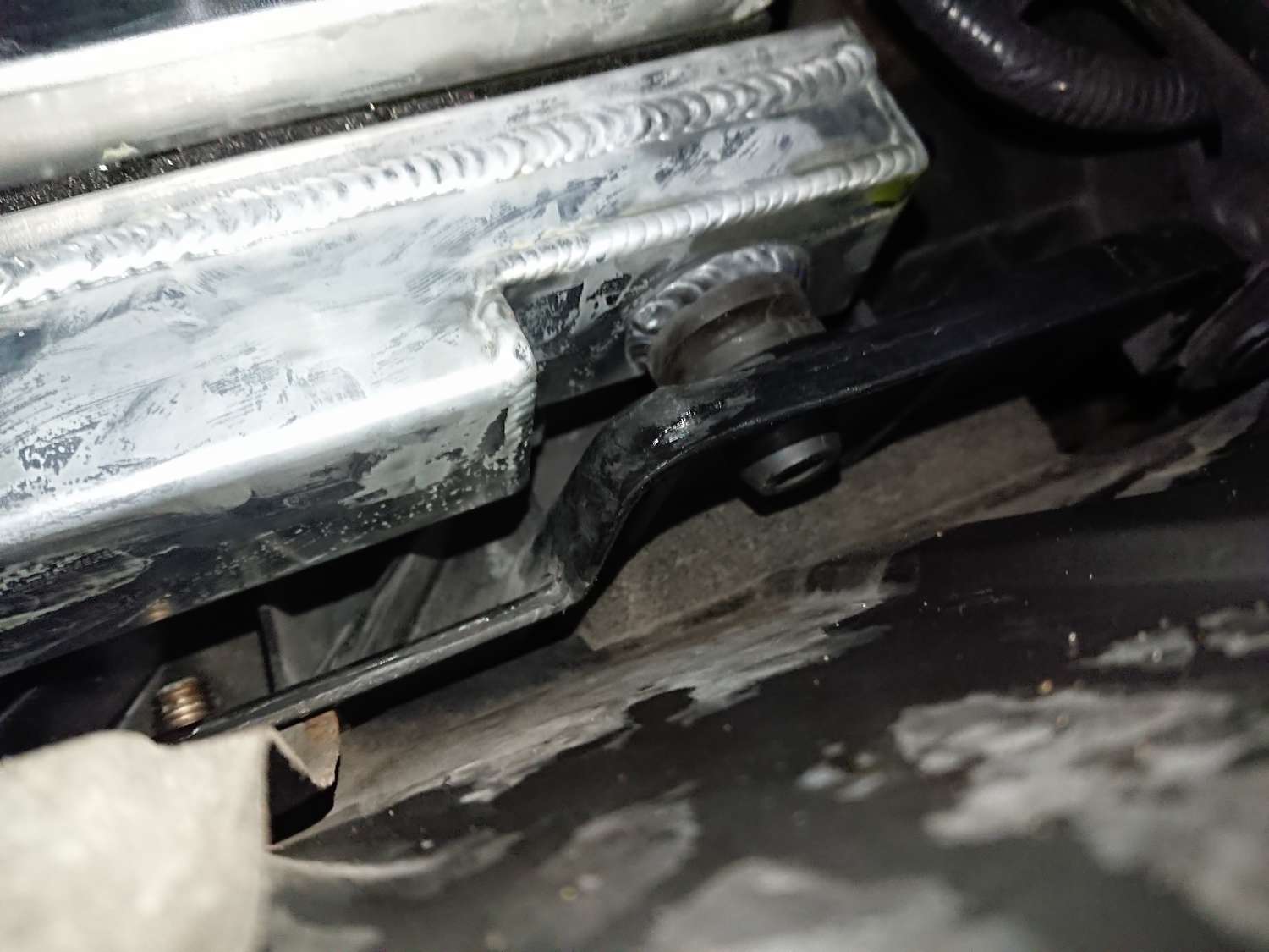

ThreeFiddyZ Posted November 29, 2017 Share Posted November 29, 2017 Recently replaced my oem radiator with a Mishimoto Aluminum Performance Radiator and after less than 2000 miles its developed a pinhole leak under hot pressure from a weld near the end tank. Do they not pressure test these radiators as part of QC? I get the feeling that they aren't manufactured very well, as the fitment was also poor! Whilst I wait for a response from Mishimoto regarding a warranty claim, I'm pretty disappointed for a £300 radiator. What are others experiences with the Mishimoto Radiator? I'm running it in conjunction with a Mishimoto Fan Shroud. Quote Link to comment Share on other sites More sharing options...

ThreeFiddyZ Posted December 1, 2017 Author Share Posted December 1, 2017 (edited) UPDATE: So after chasing Mishimoto support myself, and resending pictures of the leak and the Radiators serial number, Mishimoto have confirmed that they cannot get a new radiator to me until the 31st January 2018, as the radiator is out of stock. The suggestion in the meantime from Mishimoto is to add the Mishimoto stop leak product to the radiator to stop the leak for now . Although they are offering this for free, and adding it would not void the warranty, for the sake of their faulty radiator, I'd rather not risk a blocked heater matrix or a blocked cooling jacket! Whilst I appreciate the effort, I'm going to ask for and review any other options they can give me. However, I suspect that if I request a refund they won't process this until they receive the faulty radiator back, which means over a week with the Zed on the driveway with no radiator before I can even order an alternative I hate to slate vendors, but had this radiator been subject to proper QC, they could have identified this before it was shipped!! Would not recommend. Edited December 1, 2017 by ThreeFiddyZ Quote Link to comment Share on other sites More sharing options...
