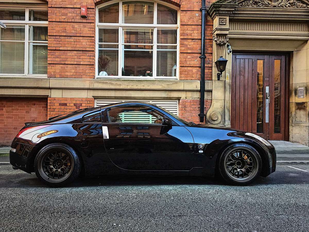

KuroKiddo Posted November 29, 2017 Share Posted November 29, 2017 (edited) Had the car since 2014 been meaning to do a build thread for a while, at the time when I was looking for a new car I was looking for something with a nice sounding engine, rear wheel drive and got to look good! And the 350z fit the bill perfectly, S2000 was another option but for some reason I never really got on with Vtec, guess I'm lazy and like torque too much! Anyway first thing I did as with most was to get a shorten Honda aerial, then I had the Rays painted Satin Black, not a choice of finish I would do as the paint would easily chip, powder coating was much better. Edited November 29, 2017 by KuroKiddo Quote Link to comment Share on other sites More sharing options...

KuroKiddo Posted November 29, 2017 Author Share Posted November 29, 2017 (edited) Clutch was beginning to slip at 90k miles so a quick order from Clarke Motorsport got myself sorted out with a Xtreme Orgainc clutch and lighten flywheel, also been waiting for some new wheels and decided on some Rota MXR in 10x18 et7 and 11x18 et12, got lucky with them as I saw a pair of 10x18 2nd hand for sale quite locally and then a month later a pair of 11x18 pop up nearby! Result! Got them refurb and powdered coated in Satin Bronze which goes well with the black paintwork. New wheels meant new tyres, I wanted a square set up, but at the same time I don't want to upset the VDC as I leave that on for cold rainy days on the motorway so I settle on 255/35/18 and 265/35/18s, this was going to be a gamble as I can't find anything concrete on whether that size runs well with the VDC, but happily it pays off as the car runs fine with those tyre size. I wanted tyres that are more focus and didn't want soft sidewalls and don't turn to mush after a few laps, so that rule out the popular MPSS, originally wanted to get the Yokohama AD08R but looking further into it there's some rave reviews on Nangkang NS2R, the yokos cost nearly twice as much and I don't think I'm chasing every last second so I thought I'd try them out! Seems great to me at the price and wraps around the wheels perfectly, just a little bit of stretch but not too much and fill those arches well once lowered! But looked like a lifted zed with the OEM suspension. Edited November 29, 2017 by KuroKiddo Quote Link to comment Share on other sites More sharing options...

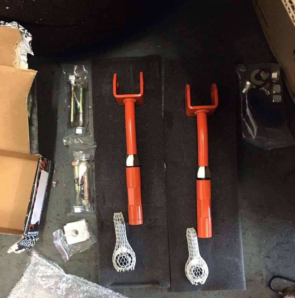

KuroKiddo Posted November 29, 2017 Author Share Posted November 29, 2017 (edited) Suspension time! After having coilovers on previous cars which was far too hard for our roads here I gone for a set of BC BR Coilovers with 8/6kg spring rate rather than the usual 10/8kg, as last thing I want is bouncy ride which totally ruins the car, as I figure I want the car to ride well and if I were to control the roll I would just upgrade the anti roll bars anyway. So a trip to Area Motorsport to install the coilovers, driftworks camber arms, SPC toe bolts and SPL lockout kit together with setting the alignment and rolling the rear arches. The car rides unbelievably well, just feels like a well set up car to live with compare to hard crashy rides associated with modded cars, would highly recommend 8/6kg spring rates for anyone looking to upgrade their suspensions! Edited November 30, 2017 by KuroKiddo Quote Link to comment Share on other sites More sharing options...

Vid Posted June 16, 2018 Share Posted June 16, 2018 Very, very nice. Love those wheels. Did you have to roll your arches with that offset? Quote Link to comment Share on other sites More sharing options...
KuroKiddo Posted July 8, 2018 Author Share Posted July 8, 2018 Front was fine the rear was rubbing over bumps before I had the arches rolled Quote Link to comment Share on other sites More sharing options...
