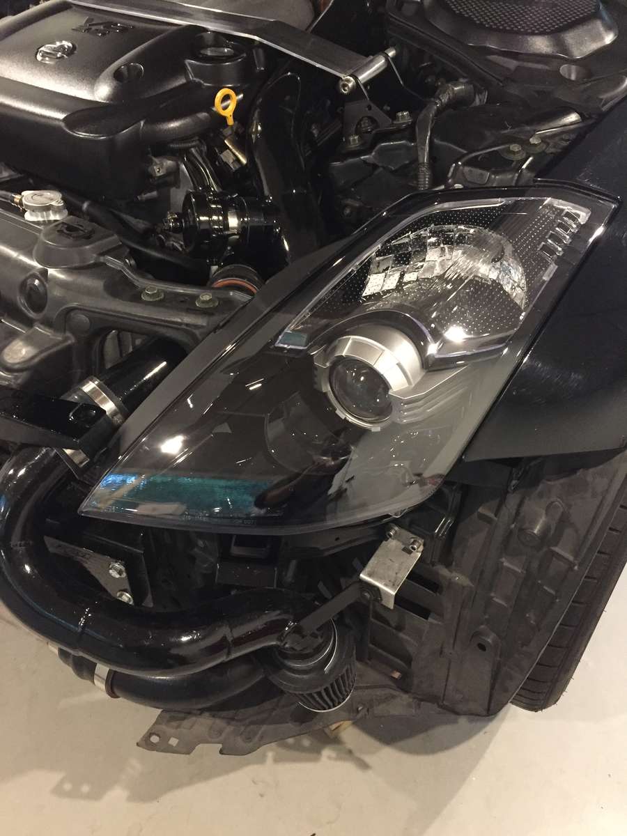

also swapping out the headlights for Black depo.

Also fitted some new osram nightbreaker hid's in the new depo front lights. No point in not putting in some decent bulbes when it's all apart anyway.
