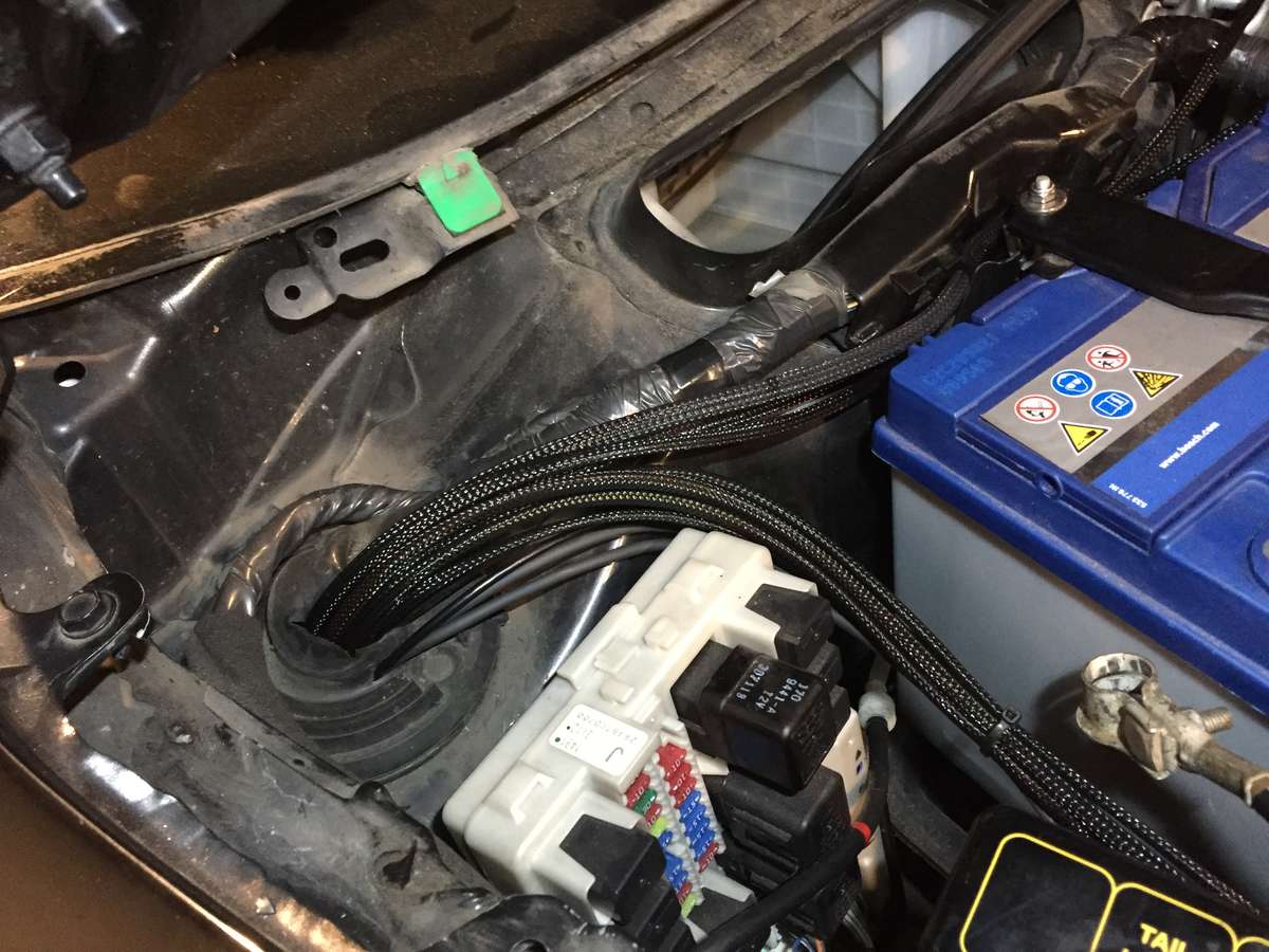

Ortega_9 Posted May 19, 2018 Author Share Posted May 19, 2018 Just started doing up the last wireing for the new harness. Pulling wires to and from the ecu... Then the ecu install is done. then Next, the "hardwire" for the new fuel pump. It draws quite alot more than Stock, so wireing, fuse, relay etc. Must be upgraded. 1 Quote Link to comment Share on other sites More sharing options...

Ortega_9 Posted May 28, 2018 Author Share Posted May 28, 2018 Just started on the "hardline" wireing for the fuel pump. The power will be drawn through a 4mm2 cable with a 30 AMP fuse to the battery. Run through a Nissan relay that will be placed in the vacant spot in the relay box for the lamp washer. also started fitting some 2" aluminium pipe and my Screw cap for the new radiator overflow tank. Quote Link to comment Share on other sites More sharing options...

Ortega_9 Posted May 29, 2018 Author Share Posted May 29, 2018 3 hours ago, wizard said: Did you have to buy the wiring and relays separately for the hardwire? Having a look at fuelab as well as aeromotive 340 at the moment. I had everything laying around. the relay is from an "old" s13. It fits almost all Nissan relay boxes. but you Can buy complete "hardwire" kits with cable, fuses and relays. and i'm having issues working out how to Secure the pump in the hanger.... without zipties... so not there yet, but close. if you need the fuel from a 340 pump. I Would suggest buying a model specific fitting kit and another one than the fuellab... the fuellab will Deliver alot more fuel than other pumps, but is a pita to fit. so far, that is, if/when i solve it, I'll post my take on it. And also it needs bigger than Stock wireing. It draws almost 15 amps (witch i belive is Stock max) at just around base fuel pressure. So pretty High output and power usage. i originally planned on doing a whole new hanger with fuel return etc. But that will have to wait now, as i just want to get the car on the Road... 1 Quote Link to comment Share on other sites More sharing options...
