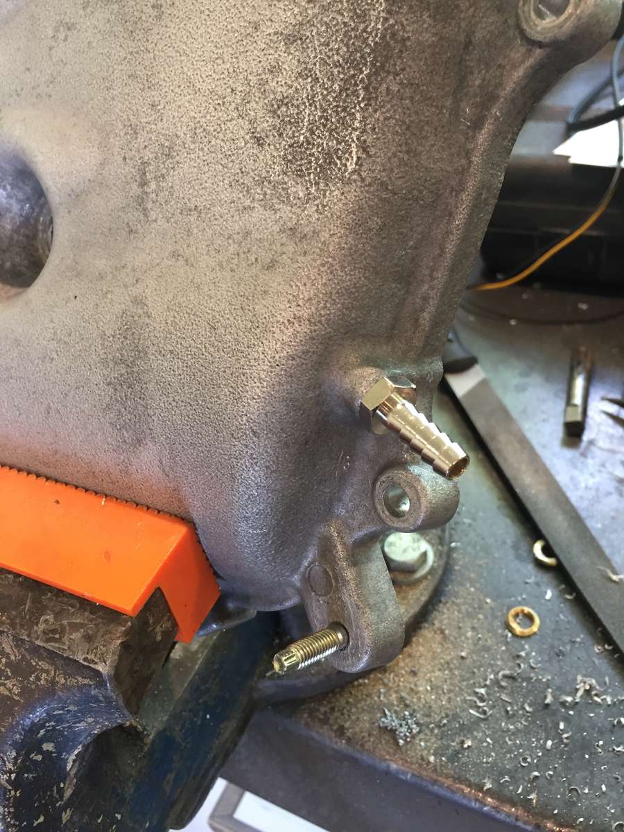

Ortega_9 Posted May 13, 2018 Author Share Posted May 13, 2018 Just pulled the top of the plenum as i wanted to fit a bigger port for the map sensor aswell as for the bov vacum. and also fitted the air temp sensor in the intake pipe of the plenum. and last i blocked the water Lines running to and from the throttle body, as i'm never gonna run the car in the winter, and i have a fealing it's gonna get hot enough without having the warm coolant running through. Quote Link to comment Share on other sites More sharing options...
Ortega_9 Posted May 13, 2018 Author Share Posted May 13, 2018 And back together, now with fuel press sensor, map sensor, air temp and the bigger vacum ports. now i need to do the Oil press and temp sensors, aswell as the wideband o2 sensors for the infinity... Quote Link to comment Share on other sites More sharing options...
andybp Posted May 13, 2018 Share Posted May 13, 2018 (edited) is that swarf around the air temp sensor you don't want that getting in the engine Edited May 13, 2018 by andybp Quote Link to comment Share on other sites More sharing options...

Ortega_9 Posted May 14, 2018 Author Share Posted May 14, 2018 7 hours ago, andybp said: is that swarf around the air temp sensor you don't want that getting in the engine It's a piece of ptfe tape, it was pulled of before putting it back together. Quote Link to comment Share on other sites More sharing options...
