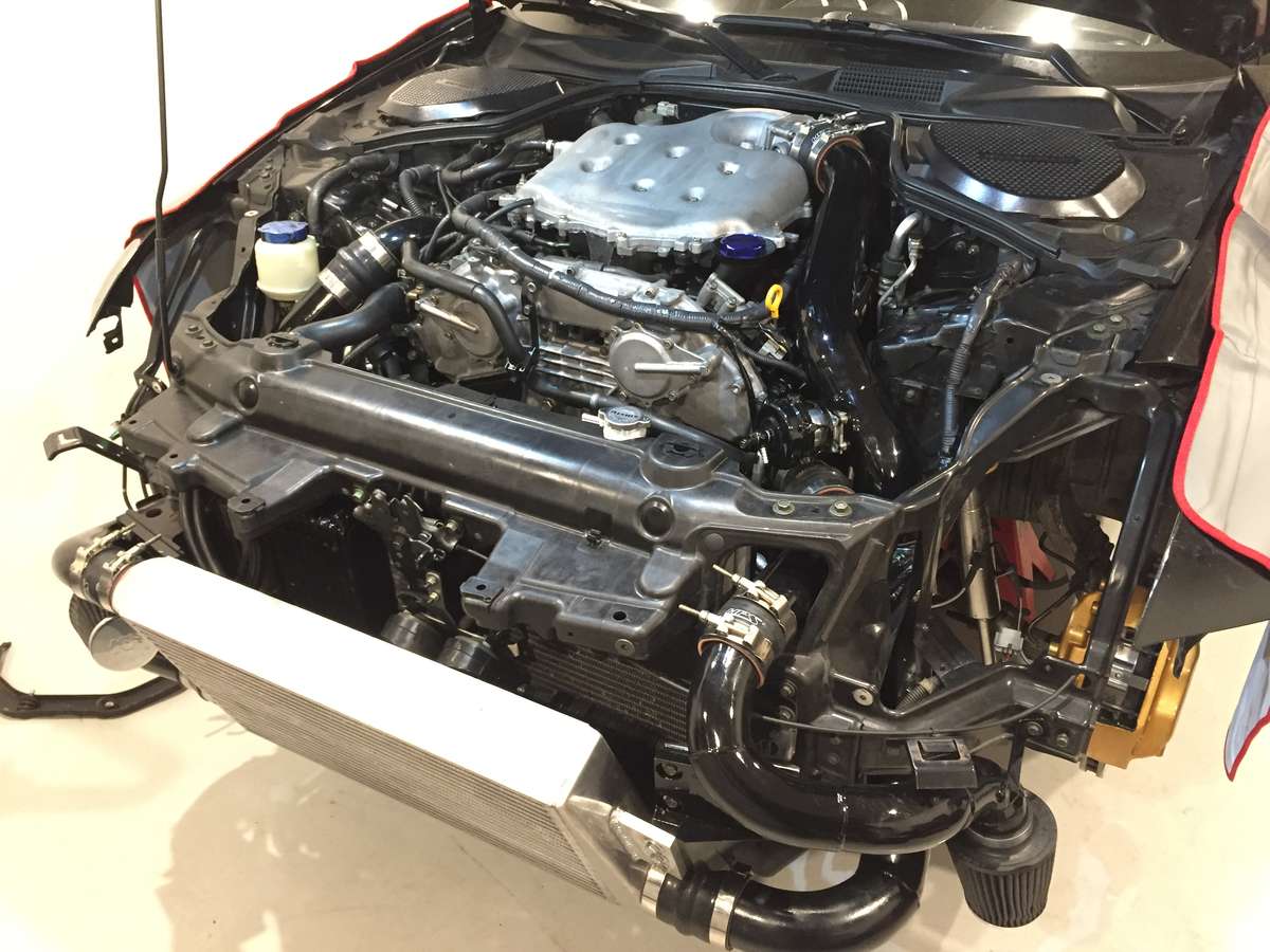

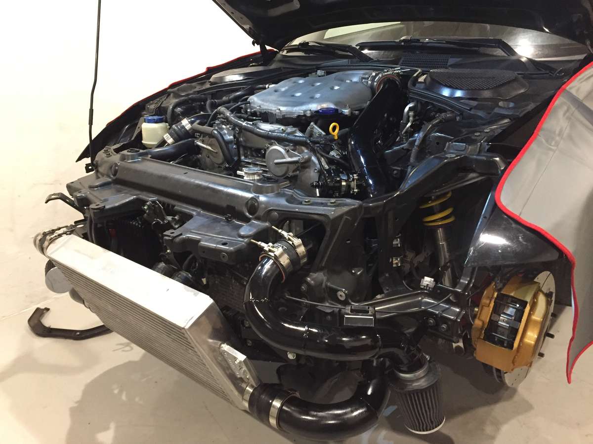

Ortega_9 Posted March 14, 2018 Author Share Posted March 14, 2018 Just Got the last pieces of pipe on today, so all done up top. tryed fitting the bumper, but i can see that the nozzle for the front light washer is in the samt place as the intake pipeing. So the headlight washer gotta go.... Quote Link to comment Share on other sites More sharing options...

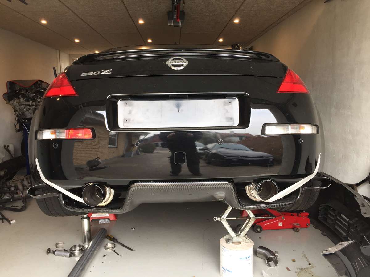

Ortega_9 Posted March 16, 2018 Author Share Posted March 16, 2018 (edited) And then the exhaust showed up... i need some more pipe end bends... but I'll order as it comes along Edited March 16, 2018 by Ortega_9 1 Quote Link to comment Share on other sites More sharing options...

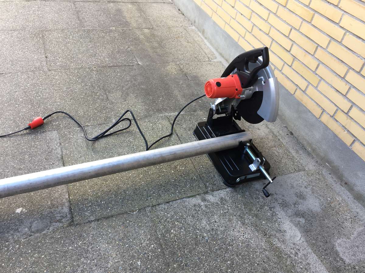

Ortega_9 Posted March 17, 2018 Author Share Posted March 17, 2018 Had a few hours to get started today. I Think i'm gonna Stick with a true Dual 3". So cut some pipe, set flanges where they need to be and started messuring and tacking the first few bits together. Just finished welding the first piece now. Quote Link to comment Share on other sites More sharing options...
Ortega_9 Posted March 19, 2018 Author Share Posted March 19, 2018 Some more progress. i'm using the AAM Dual 3" for inspiration. As it's a proven performer on FI Z'ds 1 Quote Link to comment Share on other sites More sharing options...

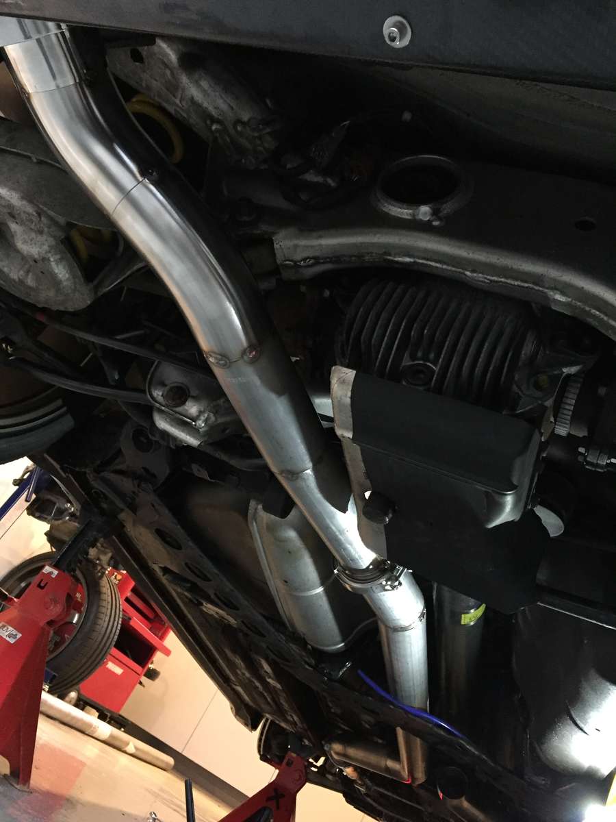

Ortega_9 Posted March 24, 2018 Author Share Posted March 24, 2018 Trying to get the ends to meet, and get this muffler sitting pretty... and also leaving room to move about abit AND look the part with the difuser Quote Link to comment Share on other sites More sharing options...
Ortega_9 Posted March 24, 2018 Author Share Posted March 24, 2018 Muffler tacked up with Mount and rear axel bends Quote Link to comment Share on other sites More sharing options...
Ortega_9 Posted March 24, 2018 Author Share Posted March 24, 2018 A few pie cuts and v-band. Quote Link to comment Share on other sites More sharing options...

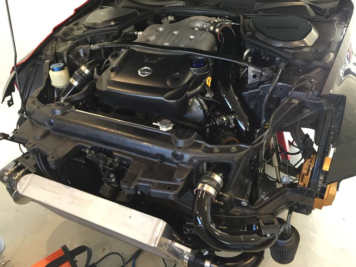

Ortega_9 Posted April 2, 2018 Author Share Posted April 2, 2018 So having done the left side exhaust and beeing going at it on the right side, aswell as cleaning a bit up in the engine Bay. i'm not sure, but i Think i want to go with the engine cover again, as i kinda like the clean and more stockish look. also ordered a Black Oil filler cap, and a new powersteering cap. And just Got the 2" alu pipe and Screw cap for my new coolant tank. So lots gooing on. Quote Link to comment Share on other sites More sharing options...

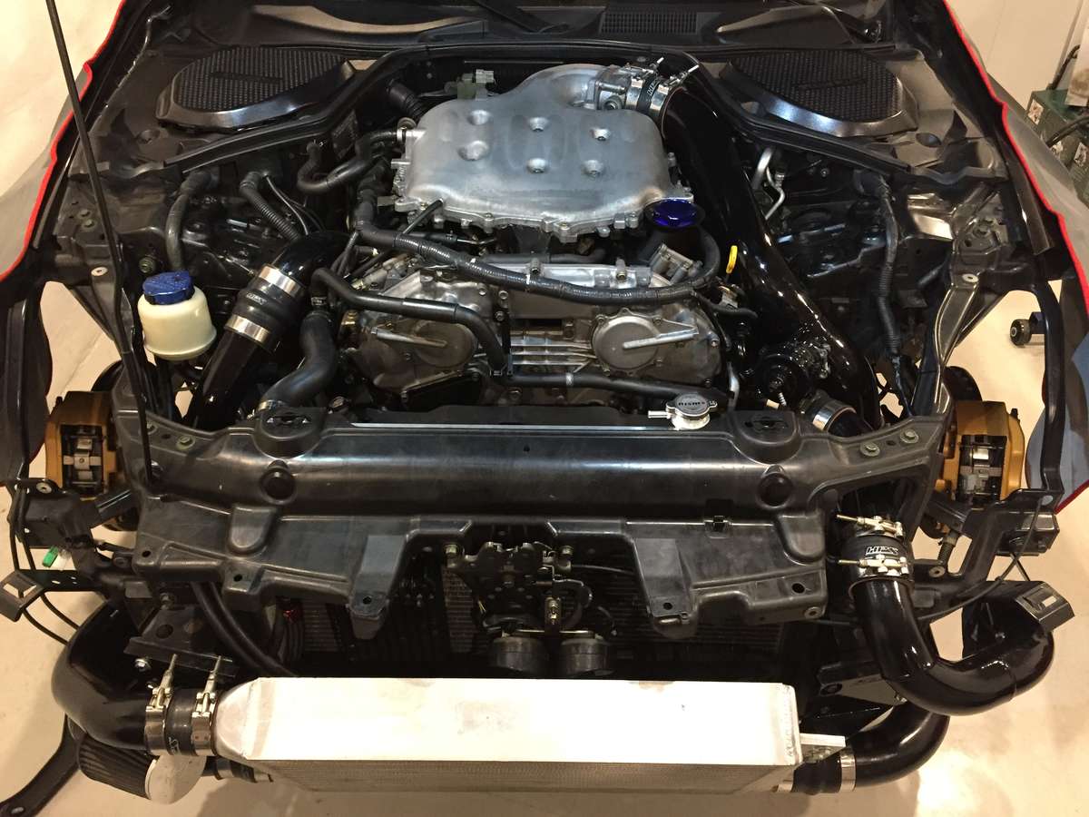

Ortega_9 Posted April 22, 2018 Author Share Posted April 22, 2018 Next is the wideband Dual lambda for tuning and making sure i'm not running lean. i'm not sure if the Stock lambda's are wideband. Anyway, the new ones are some of the Best, and i Can monitor left and right bank each. running all Lines together with original harness and installing with it's own power suply. Also there is three analog outputs for loging software, and for the new ecu. originally i wanted the gauge in the air went in the door, but also wanting to keep the a/c for a hot Day, i opted for the center cubby hole. i'll make something up to Mount it in at some point, but for now, i just want it fired up Quote Link to comment Share on other sites More sharing options...
