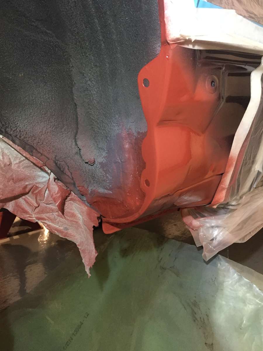

Ortega_9 Posted March 12, 2019 Author Share Posted March 12, 2019 (edited) And can't wait to get this behind me, so just started making templates for the new pieces of metal. I'm planning on going the long Way home, and redo all the original pieces and build up the layers like it was originally. I guess i could just put some metal back on as it will all be covered up. But me beeing me, I want it done right. (Well the Way I Think is the right anyway) Having in mind that i'we never beaten a panel before Edited March 13, 2019 by Ortega_9 Quote Link to comment Share on other sites More sharing options...

Ortega_9 Posted March 13, 2019 Author Share Posted March 13, 2019 (edited) And all done and coatet in zinc. All Lines/holes etc. Line up, and messurements check. Now it's dry time. Tomorrow I'm gonna put sealer on like it came from the factory, then aply a strukture body coat on the inside, then paint. I ****ing hate bodywork! Edited March 13, 2019 by Ortega_9 Quote Link to comment Share on other sites More sharing options...

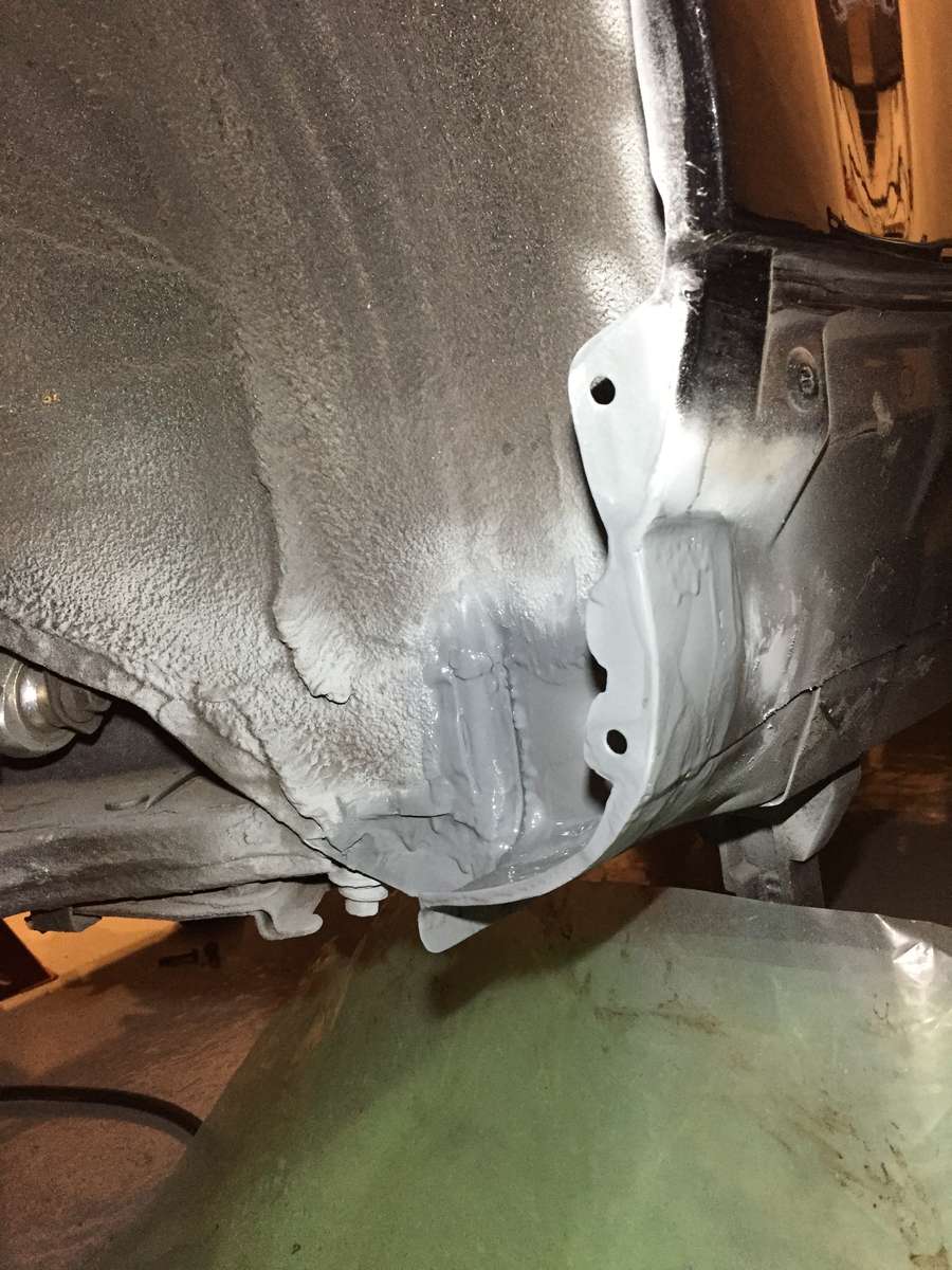

Ortega_9 Posted March 14, 2019 Author Share Posted March 14, 2019 And some more dry time later... The inner arch bottom have been sealed, the outer layer has Got some Bondo layed out, and all of the cavitys in the panel has been pumped full of cavity wax..... now... more dry time.... Quote Link to comment Share on other sites More sharing options...
Ortega_9 Posted March 15, 2019 Author Share Posted March 15, 2019 (edited) And sanded down and masked off and primed... and then... more dry time... Edited March 15, 2019 by Ortega_9 1 Quote Link to comment Share on other sites More sharing options...

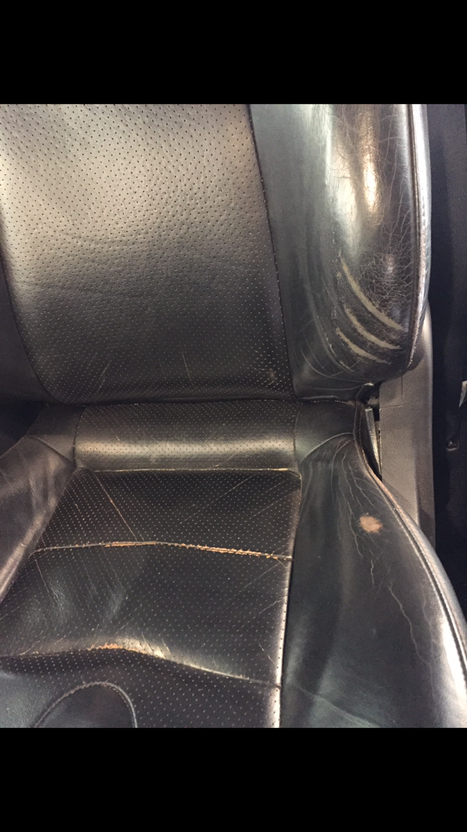

Ortega_9 Posted March 20, 2019 Author Share Posted March 20, 2019 And also on of the things that have been a thorn in the eye ever since I Got the car, has been the worn leather seats. So Got some Black leather filler and Black all-in-one Black dye/restorer from the scratch doctor. i filled in the holes, scufs and worn patches and redyed the whole Seat and gave it some leather conditioner. I'm pretty contend with the outcome myself. Quote Link to comment Share on other sites More sharing options...

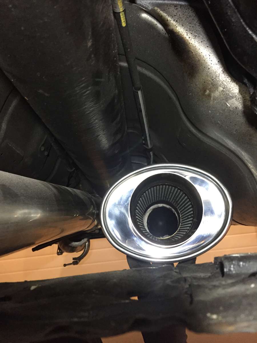

Ortega_9 Posted March 26, 2019 Author Share Posted March 26, 2019 And also theese just Got here. There suppose to be the dogs nuts in removing exhaust drone and resonans. Vibrant ultra quiet resonators in 3" stainless steel. There quite small for the Big things they promise. But at this point I'm willing to try everything to get the drone level down inside the car. I have no idea where to put them, as I haven't Got any room left, so I'll have to chop my exhaust for the third time... nothing like trial and error... 1 Quote Link to comment Share on other sites More sharing options...
Ortega_9 Posted March 26, 2019 Author Share Posted March 26, 2019 Just pulled one side of the exhaust off. It seems I just about have the room to fit the resonators just before the rear axle. That's the last piece of realestate under the car, and if that's not enough I'll have to rethink the entire exhaust.... So counting on you Vibrant!!! Don't let me down. Quote Link to comment Share on other sites More sharing options...

Ortega_9 Posted March 28, 2019 Author Share Posted March 28, 2019 And the weather was playing along, so I started chopping the exhaust and placing the resonators. it actually looks like there is plenty of space for them... so cut some pipe, and tacked up the resonators where they need to be. 1 Quote Link to comment Share on other sites More sharing options...
