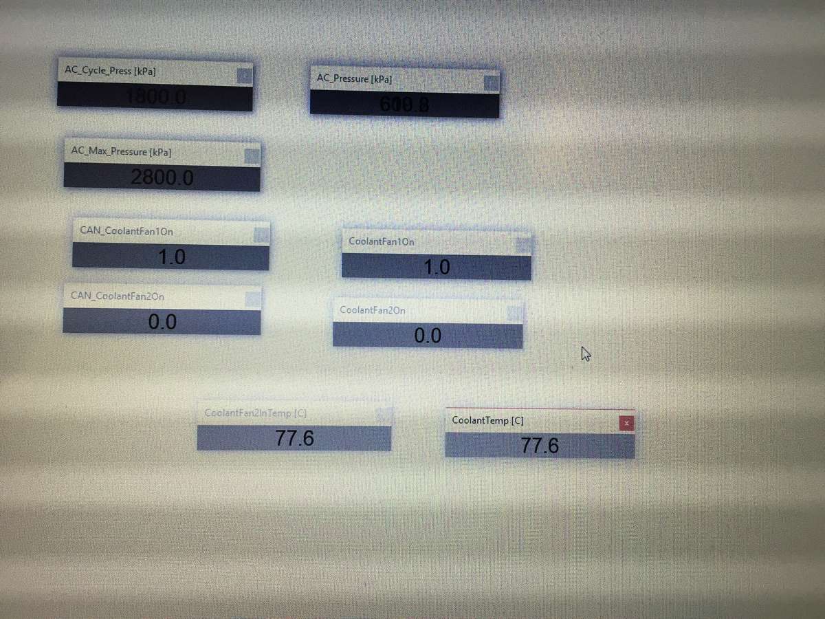

Ortega_9 Posted February 15, 2019 Author Share Posted February 15, 2019 And finally Got my Oil filters and Got the engine fired up again. To get to the bottom of the AC problem, i created a variable table with the analog pressure readings and in/outputs i needed in the infinity tuner software. and right away i could see that my pressure in the AC was a little low, but still it all worked. Just not blowing cold air. when i turn the AC on, the low speed fan starts. So all good there. i regassed my system, and now it's blowing freezing cold air again. and with the small amount of refrigiant i had to recharge with, i Would say that the HUGE amount of gas that came out that morning was down to the system had been heavily overcharged at some point, and then it hit max pressure of 2800kpa and wented to atmosphere from the pump overpressure valve. so thats freaking awesome that it wasn't a leek or something wrong with my ecu setup. also Got my new 17x10 drag wheels for my M/T Slicks. Tyres will show up in about a month time i hope. they only just clear the rear calipers, so thats great. Ings Spoiler and front wing has gone to paint, and I'm beginning to put it all back together for the final few things on the to do list..... getting there 2 Quote Link to comment Share on other sites More sharing options...

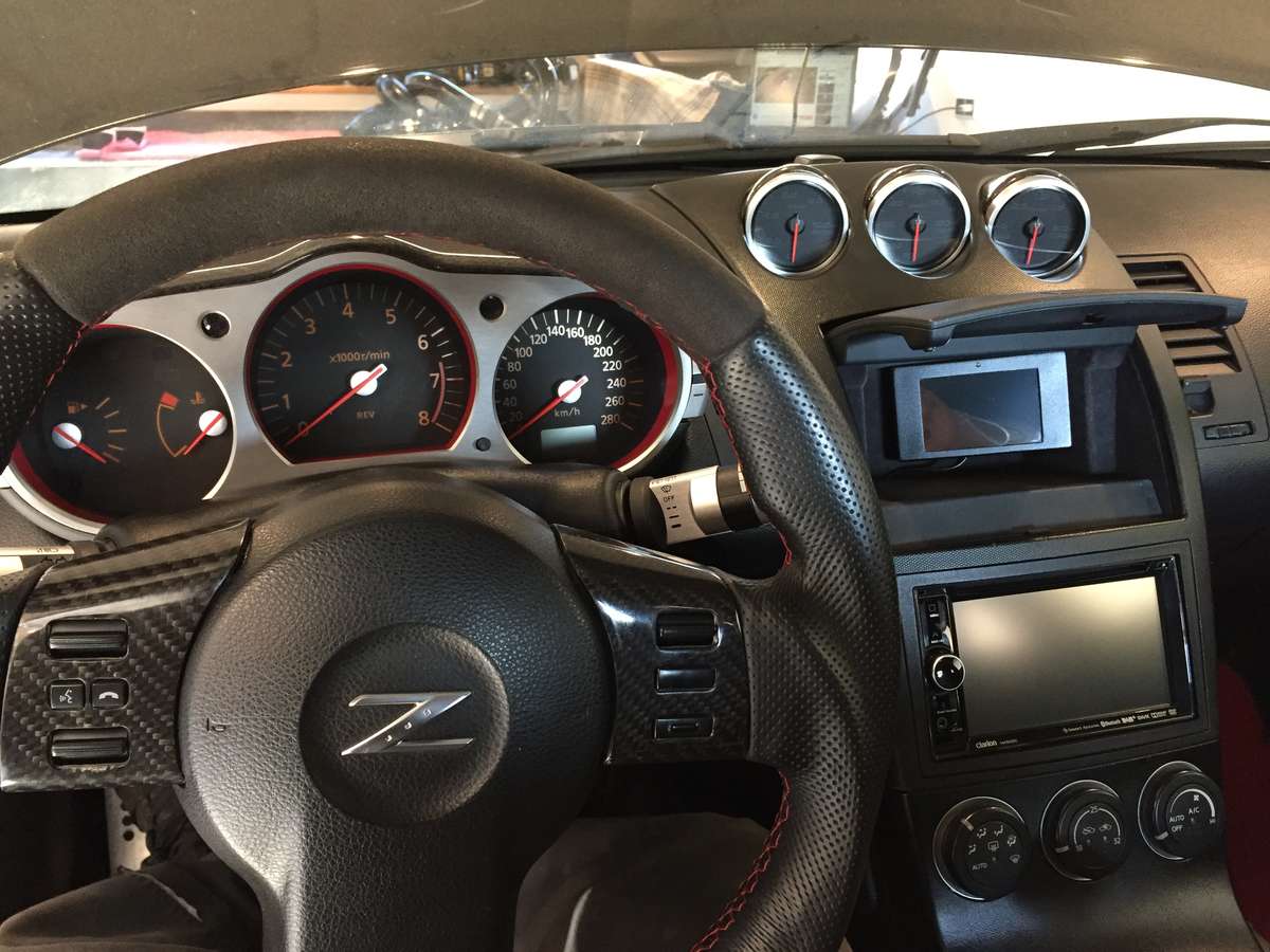

Ortega_9 Posted February 16, 2019 Author Share Posted February 16, 2019 And Interior done. Ended up putting the BTI Can gauge/screen in the cubby hole at en slight angle. that makes the screen visible, and easy to hide. Also finished the install of the new HU. I Think I'll start looking at my new catch tank setup. Does anyone know where i Can get a PCV valve hole an fitting. I've seen them on a few US sites, but maybe from the uk? I Seem to remember it's a m16x1.0 thread (to AN10) Quote Link to comment Share on other sites More sharing options...

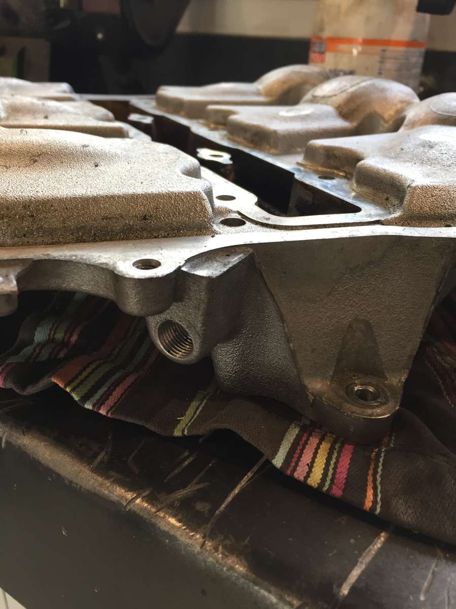

Ortega_9 Posted February 20, 2019 Author Share Posted February 20, 2019 And getting started with the breather system. loosing the Stock vacum evac system i need to do away with the vacum port in the lower intake manifold, and decided to just thread it and put a plug in it. That will also do away with the sludge/Oil fumes and other gunk going back into the engine, and beeing FI the blow by will evac the sump. I'm gonna have to see how, if any, it will smell. Also, the pcv delte AN fitting, catch tank and Lines is on there way from the States. Quote Link to comment Share on other sites More sharing options...
