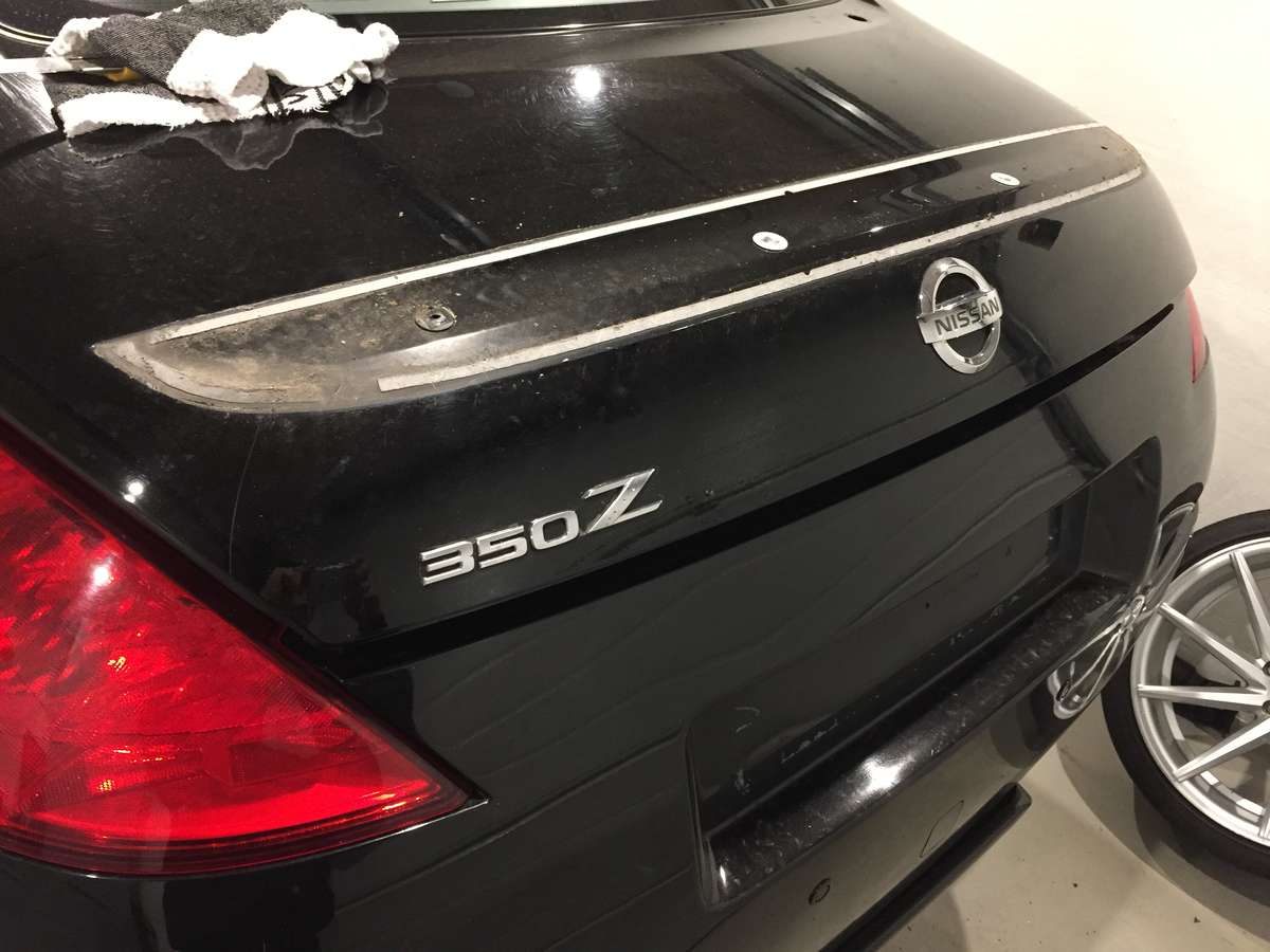

Ortega_9 Posted November 26, 2018 Author Share Posted November 26, 2018 And Stock boot spoiler removed.... preetttyyyy not cool taking a box cutter to the car to cut the 3m tape to remove the spoiler, but really easy! Took about 5min I Can see that the boot have been painted with the spoiler on at one point, but will be painted anyway, now for the emblems. They have been removed before and the super glued back on I Can see.... Quote Link to comment Share on other sites More sharing options...

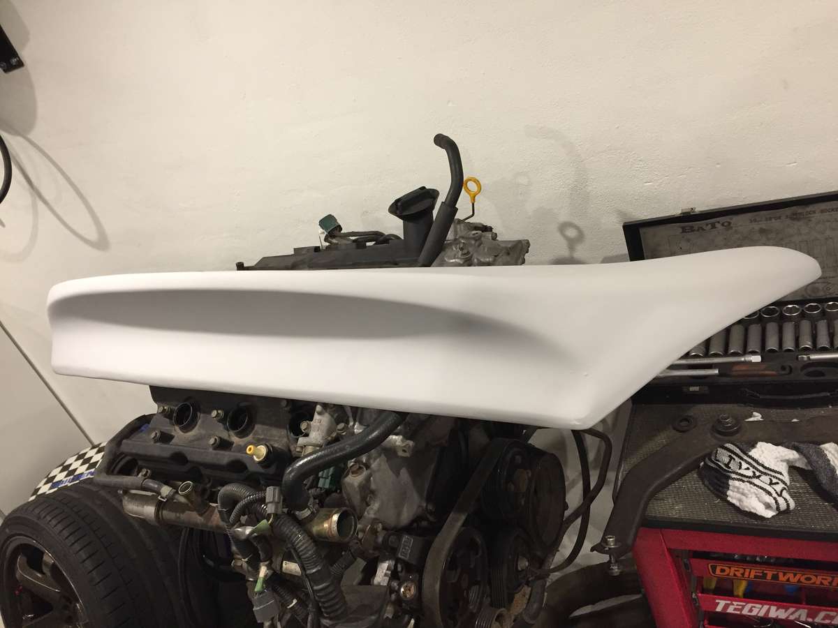

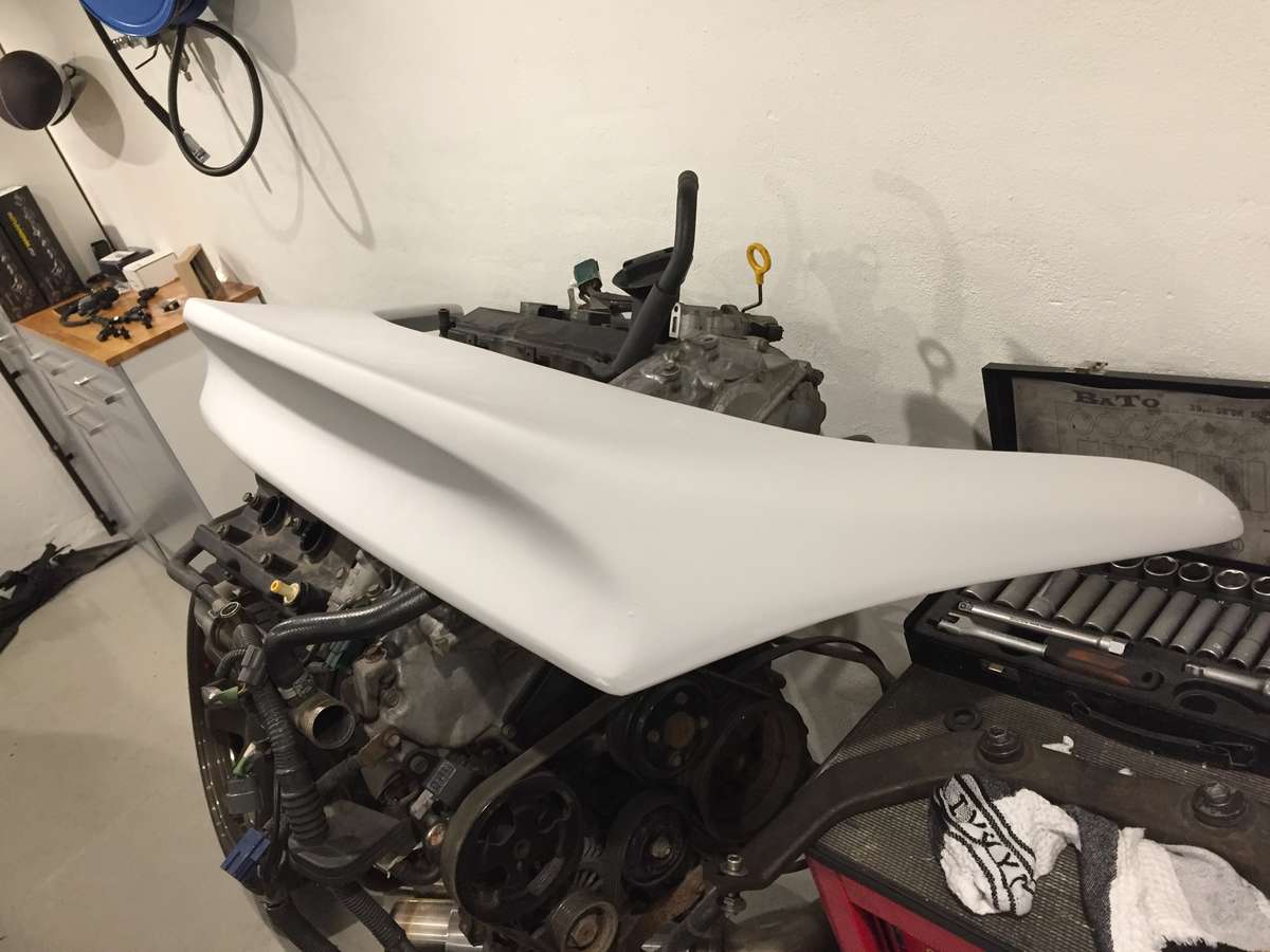

Ortega_9 Posted November 26, 2018 Author Share Posted November 26, 2018 And spoiler placed loosly. it will need some tlc to get a propper 100% flush fit, but will get back to that later when prepping other parts for paint. 1 Quote Link to comment Share on other sites More sharing options...
