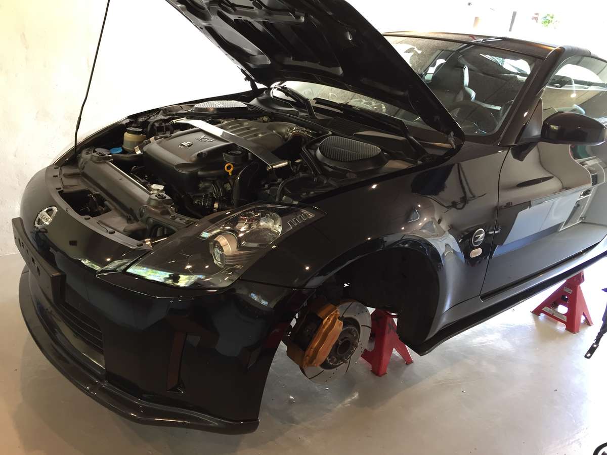

Ortega_9 Posted October 1, 2018 Author Share Posted October 1, 2018 And the car is back in the garage up on jackstands and done for this season. The list of things i want to look into has been made, and the wheels has already come of for the post season inspection. So far it looks like the only "problem" with running twin turbo for the last 4000km has been the lack of Grip and the price of gas. 4 Quote Link to comment Share on other sites More sharing options...

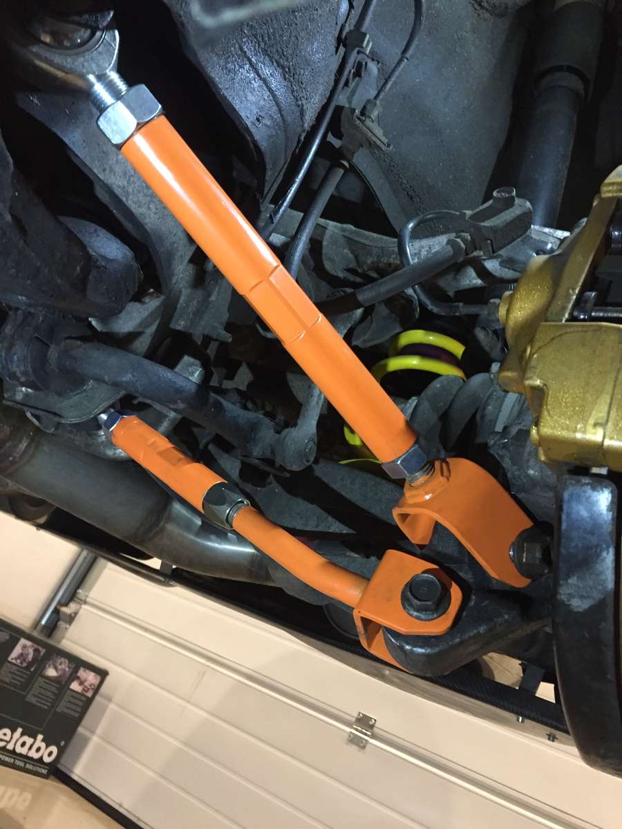

Ortega_9 Posted October 9, 2018 Author Share Posted October 9, 2018 (edited) Right, I'll just go ahead and keep the thread gooing instead of doing separate threads for all the things I'll be waisting my time and money on this winter. just got the new adjustable rear camber and toe arm in and opened. Abit dissapointed, almost all threads are rustet and there is rust in piles in all arms when disasembled. So doing some cleaning and assembling everything with som High temp anti seize paste to be able to crack the bolts apart later. Anyway. Pretty beefy arms as i remember from my good old drift days, so thats a good upgrade for some more power aswell. Old arms off, and using them as a guide lenght-wise, so I'll be able to drive it to the alaingment shop without having to do too much adjusting. Edited October 9, 2018 by Ortega_9 Quote Link to comment Share on other sites More sharing options...
Ortega_9 Posted October 9, 2018 Author Share Posted October 9, 2018 (edited) And done with the adjustable arms in the rear. It will be set to zero camber and the slightest dash of toe in at squat when under load. That will give me all the bite possible. well thats the plan. I always get surprised when i zero out camber on a car about how far out the tyres Stick, so atleast it will go as close to zero as the arches and tyres allow. Edited October 9, 2018 by Ortega_9 1 Quote Link to comment Share on other sites More sharing options...

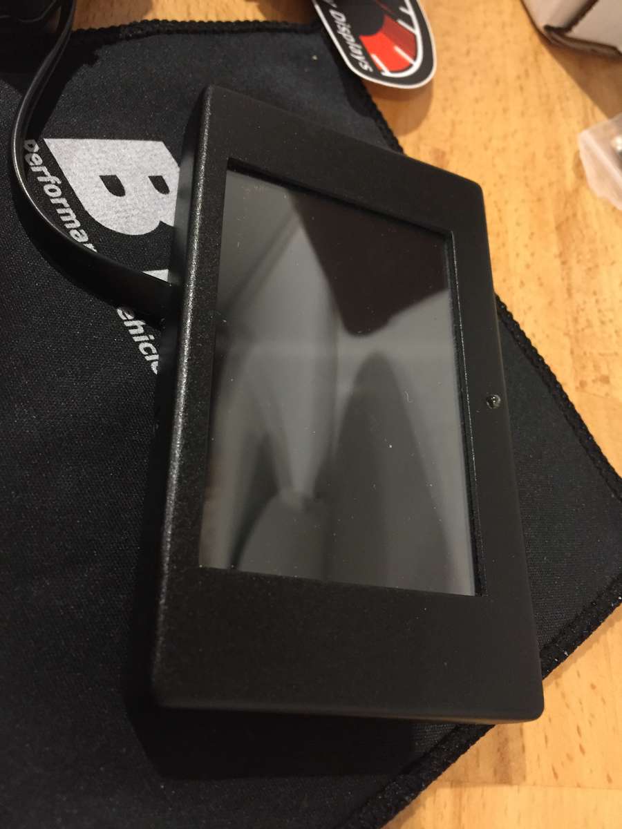

Ortega_9 Posted October 16, 2018 Author Share Posted October 16, 2018 Thanks. And just got word that my BTI gauge display is on it's Way. Seriously looking forward to getting the 3,5" BTI display hooked up to my aem infinity, it's also has can analog outputs to control traction control and boost. And Can show/log all possible data from the infinity. also still waiting for my ID1000's bought from a member here. When they get here, I'll start plumbing the fuel return system Quote Link to comment Share on other sites More sharing options...
Ortega_9 Posted October 18, 2018 Author Share Posted October 18, 2018 And the BTI display just came. awesome piece of kit! you Can see all parameters from the infinity, and you Can set boost and traction control on the 3,5" touch screen. plug and play with the aem net canbus, one connector and you'r done. now i need to work out where to put it. 1 Quote Link to comment Share on other sites More sharing options...

Ortega_9 Posted October 19, 2018 Author Share Posted October 19, 2018 Had some problems with getting the BTI display to initialise and show data. And after a Quick talk and trouble shoot with Brandon that makes them, we found that the aem harnes Can signals are reversed. So switched the Can High and low, and presto! Result. That is the most awesome costumer support i have ever seen! BTI comes HIGHLY recomended from me! With the 8 Pages to scroll trough, there is just so much data! No need for anything Else to show anything. 1 Quote Link to comment Share on other sites More sharing options...
